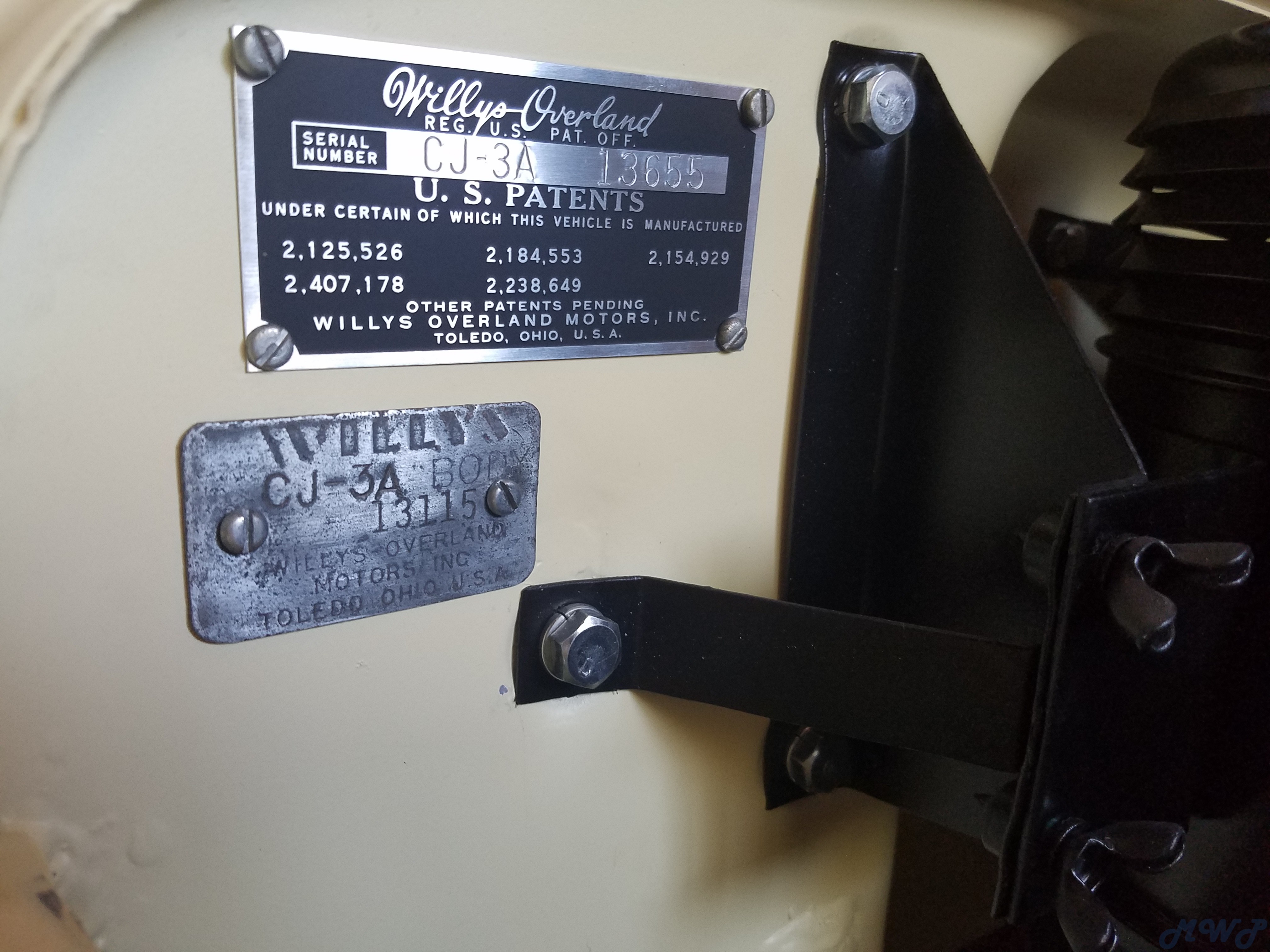

New data plate from dataplates4u.com. Beautiful work by Roberto...

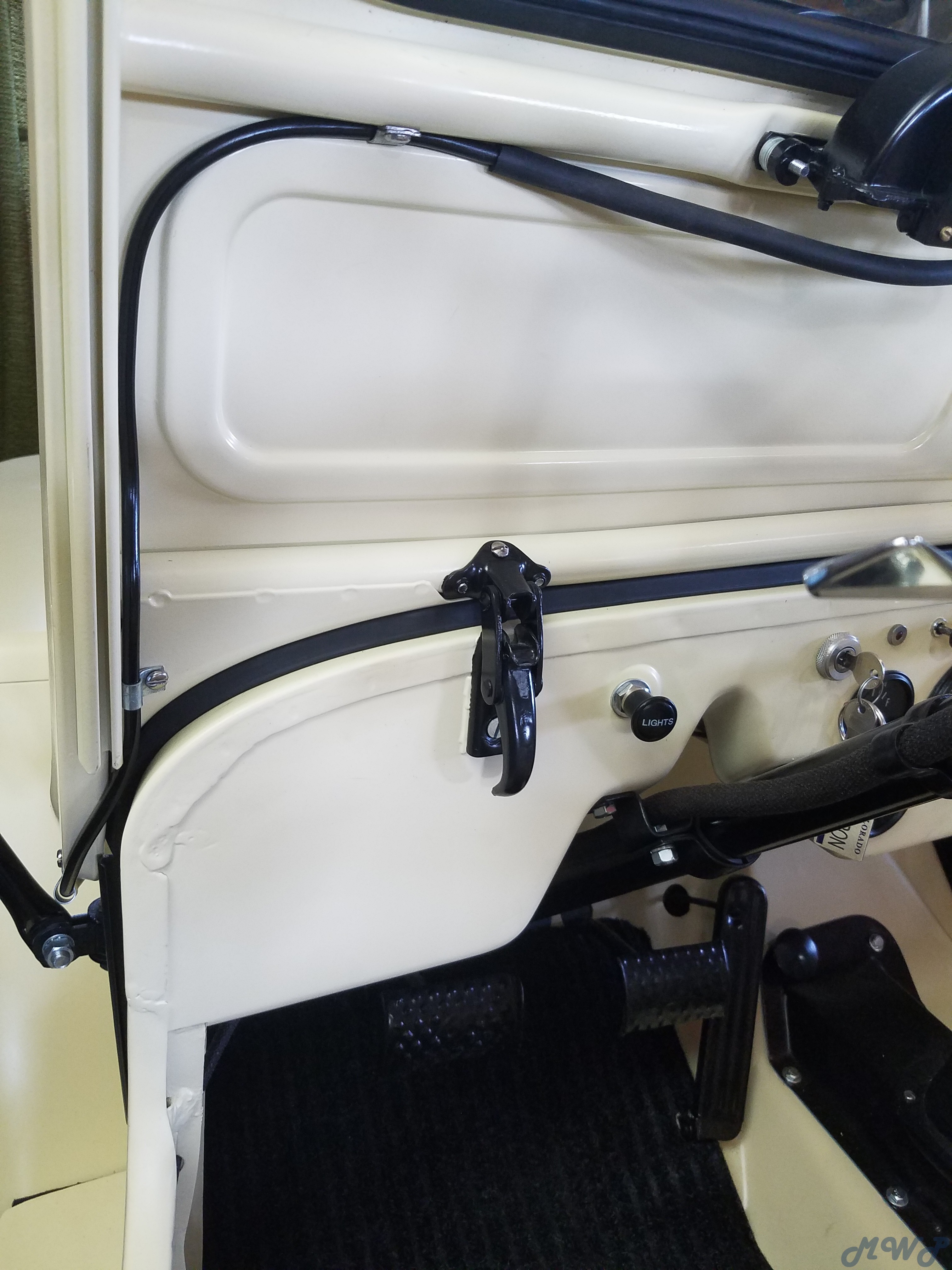

Do you have a picture of the metal (copper?) part of the wiper motor tube on the inside of the windshield frame?
I never really finished that, just ran a rubber tube the full length from engine to wiper motor...

I�ll shoot a photo of that piece tonight.� I made it with brake line.� I shaped it to match the original using one of those tube benders that looks like a spring.� It turned out pretty close to the original look.� I still have to dig in to the wiper motor.� It�s not running.� Dang.

Randy...Here is the photo of the tubing for the vacuum.� Not an overly difficult piece to make...

Thanks Tim....I'll need to get it done now, no more excuses!
Nice to see another picture of the dash though...it's flawless....
