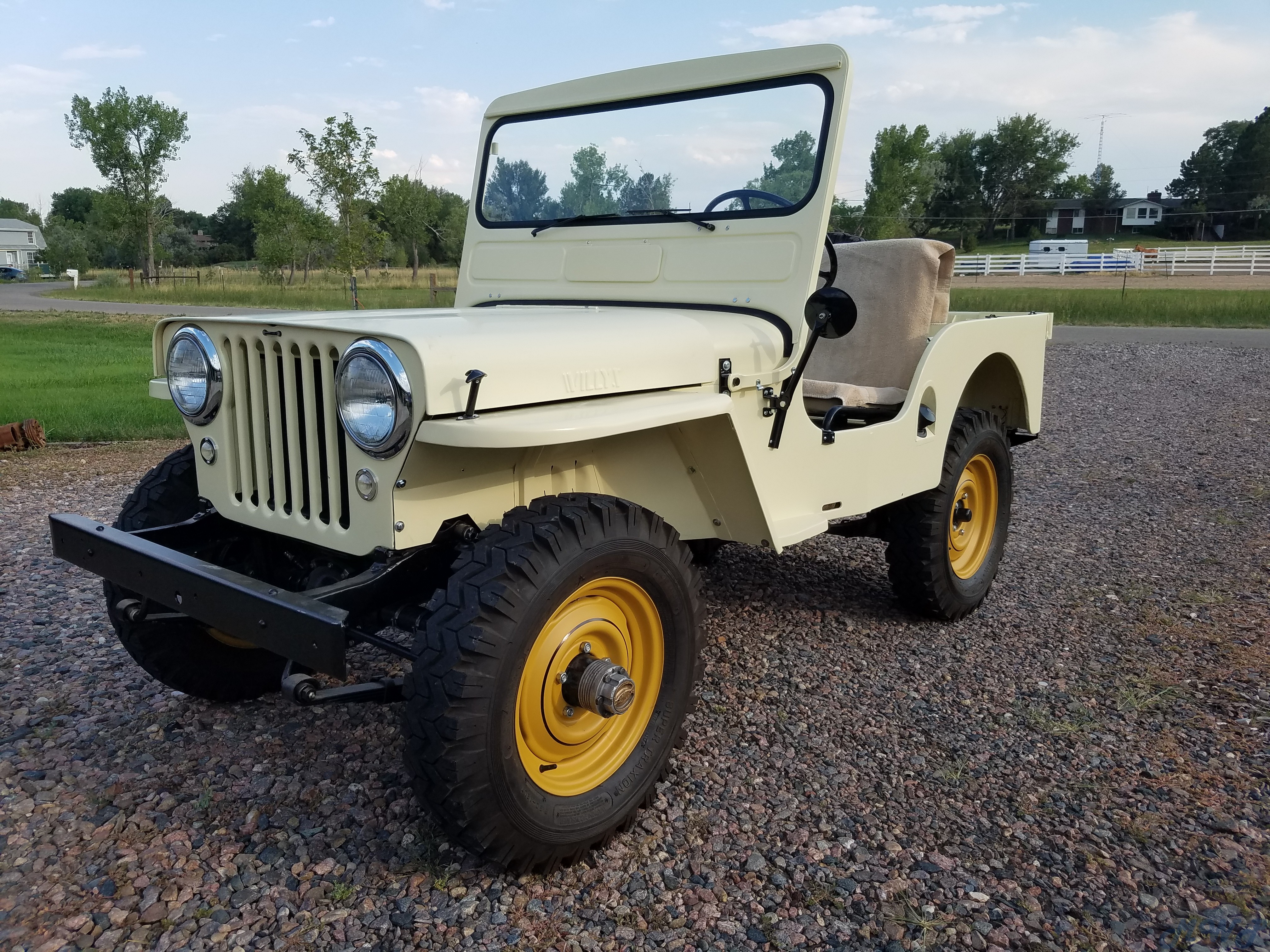

Well, wrapping up the Whitey project.� I finally had some time to install the glass in the windshield.� I don�t know about others, but this chore is a real *rear end kicker for me.� This was a good solid 2-1/2 hours of sweating, cursing, and bleeding, but it�s in.
There are still some minor issues to work out, so it�s not officially a �runner�.� My eBay purchased vacuum wiper motor doesn�t function.� Have to get new glass for the speedometer.� Still need to figure out why the fuel gauge acts like an ammeter. Need to re-spray the clear coat on the hood. (It was too shiny.)� Paint the raised Willys lettering on the hood.� Weather seal on the windshield vent.� Need to reset the �toe-in� now that everything is installed.� Still need to pick out a horn and hook it up.� Rear view mirror.� Hood blocks.� Little stuff mostly.�
Most importantly, (at least to my wife) I still need to get all the �bling-bling� installed. Doggy stickers, bottle openers, etc�
Glamour Shots�
