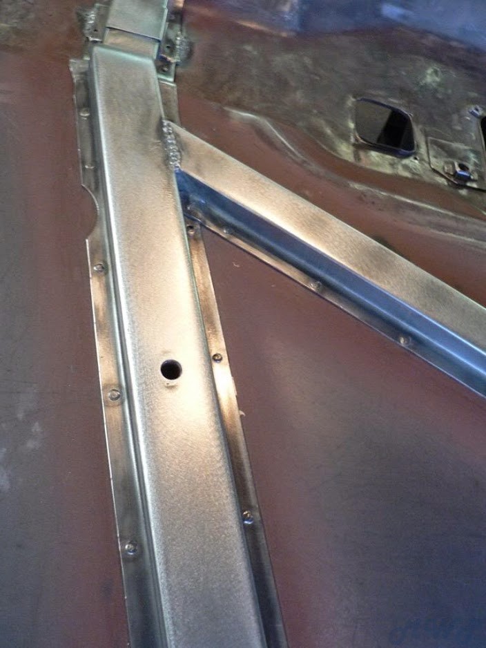

I can use MyWillysPics again!!!  Thanks Pascal.
This is what a plug weld looks like.
I used the cooling technique while welding thin sheet steel that has a tendency to disintegrate and warp if you get it too hot.

Is the plug method a common procedure?
