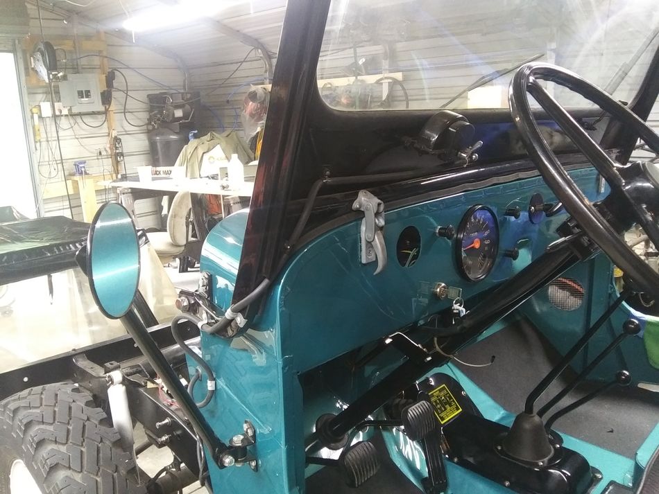

Has anyone ever found a solid fix for the fuel level and water temp gauge issues in the single gauge cluster models? The regulator in the fuel gauge on my jeep was burned out when I got it and previous owner had installed individual aftermarket gauges in holes cut in the dash. I removed the gauges and repaired the holes in the dash and replaced both cluster gauges with the Crown gauges, new sending units and new wiring harness. Fuel gauge moves just a little and temp gauge pegs out on the hot side.

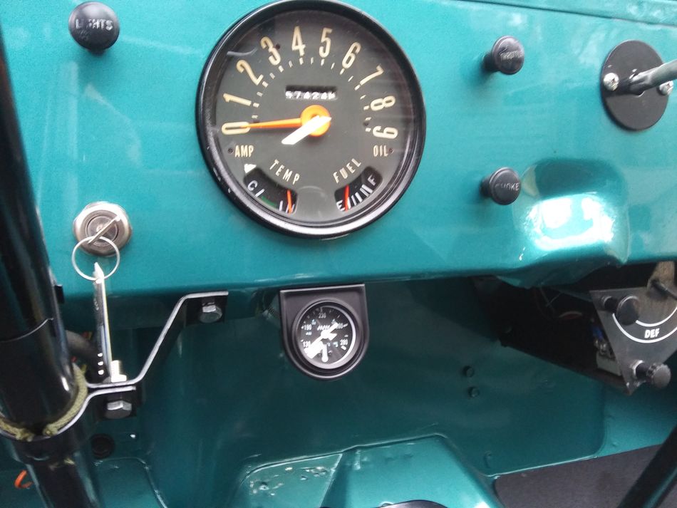

You can see the 1-1/2" diameter water temp gauge that I installed below the dash as a temporary measure, but still hoping to get the gauges in the cluster to function correctly.

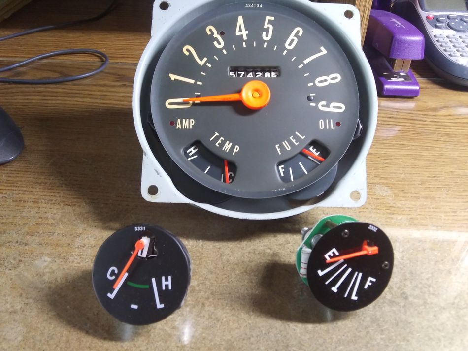

I agree, and it is the same for my 62 DJ3A.  I was referring to the referenced article and some other comments about cluster speedos in various vehicles.  They are not all the same but at first glance would seem so.  It all depends on how "model accurate" you're trying to be, and what is still available.  In the pics provided, you can see the Temp original reads from left to right H-C, while the installed gauge is the opposite.  The installed Fuel gauge has more hash marks on it as well, from the original.
That's the first thing I didn't like about the aftermarket gauges, (besides the fact that they didn't work!) they are both backwards!  I'm not as worried about the fuel gauge, I can always use a stick, but I have to have a water temp gauge. I wish I could find a pure mechanical (capillary tube type) water temp gauge that would fit the cluster. I'm going to make some calls next week to some of the repair/conversion shops and see what they say. Should be interesting.
Do you think the 1-1/2" auxiliary water temp gauge I mounted below the dash distracts from the gauge cluster? I'm not happy with it but it looks better that the 2" gauges and I guess that's the way it will be for now.

Funny you should ask about the hanging guage.  I was thinking the former cane handle e-brake locaation would make an interesting location for it and not hanging down by your legs.
Re: Fuel and Water Temp gauge issues....again.
« Reply #11 on: November 28, 2020, 07:59:59 PM »
I don't think I want to cut any new holes in the dash! It took a while to repair the two 2" gauge holes that the previous owner cut. I'm trying to keep this one as stock as possible.

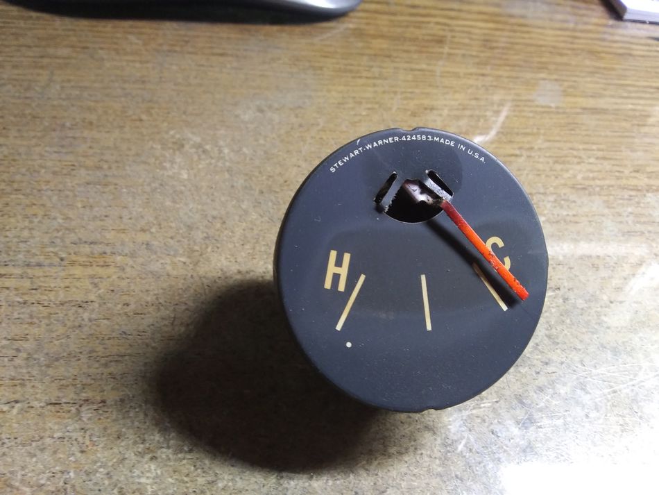

Well, I found a New Old Stock Stewart-Warner 424583 water temp gauge. I'm going to use an IC7806 to drop the voltage to 6 volts and feed the gauge directly. We shall see!

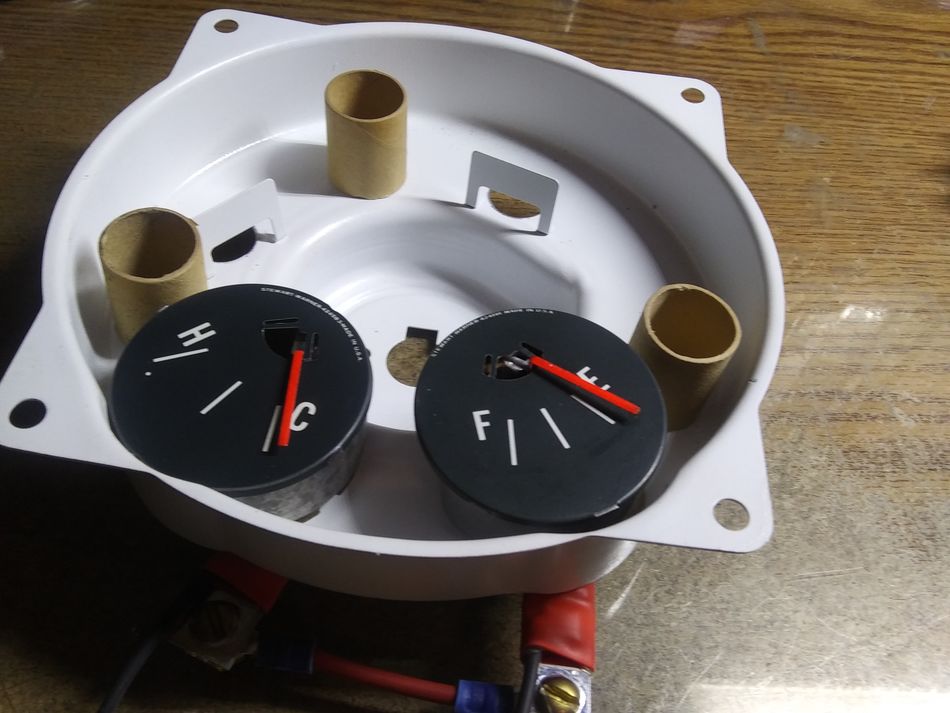

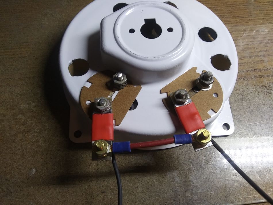

In my quest to have operating gauges in my 1964 CJ3B, I think I have found an answer. I found a vendor on e-bay who has NOS Stewart-Warner Temperature gauges. I also found a new fuel gauge at Walck's. This gauge fits a 6 volt Jeep truck/wagon and does not have the internal mechanical voltage regulator. The gauge face is identical to the CJ3B gauge, but the two studs on the back are vertical instead of horizontal, so the case will need some work.
I bought two 12-to-6 volt solid state voltage regulators that are specifically designed to be used on older gauges.
So at this point, with everything wired up on the bench and connected to a battery, the gauges and sending units seem to be working. The fuel sender seems to be a bit sticky, so I may order another one.
Now I need to pull the gauge cluster out of the jeep and swap the speedometer head, glass and bezel into my modified housing and see if it will work. At best, I'll have a working temperature and fuel gauge. At worst, I will have the incorrect Crown gauges out of my cluster.

While the battery was out, I decided to tackle the gauges again. I removed the cluster and began swapping out the incorrect aftermarket gauges. So far, so good!
