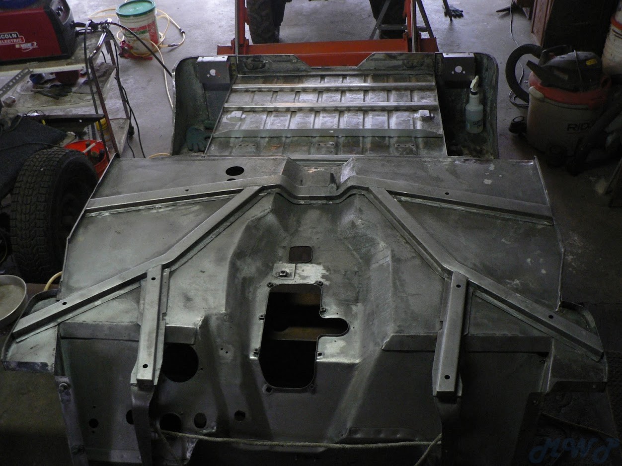

There were glaring problems with the floors and the hat channels.  I just didn't think I was going to be able to make the thing look nice without addressing them.  I couldn't figure out how to fix them without removing the tub.  I thought about it for a while, then came up with this...
After pulling the tub, I got a good look at the damage.  I purchased the front floor pans and hat channel kits from one of the vendors and started hacking away at them...
On to the cargo area.
The metal was pretty pitted and sagged horribly.  I couldn't afford a new cargo floor, so I removed the damaged cargo hat channels, made a dolly that fit the ribs and started 'working' them back in to shape.  It had clearly lost some strength, so I installed extra hat channels and supports on the underside.  It turned out nice.   This took hours and hours of effort.  It saved me some cash and was a good learning experience.

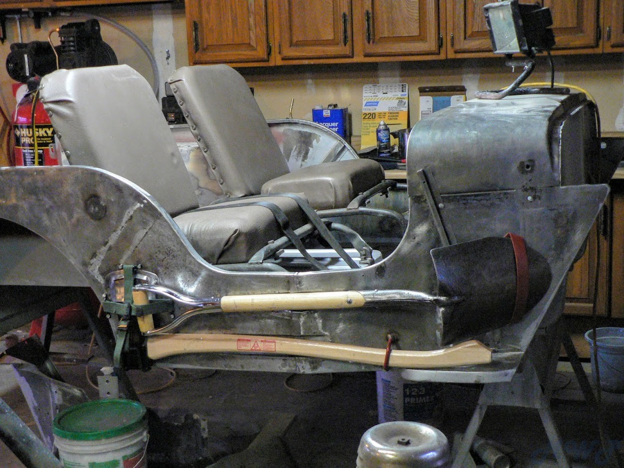

I wanted to add tool indents.  With the help of a drawing created by Jpet (Jeff Petrovich) at the 2A Page, I started to hack away at the tub.  I made the indents first, then cut the matching dimensions from the side of my tub.  I was fighting the natural tendency of sheet metal to warp when it's welded.   I got it all back together but not without a fight.  My mistake was cutting both slots out of the tub before welding the indents in place.
If you ever want try this, I recommend you cut just one of the indent slots at a time.
This is my wife Rachel.  She was showing me some tricks.
I wasn't confident enough in my skills to do this stuff, so I got into the good habit of test fitting everything I modified.  You'll notice the seats are also in place.  These are 2A seats that came with this 3A.  Many of you know the complication that creates.  More on that later.

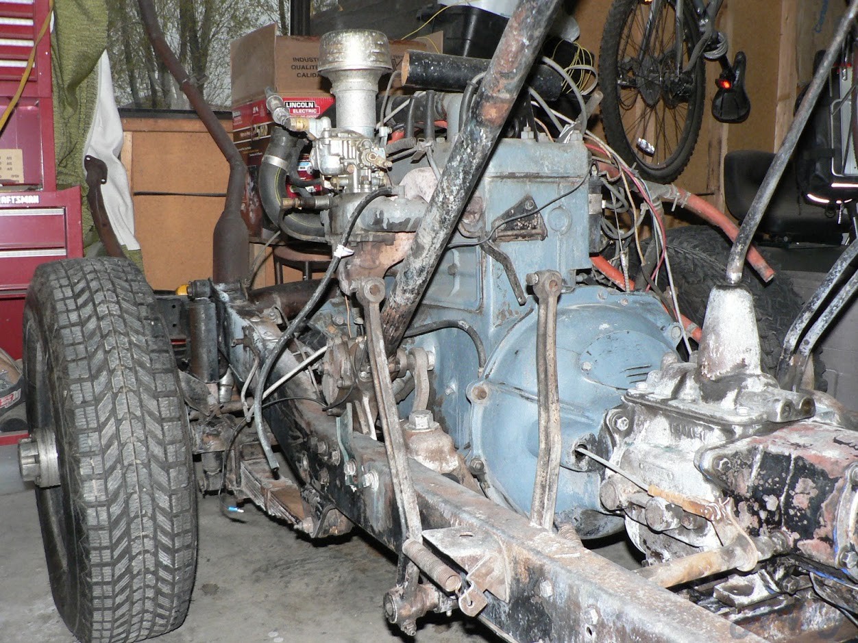

Pulling the tub exposed just how filthy the frame and drivetrain were. I had that "Lipstick on a Pig"/ "Uh-Oh, better get Maco" paint job moment.  Just cleaning up the top side wasn't going work for me...
Initially I was terrified to take this apart and then not being able to put it back together.  I started to clean and scrub away the crud...
Not too far into this effort, I realized I would never be able to get it clean enough to do a simple paint job without pulling off some of the pieces.  I pulled a few, then a few more. I bagged and marked the nuts, bolts and screws.    I took lots of pictures along the way, in hope that I could refer to them when the time came to put it back together.
I didn't work in any obvious way... because nothing was obvious to me.  This was all new.  It was some kind of nightmare I couldn't wake up from.
I eventually pushed passed my fears and started getting stuff done.

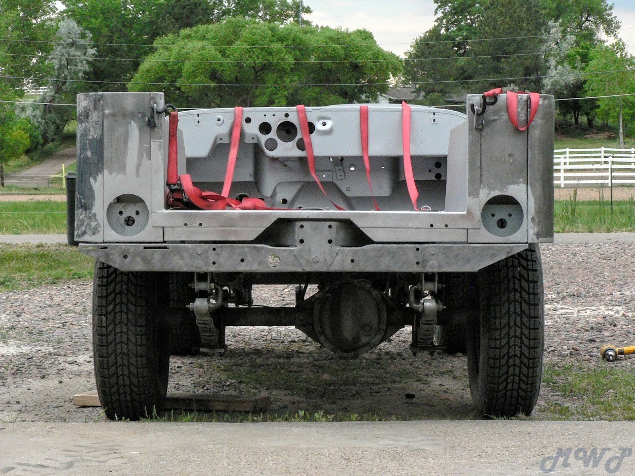

I bought a cheap sand blaster from Harbor Freight that worked surprisingly well removing rust on lots of parts, the frame and axles.  After sandblasting and some welding repairs on the frame, I  set the tub, grille, fenders and axles one last time before painting.
I decided to use the MasterSeries Silver anti-rust primer as my base.  It has several desirable qualities.  After this layer, I primed the parts with Red Oxide, then finally Gilespie's 23070 Semi-Gloss OD paint.
I continued to clean and paint the bits and pieces...
Time to reassemble the chassis...

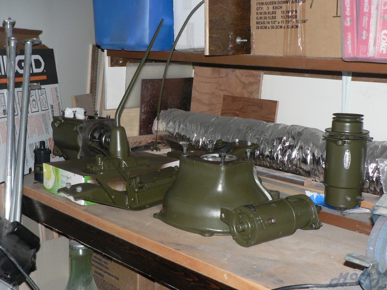

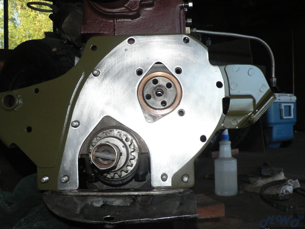

There was one engine modification I needed to address before the chassis could be put back together.  This engine was equipped with this special part that allowed the 2A/MB/G.P.W.  style engine to be installed on a 3A frame.
I didn't want to re-use it, so I decided to change the front engine plate to a 3A style.  There is no option for a 3A style front plate that is compatible with a chain drive motor.  This created a small problem...
I simply welded the gap shut on this 3A plate.  There were other minor changes required to the plate, but nothing a grinder couldn't solve.
