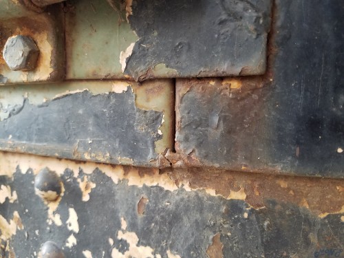

You might try this.  I picked up a rubber ring at Ace Hardware and added it to my cap. My original cap gasket was a bit tired so it leaked. The extra rubber ring helped quite a bit.  It only dribbles a bit on an incline with the tank overfilled.
You can see the edge of the ring in this photo.  The diameter of the ring was a bit larger than the cap.  The cap is a little more difficult to get back on, but I can live with that.  What I couldn't live with was the gasoline screwing up my paint.
