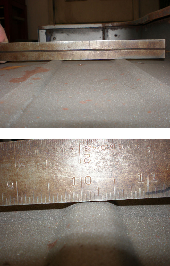

I've been working on a project that involves replacement sheet metal for the wheelhouse tops and patch panels for the floor on my jeeps.. Here's something I never realized...
Look how assymetrical the ribs are...almost like they wanted them sharper towards the right side of the jeep for some reason.
You guys that have original floors still, if you have time, can you check out your wheelhouse and floor ribs to see if they are the same as mine? Those pics are a DJ3A, my 3A has been modified a BUNCH and I do not think the ribs are even there any  more. )
EDIT: Just checked the Pintojeep, my only 3A (that I know of ) and the long rib goes all the way to the front edge, just like the 2A ones do. I actually do have the wheelhouse top ribs but in lousy shape. I'd b einterested in seeing what the rest of the 3A population has.

Bob W is this yet another data point we need to date a 3A tub with? You don't happen to know the month they changed the ribs?
Seems like sometime in 1951?
If you guys have a profile gage to check with I'd appreciate knowing if the floor ribs are the same as the wheelhouse ribs. From what I have seen tentatively they are the same as the passenger side wheelhouse. On the drivers side wheelhouse they are slanted the opposite direction.  The spacing is different.

Thanks Ryan. It looks like your 3A has the later rib that ends about 1/2" from the front.

My 51 3A Ser # 451 GBI 27079 (for those that can tell when it was made)  Has the same ribs on the wheel housings ending about 1/2 inch from the end.  The ribs are also like in your picture in that the edges are steeper on the side to the outside of the body and more gradual to the inside. The floor looks to be same hight ribs as the wheel housings ( smidge over 1/4 inch) but the sides of the ribs are the same.

The long rib on 451-GB1 24316 is a 1/2" back from the edge. Looks like the change was between 24316 and 52xxx. Anyone else have a 1951 CJ-3A to help document this change point?

Looks like the length of the long wheelhouse rib changed between 451-GB1 152xx and 451-GB1 24316. That narrows it down to the early 1951 model year.
