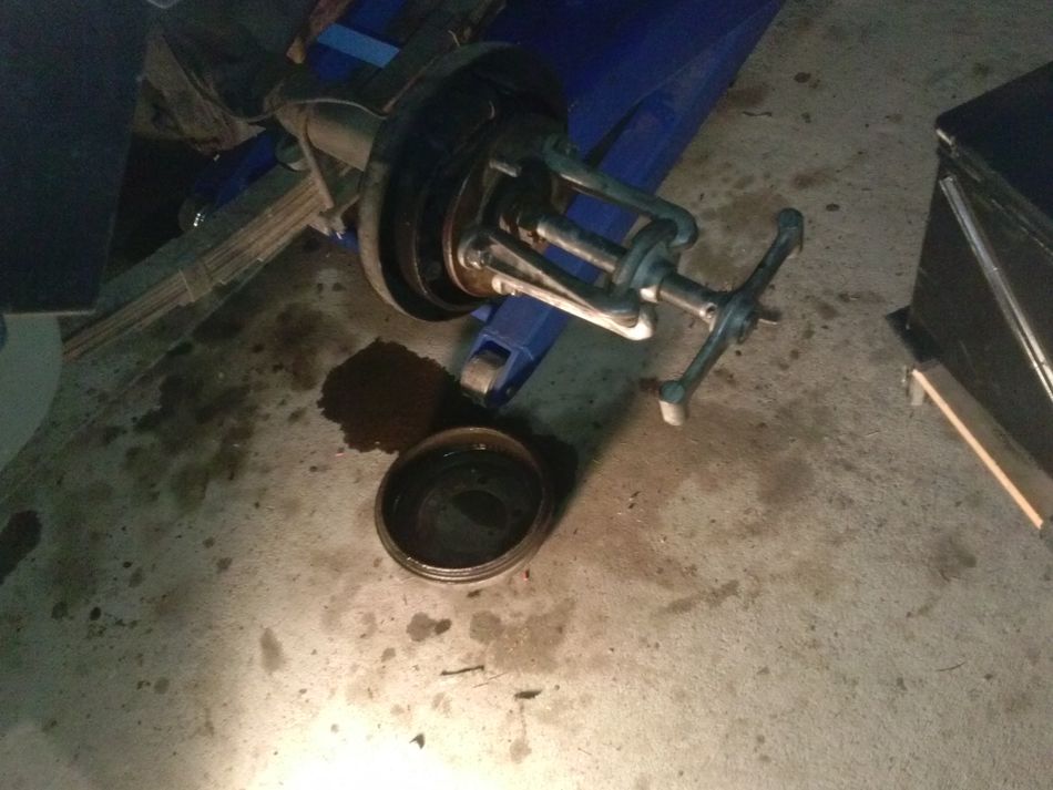

Hub puller. Found on e-bay for $25.  This is one of the old OTC tools, not the cheap China knockoffs!

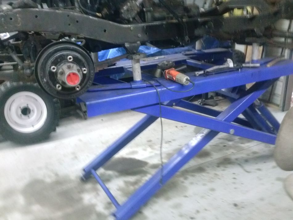

I'll also include the HF scissor lift that the jeep is sitting on, money well spent.
