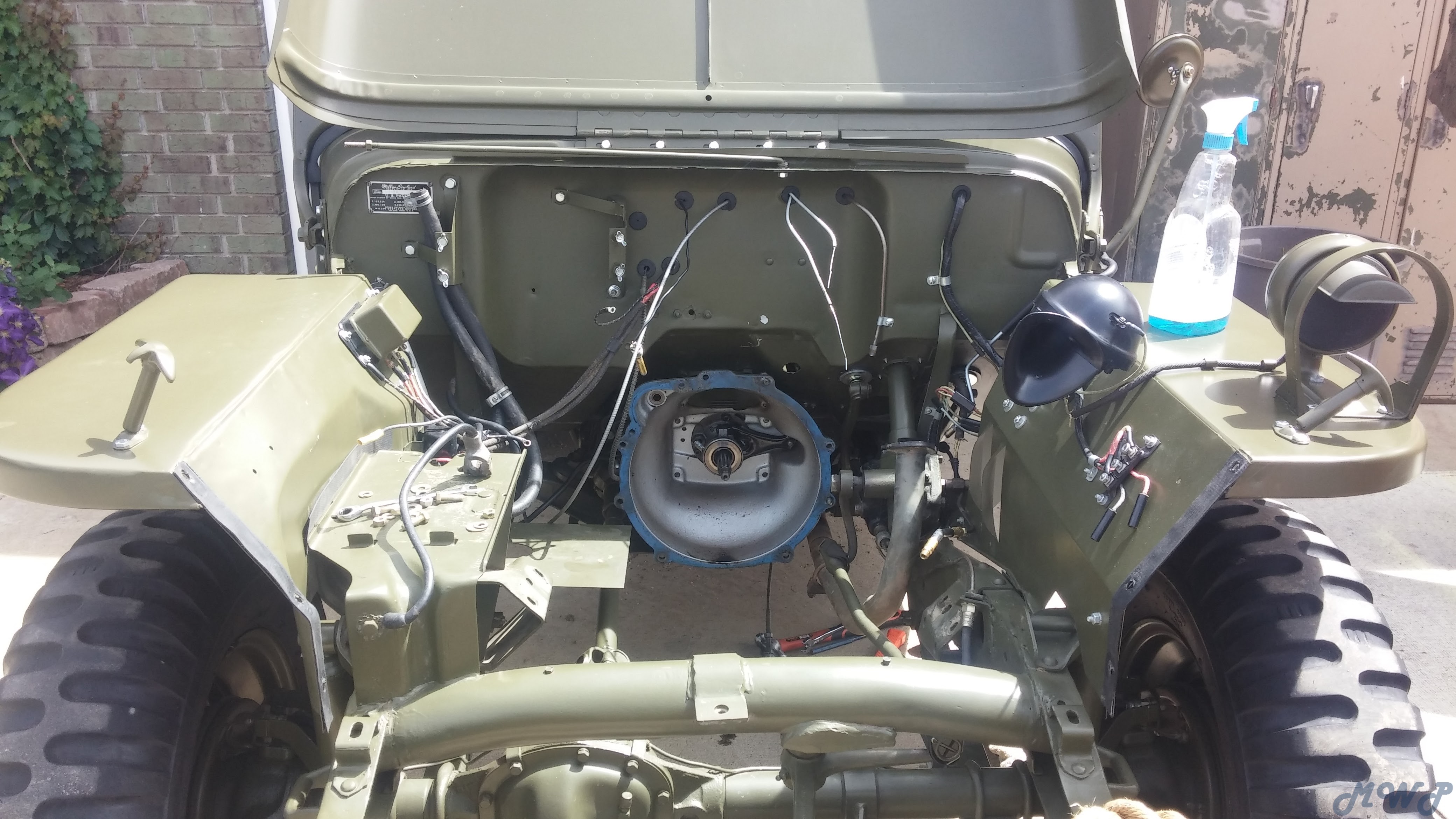

Also attached is a picture of the engine hung by the sling the rental place had to go with the hoist. Some slings are adjustable and those are pretty nice.
Some like to use straps...
Make sure the lift has enough vertical clearance...if you do it inside the top of the lift may contact something like the retracted garage door before the pan clears the grill....outside of course no problem.

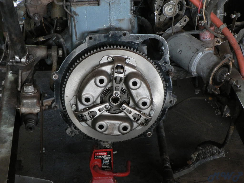

Behind the clutch plate are the six or eight� (?) bolts holding the flywheel in place....I'll bet Tim has a picture....I don't remember if they are safety wired or have lock tabs.....
I would set the engine on TDC before removing the flywheel, and mark the fly wheel's relative location as I think it can be installed 180� off, and then you won't be able to see the timing marks through the little hole when it's all assembled.
This is not a great picture but you can see the rear of the crank and the flange that the flywheel bolts to...
