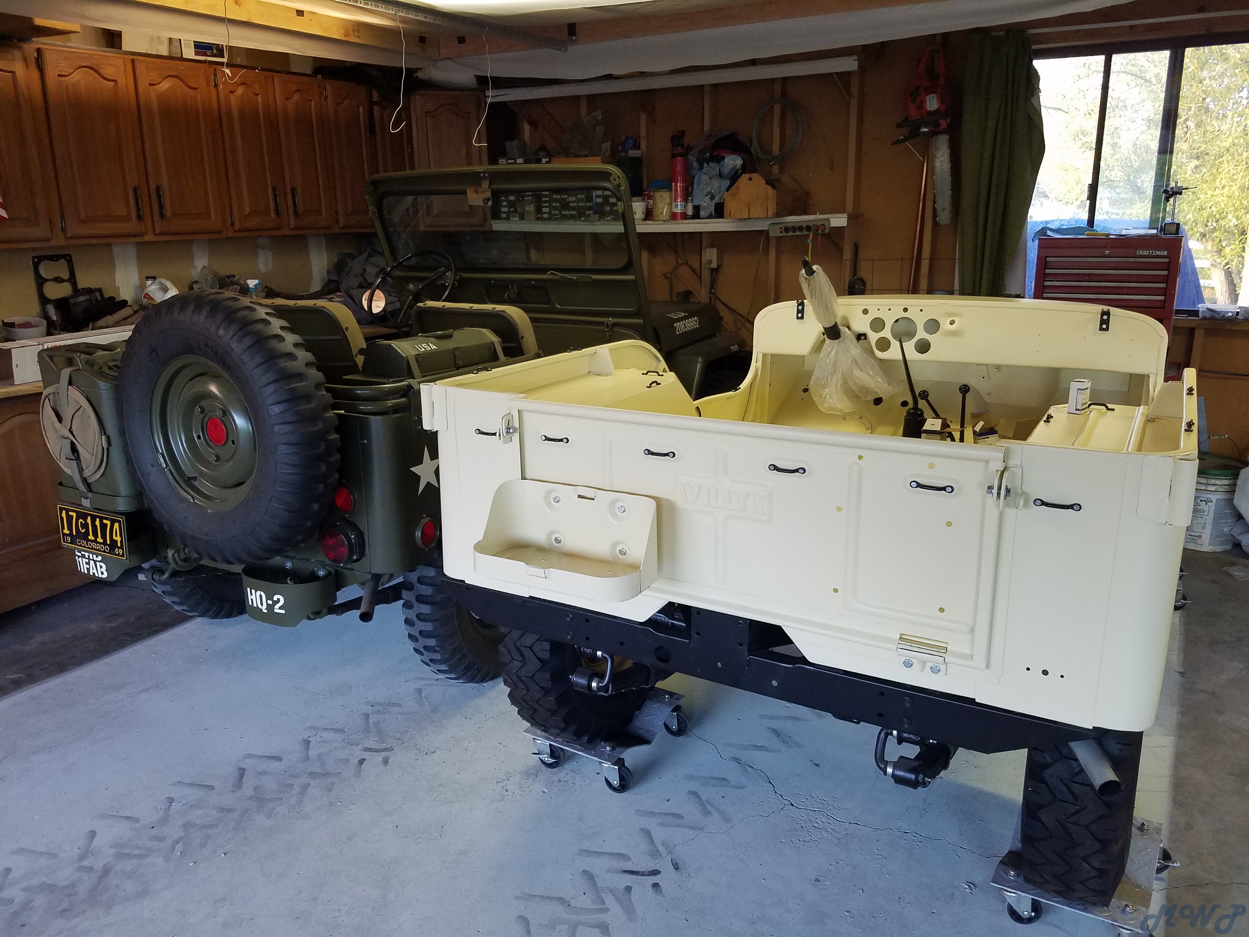

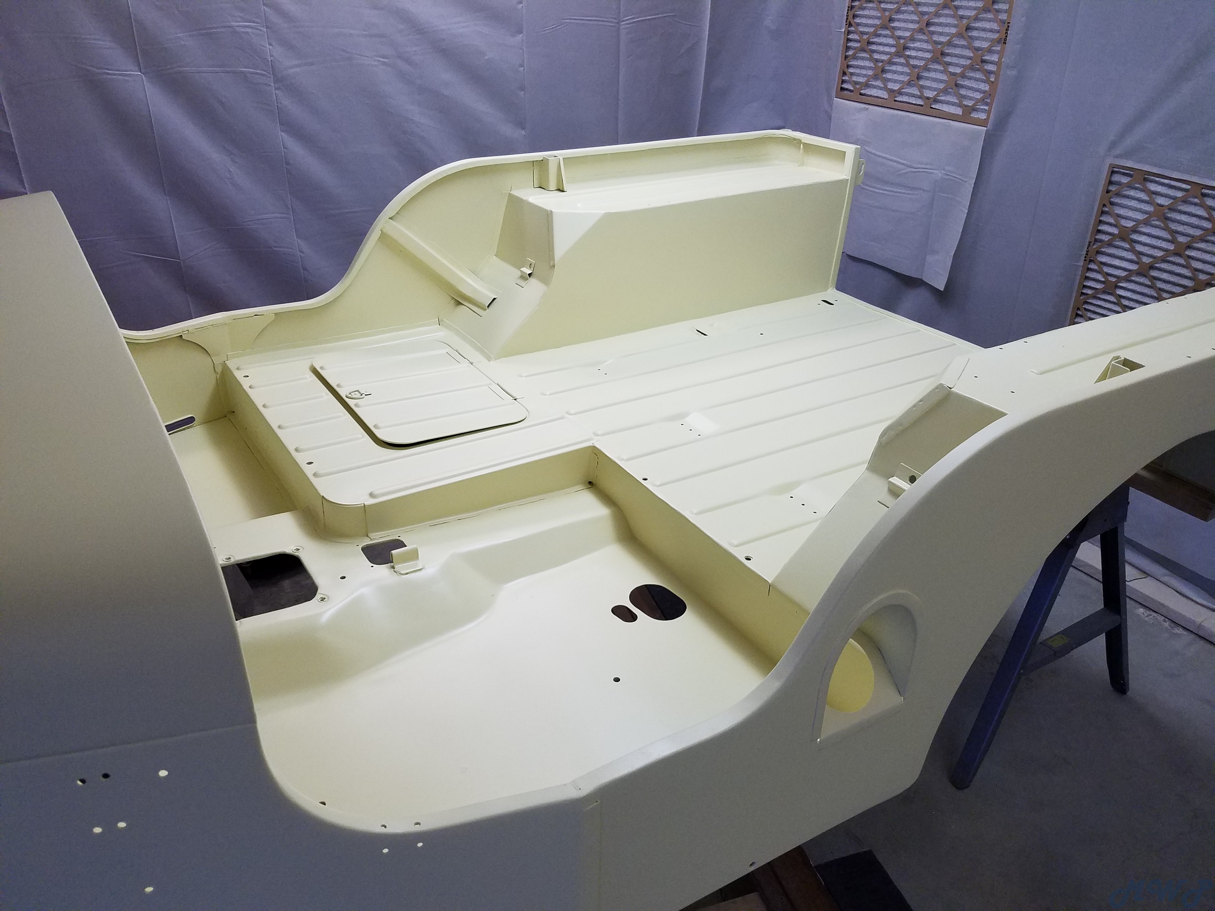

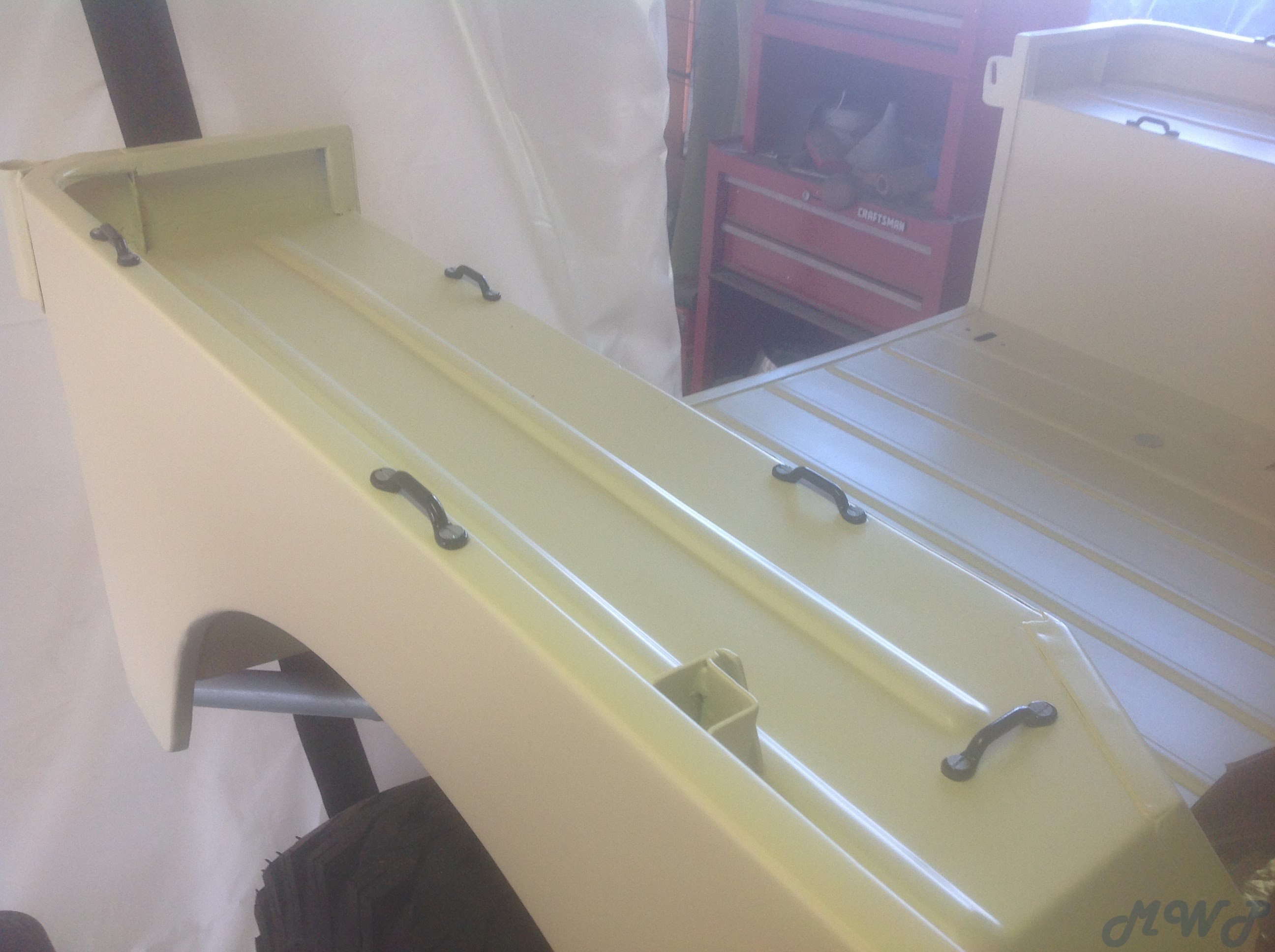

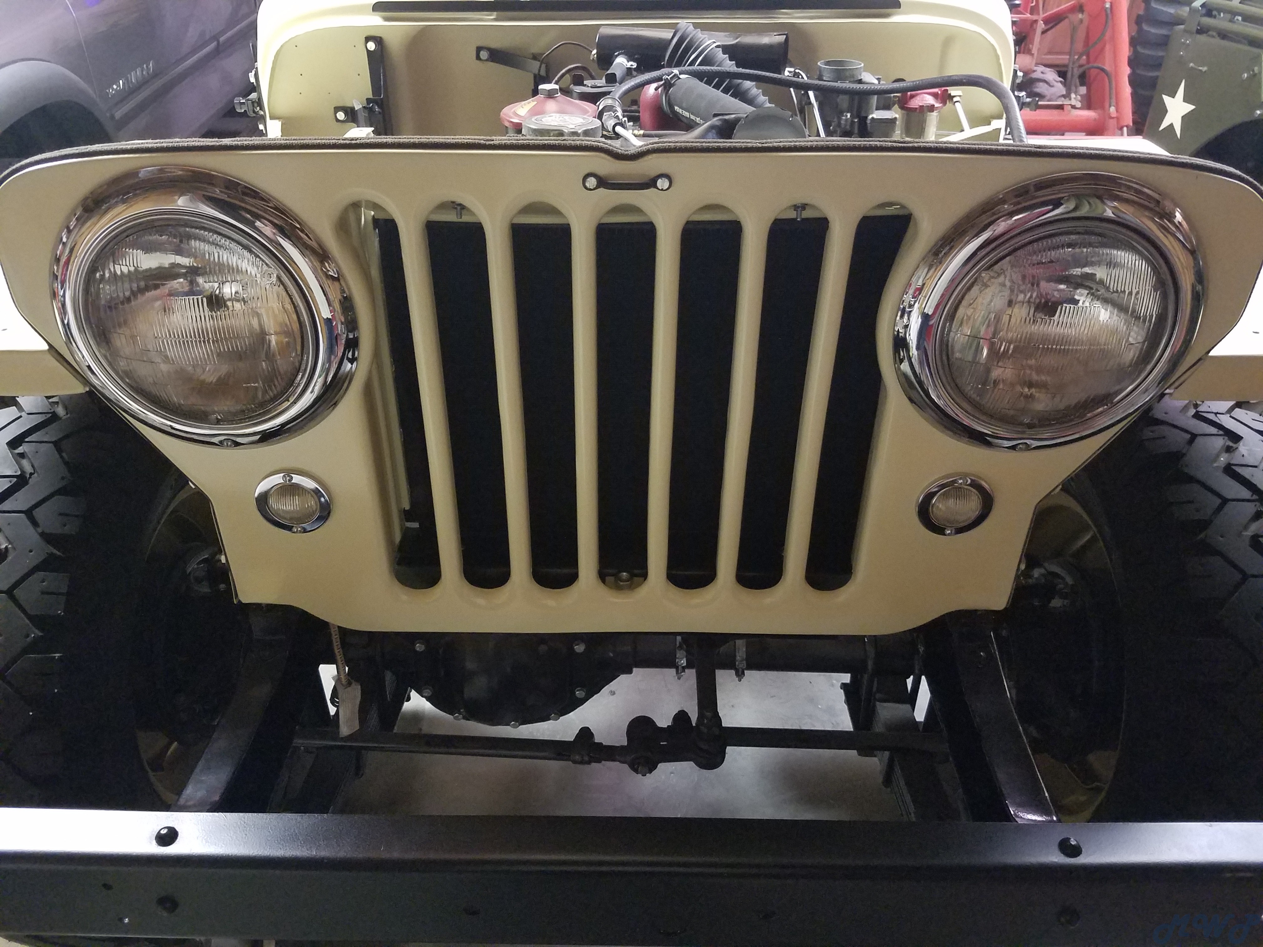

« Reply #5 on: September 24, 2018, 09:09:35 PM »
One on the grille...
Six along the back side...
Five on each wheel well area.  There are dimples on original tubs that dictate locations.  The one loop at the front is in line with the three in the cargo area...
The three in the recesses in the cargo area are fairly self explanatory...
