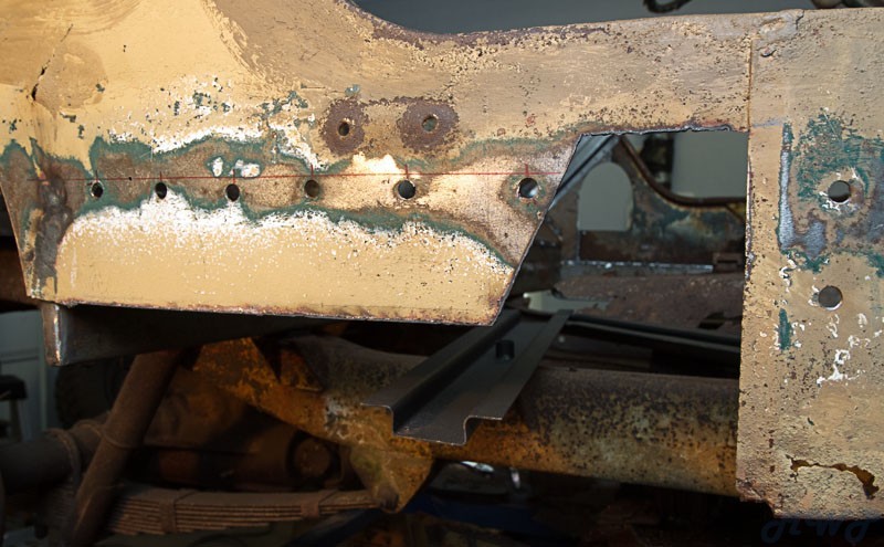

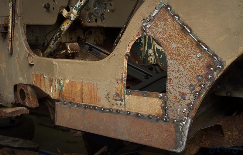

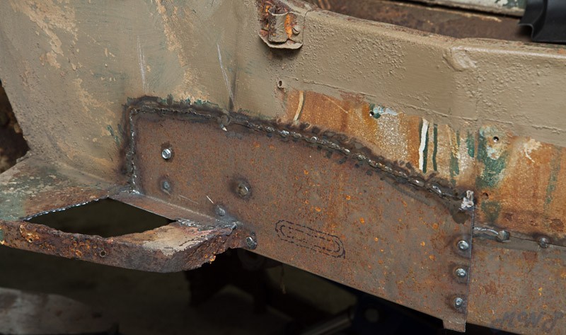

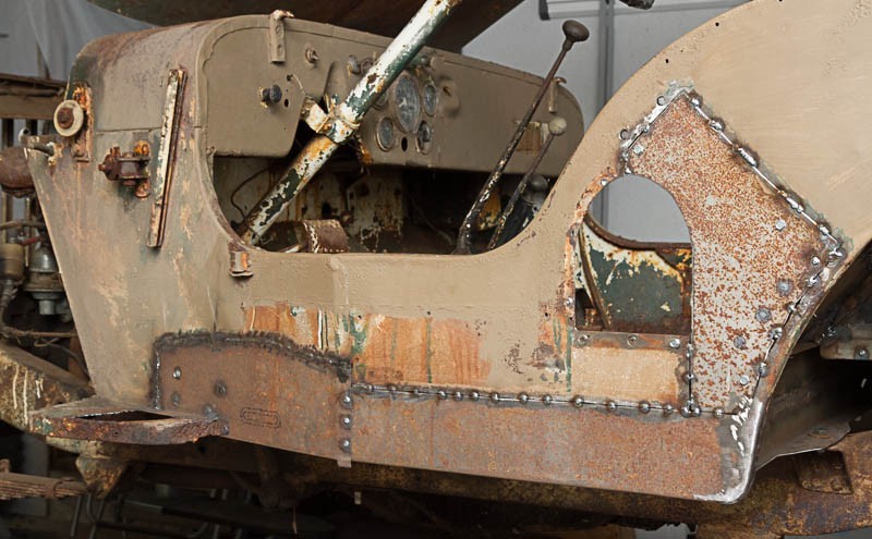

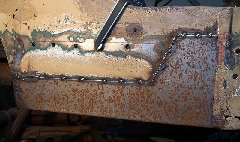

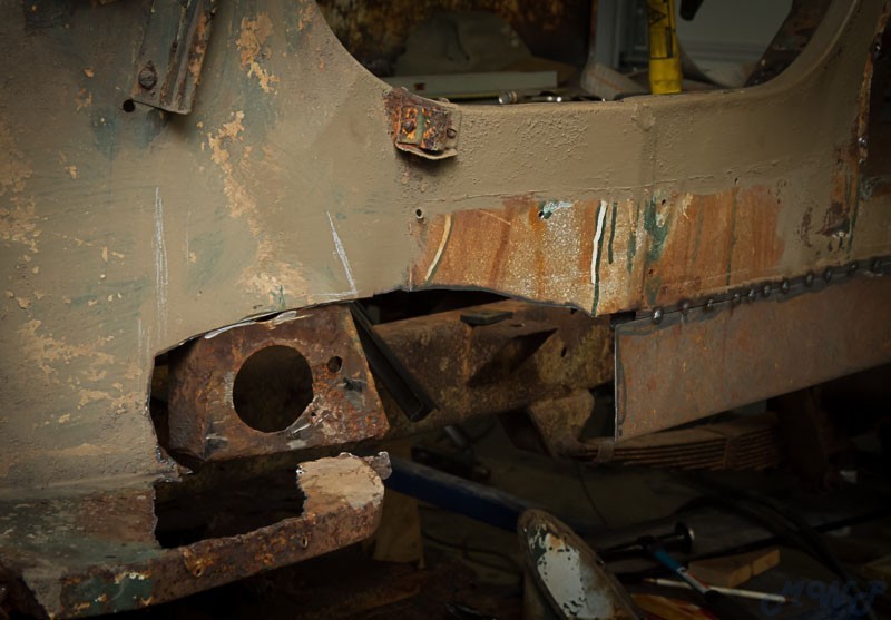

Got some work done on the driver's side
The rear section, finished cutting out the fuel exit, and made a piece to replace the rot on the bottom.
Cut out the rot from front
Positioning the repair panel.� My plan was to show the cutting process, but I forgot to take photos of the progression.
Repair after� �
The side at end-of-day on Friday.� . .� I realized after welding in the patch that I forgot the drain hole. :(� �� I will have to cut and form that in place.

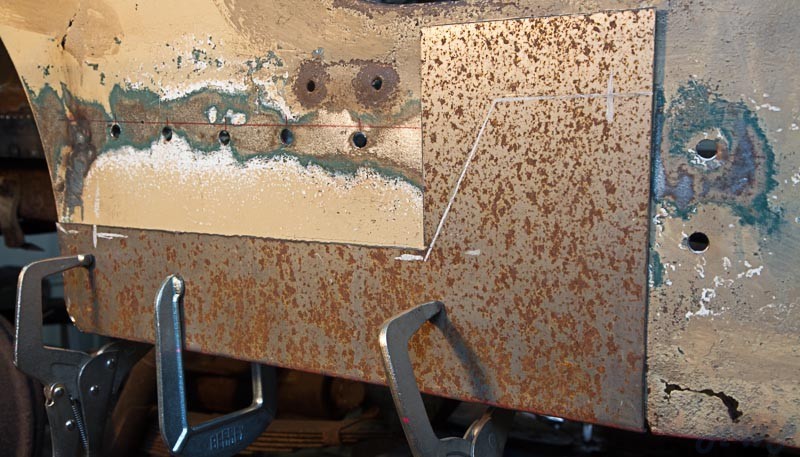

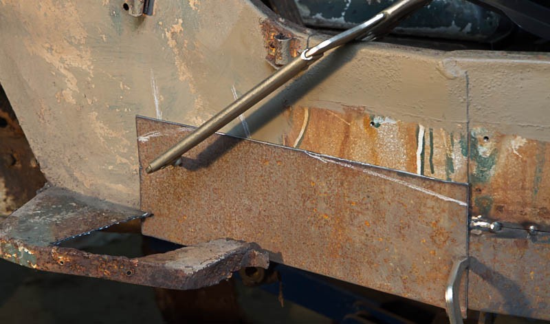

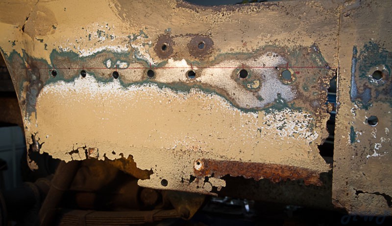

Starting on passenger side
Before:

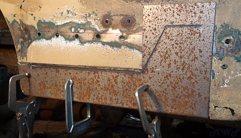

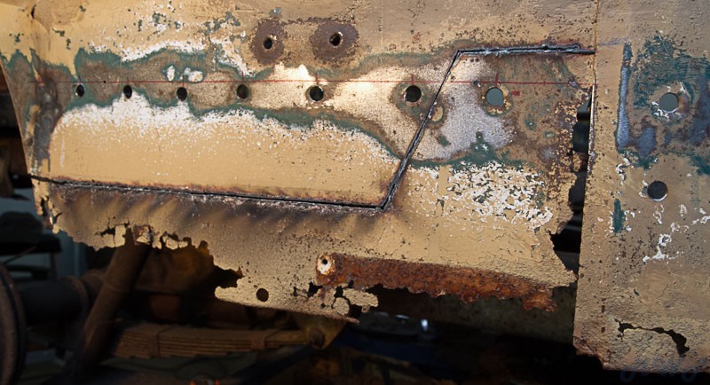

Rough cut patch . . the rolled lip at bottom is formed in (I used a vise, and hammer) . .� this bottom lip is lined up using laser,� then clamped.� . .� the intended cut is marked in chalk.
After making the cut
The patch panel unclamped.� The cut went thru both layers.� . .� the ends were done with thin wheel on grinder.
A little wiggling, and the rotted piece drops off.
Repair panel tacked in place
