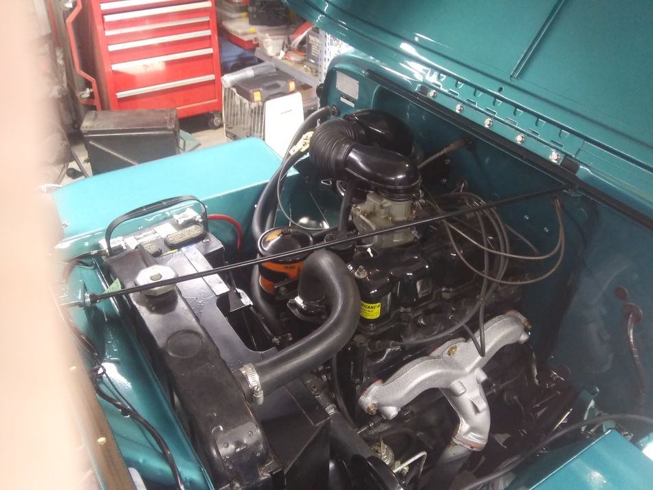

I chose to use high temp paint - in hopes that would minimize the rust pits that seem to form after some time.

I had to replace my cracked manifold with a new one, so I had a local powder coating company coat it with a high temp coating called "cast iron". It looked really great and did look like fresh cast iron, but didn't hold up very well. I'm starting to see small rust pits in the finish now.

I’m pretty sure they left the factory raw cast. Eastwood makes a product that works pretty good on cast manifolds, but in given time and countless heat cycles it doesent matter what you use they seem to revert back to Rusty cast iron 😂
