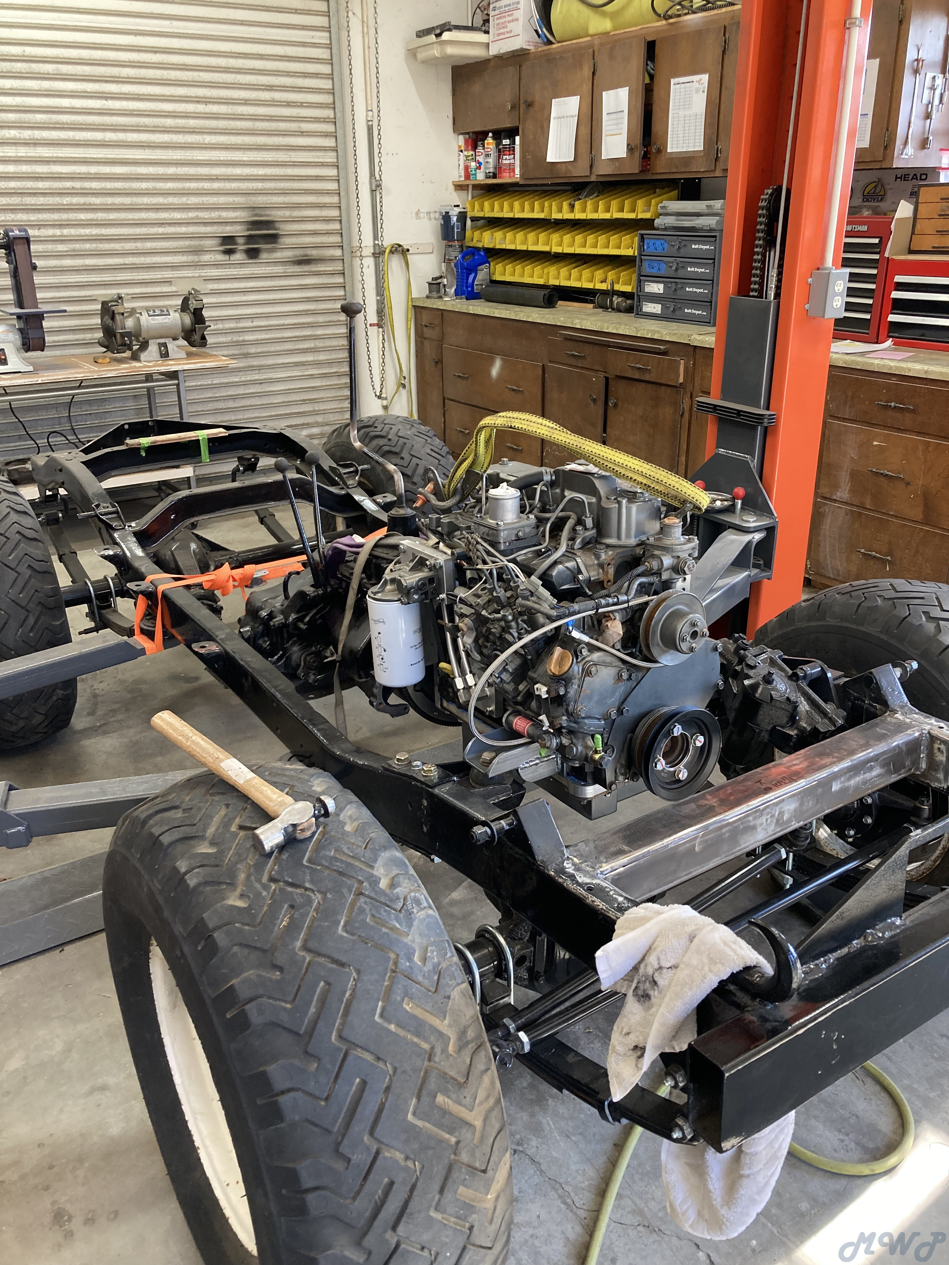

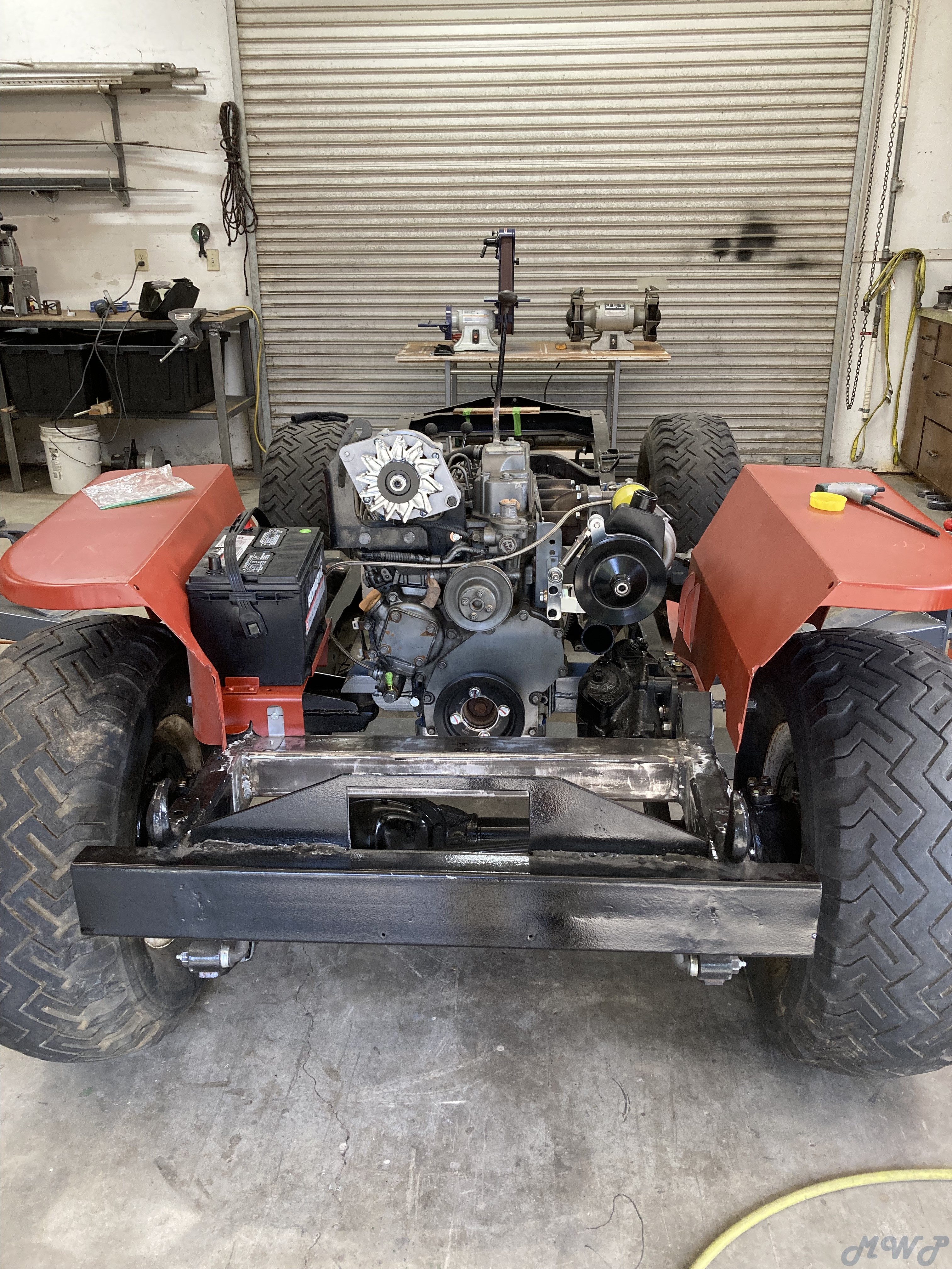

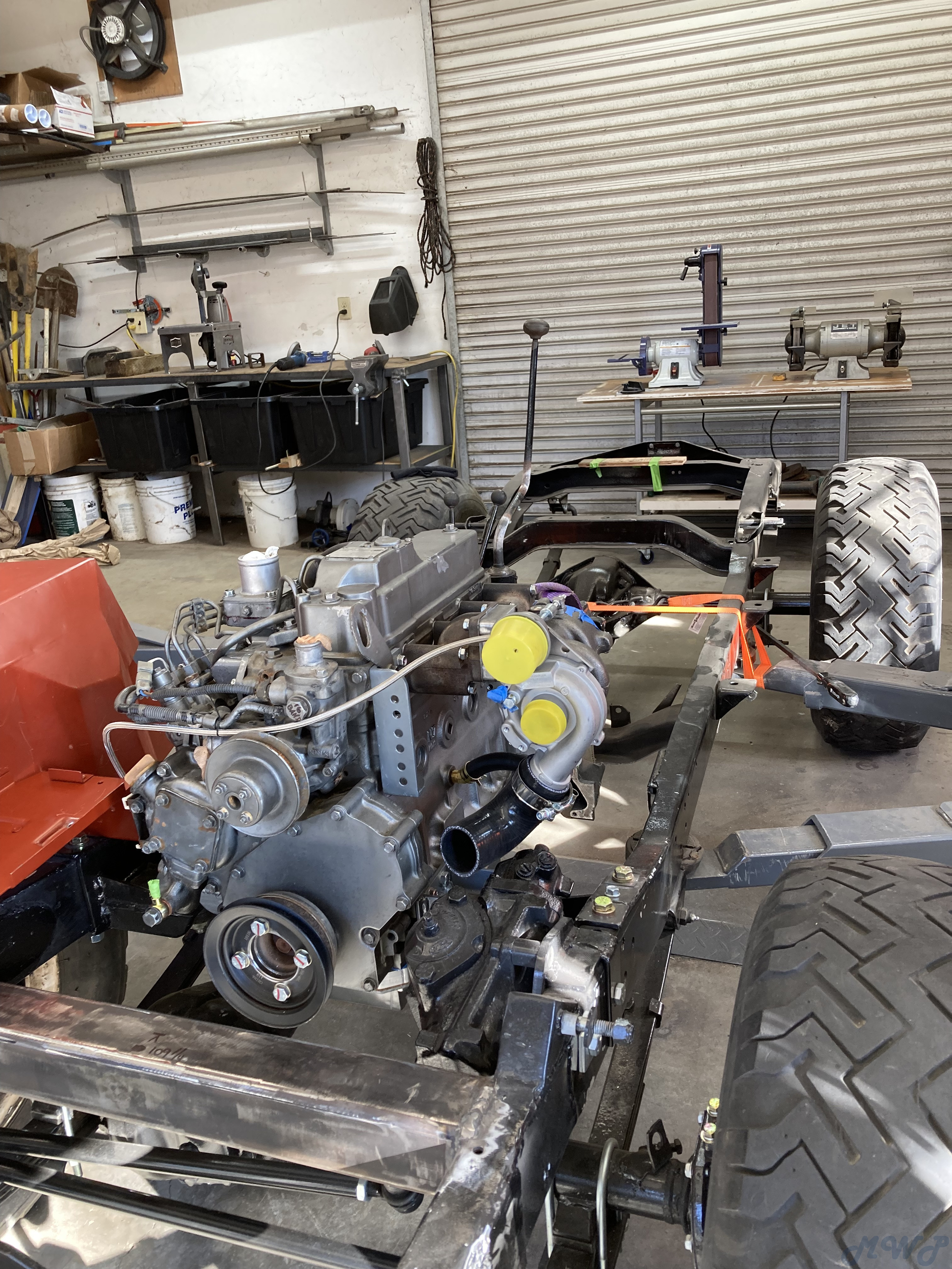

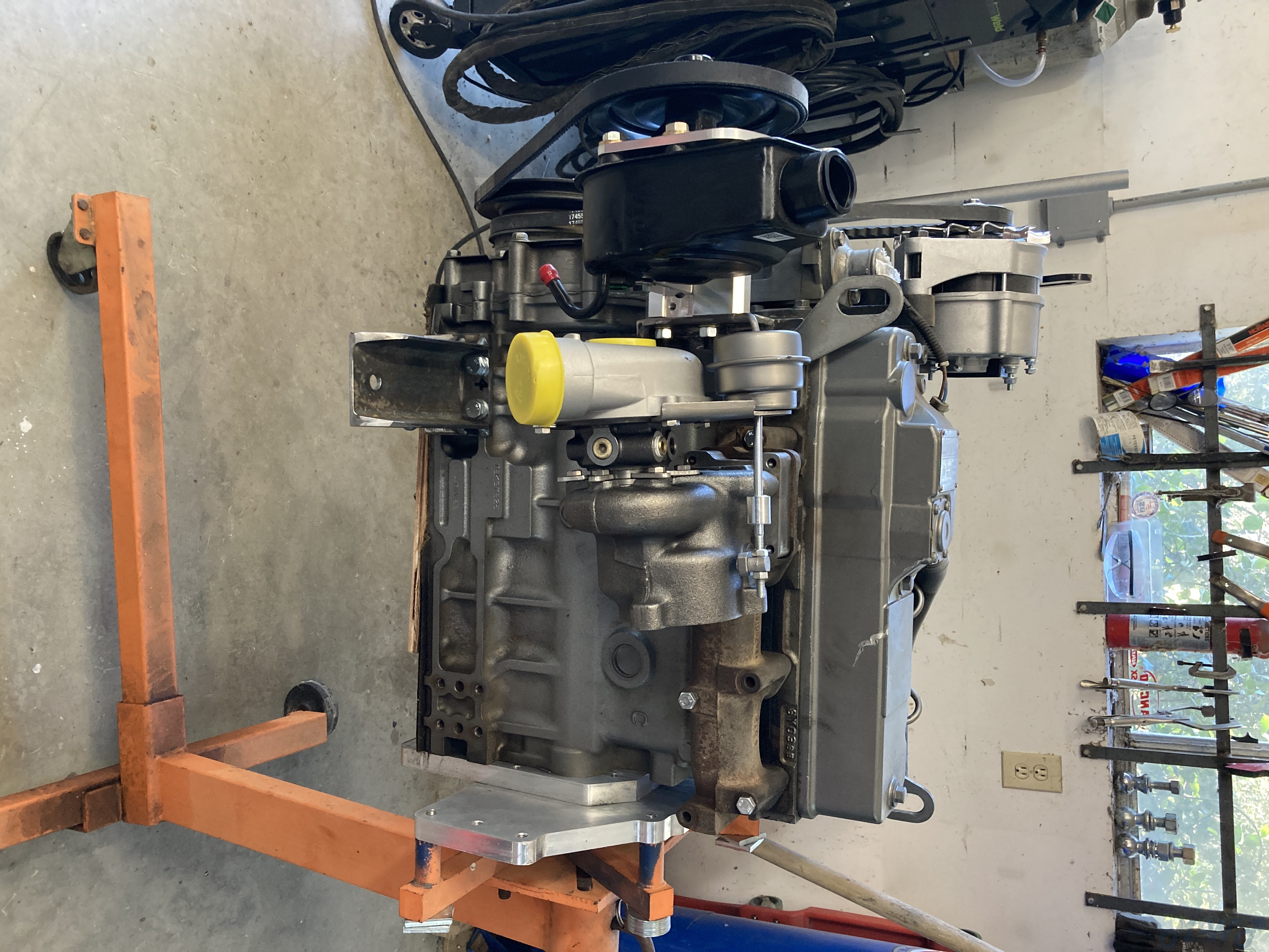

I'm building a 51' 3a with a Yanmar 4tnv86 out of a refer. The engine fits easily, it's adapted to a 4 speed Munci trans with a Kabota Swapers kit and a Advanced Adapter transfer case adapter

How do you rotate pics?
