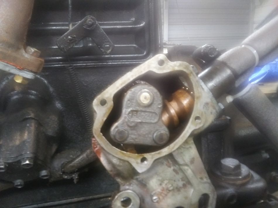

Keep in mind the shaft has two bushings that need to be lubricated (there should be a seal on the outside where the steering arm attaches) so anything you use thicker than gear oil may not be able to penetrate effectively.
The filler plug should be 1/8" NPT (I think).
Here's an image of Lawrence Wade's '55 showing the front end of the steering gear housing (with the filler plug at the very top of the image):
