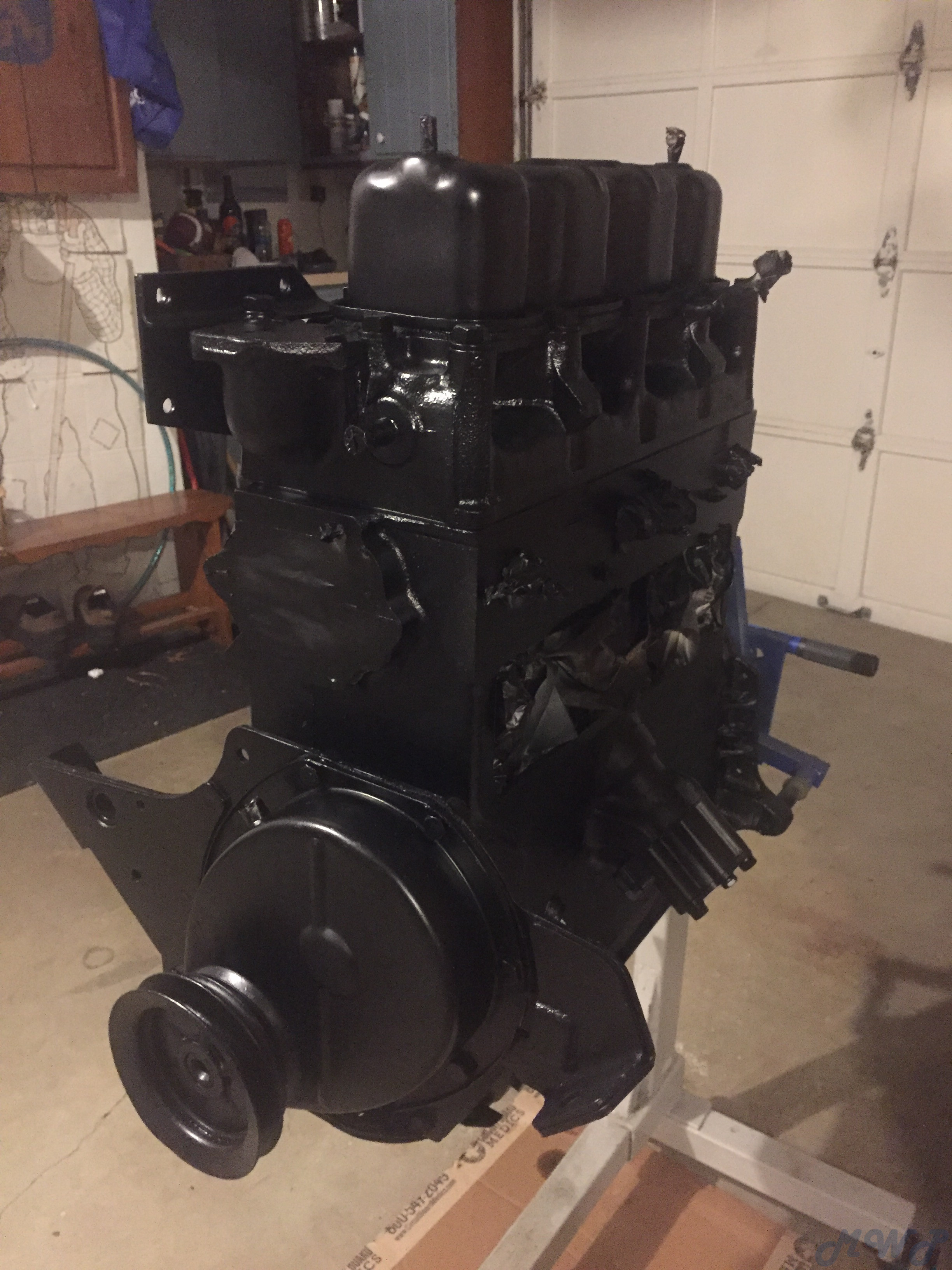

However, I will add all new updates and photos here.  All bearings, Crank, Cam, pistons, timing gears, oil pump, dist, oil pickup, and pan all installed.  Putting the head on over the next couple of days.  Once the rockers are in, it will be time to wait for a warm day to paint the engine.  Just broke 32 degrees here in Northeast Ohio for the first time in 3 weeks.  My goal is to get the Willys back up and running before the end of April - but I'm going to need a 50+ day for painting the engine.

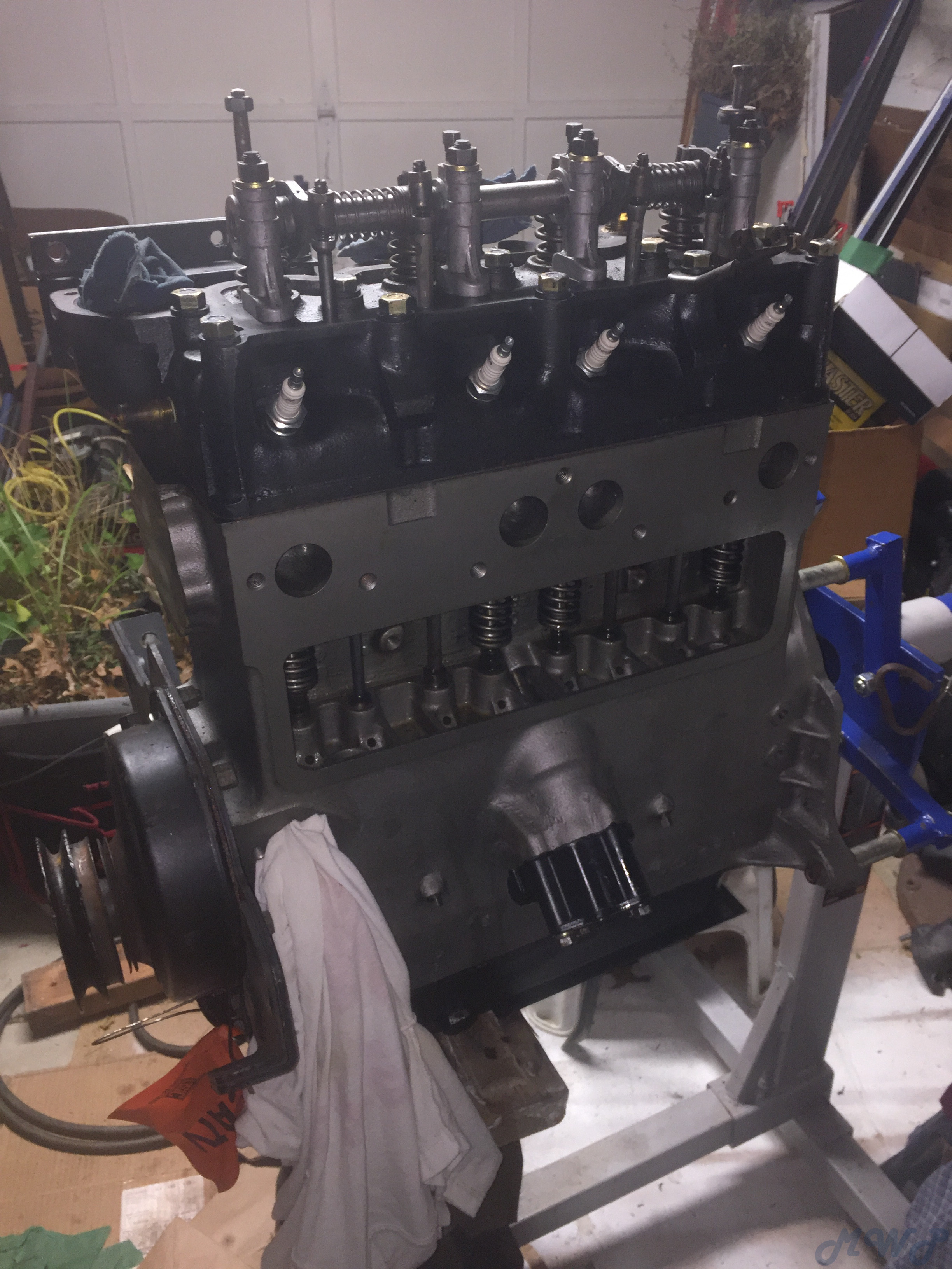

Head and block prepped...  Created some alignment studs from old head bolts.  Metal side up.

« Reply #5 on: September 20, 2023, 03:07:21 PM »
UPDATE:
The Willy's has made a few trips out and around to debug things.  Re-indexed the oil pump, now have good power.  Got the roll bar on.  Low oil pressure solved.  Fuel pump was leaking at the glass dome - the custom cork gasket made 8 years ago failed.   I used a neoprene washer that I had to cut up a bit but it looks like that will last a long time.  I have a lot of little things to put back on and fix- bad ignition switch, no brake lights, no tail lights, no mirrors, etc.  Definitely need new tires, ouch.  When I do that, I want to paint the rims black.
