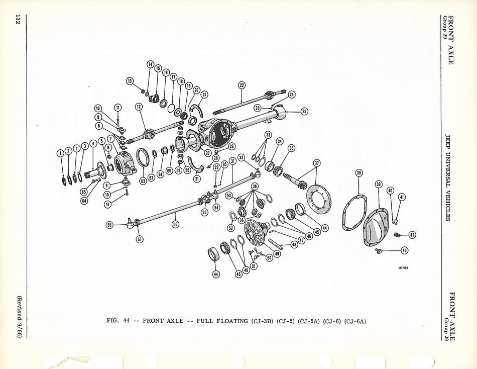

differential leak
« Reply #8 on: September 13, 2020, 09:39:23 PM »
The breather is screwed into the cover, just above the fill plug, item #41 below.
I doubt this is your problem as if it were leaking, it would be very obvious. I suspect that you have a crack radiating out from the drain hole. A through cleaning and the use of a dye penetrant  test may show it.  Also keep in mind that the drain plug is pipe threads and pipe threads are tapered. Overtightening, especially with excessive wraps of teflon tape, can actually crack the housing.
