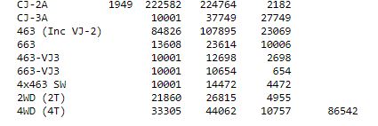

I'd say that engine serial number is from about 1949 or so. The casting number and other cast characters from the driver and passenger sides, down low, near the rear would help to date it.
Check out the Norton Young Willys-Overland Production Figures over on the CJ-3B Page.
https://cj3b.info/WOfigures.html
This shows that Willys did use an "SW" designation.

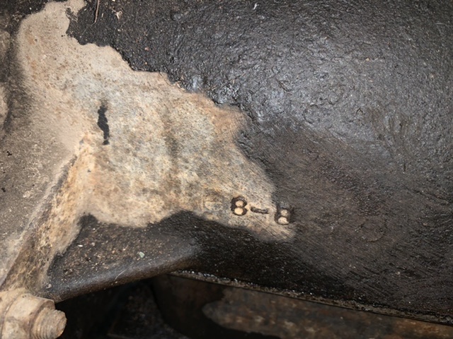

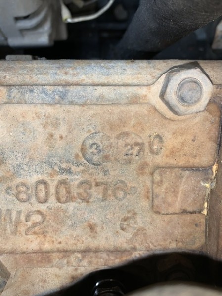

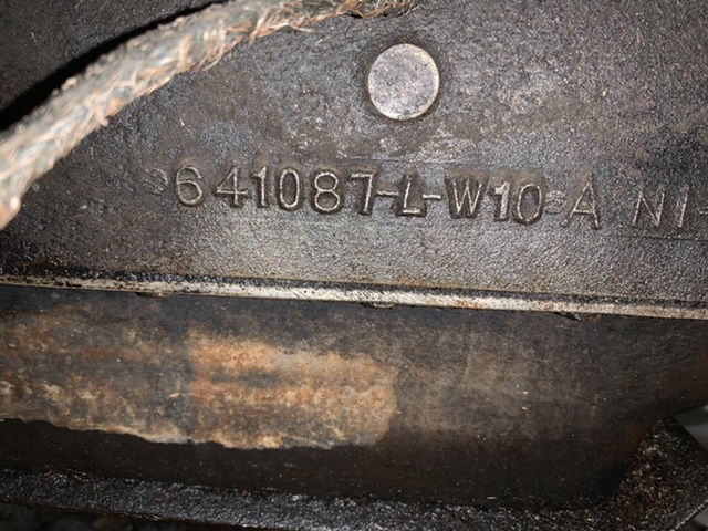

« Reply #5 on: March 07, 2020, 02:05:31 PM »
Here are some photos of the casting number.  I don't find anything on the street side of the block.

Re: Engine Number Beginning With 4SW
« Reply #6 on: March 07, 2020, 04:09:12 PM »
I don't have much information about the Willys Utility line of vehicles, but with those casting numbers I'd say that the engine is close to, but no later than 1949.
