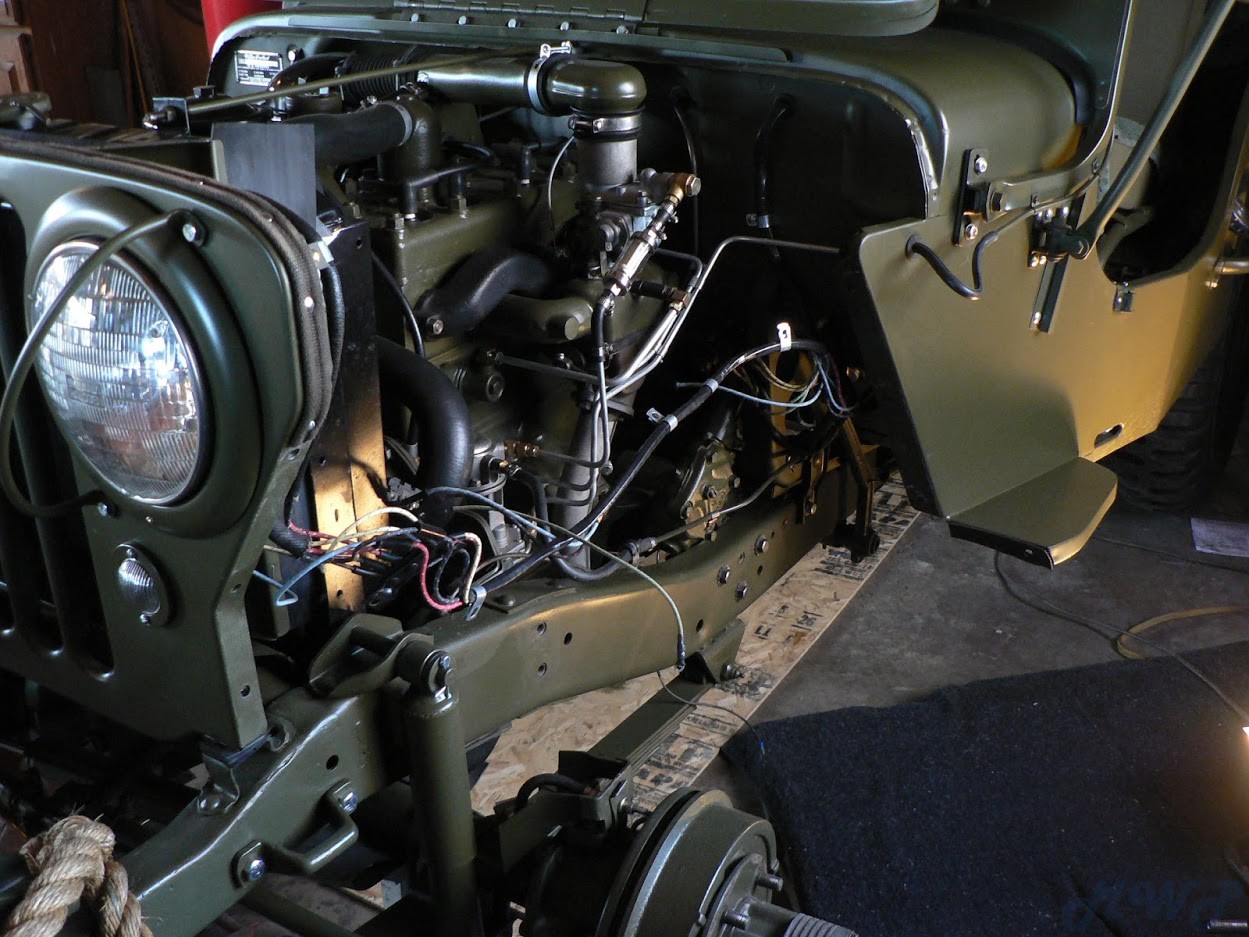

The rest of the engine bay and dash went well.  Walck's wire harnesses are terrific.

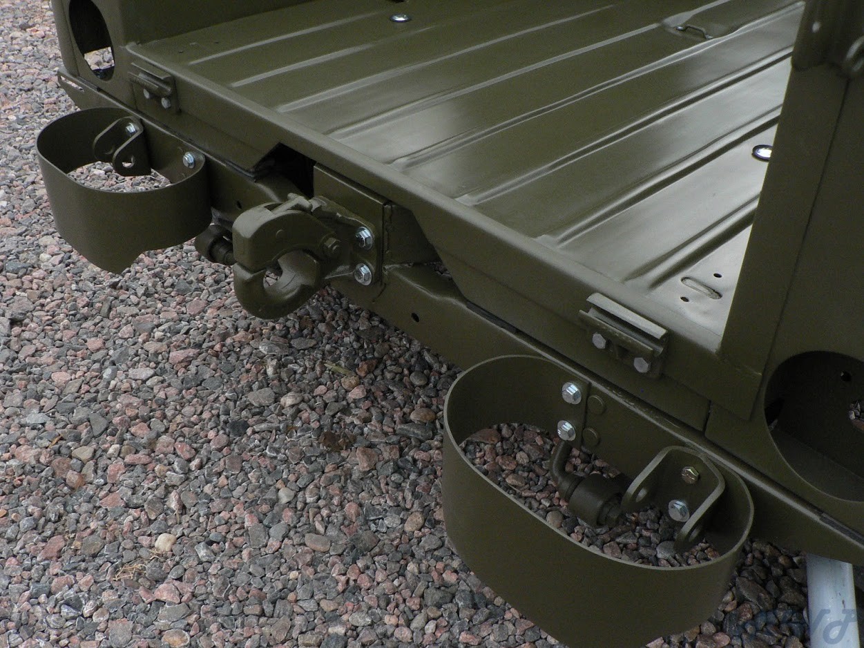

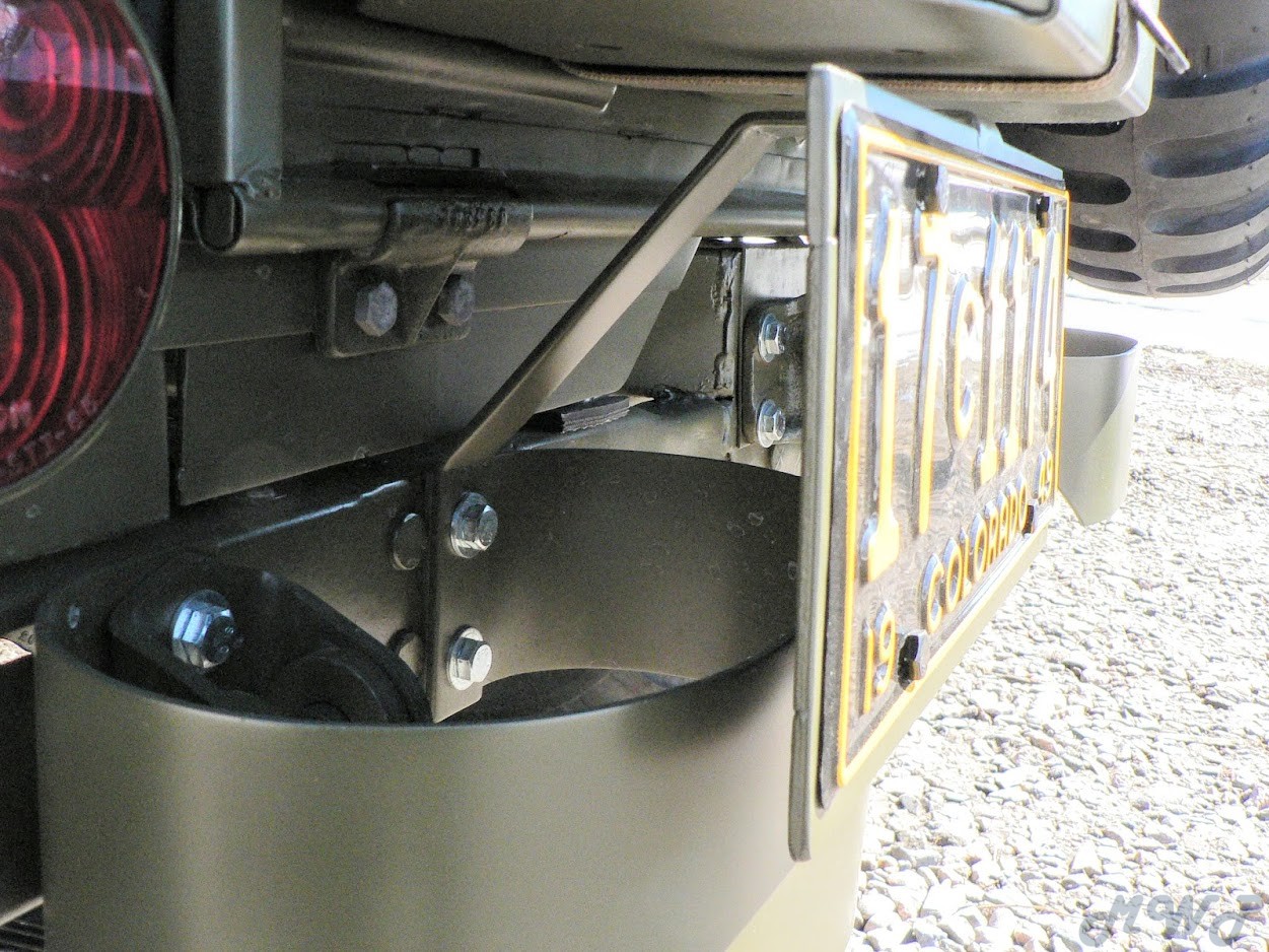

I found a brand new, never issued set of 1949 Colorado license plates on Ebay.  Like many states, Colorado allows you to run with DOM plates as long as you have it licensed with real plates.  You just need to have the real plate and registration with you.
I didn't really have the room to mount them in the traditional places, so I made some custom brackets...

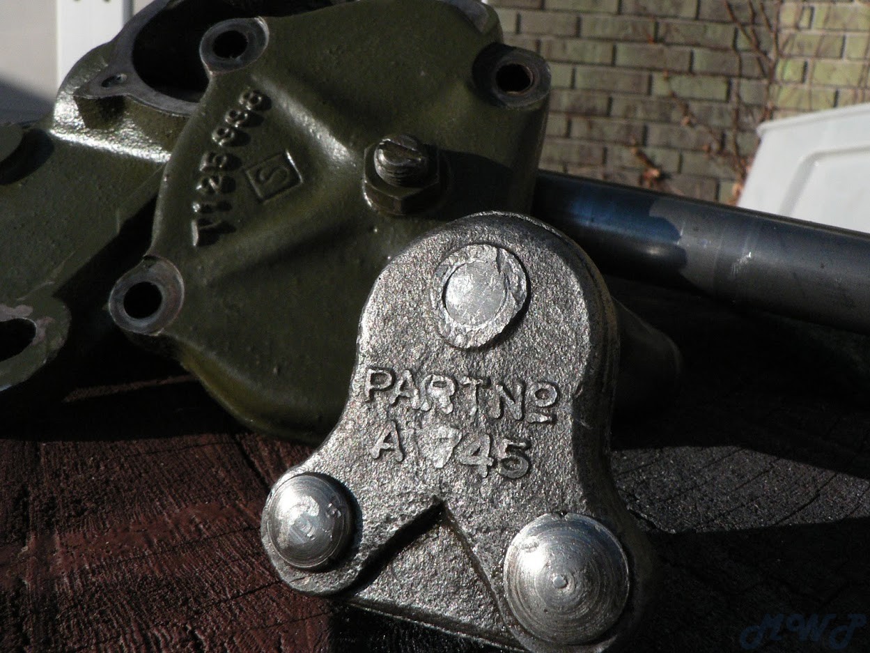

After driving it around a bit I found the steering to be a little sloppy.  I took it apart and rebuilt the steering components...

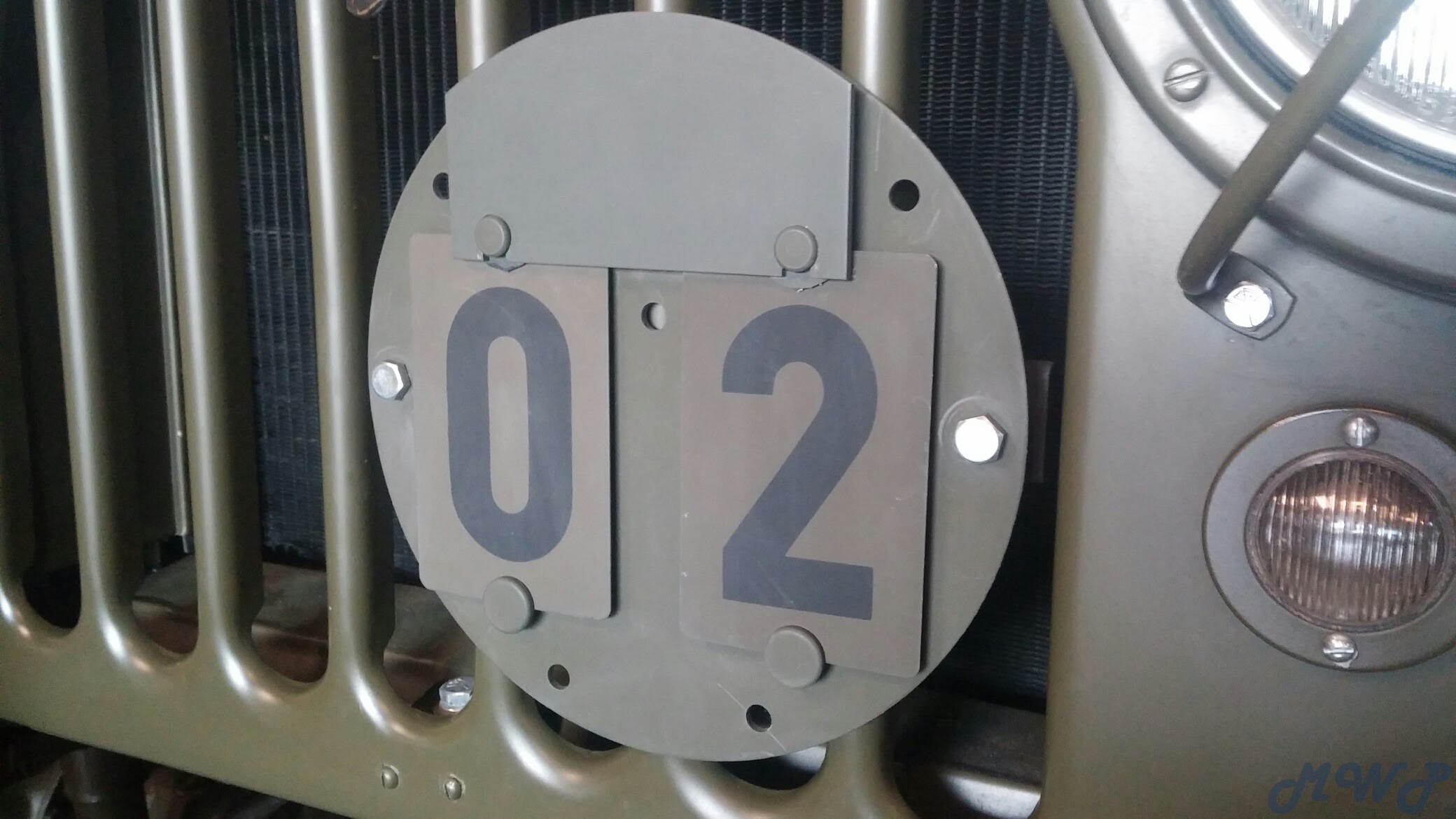

I got some traditional stencils and added them to the Jeep.  I did a little research and found that the first military unit to arrive in Korea at the beginning of the war was the 24th Infantry Division, 11th Field Artillery Battalion, so I chose that group for my bumper lettering.

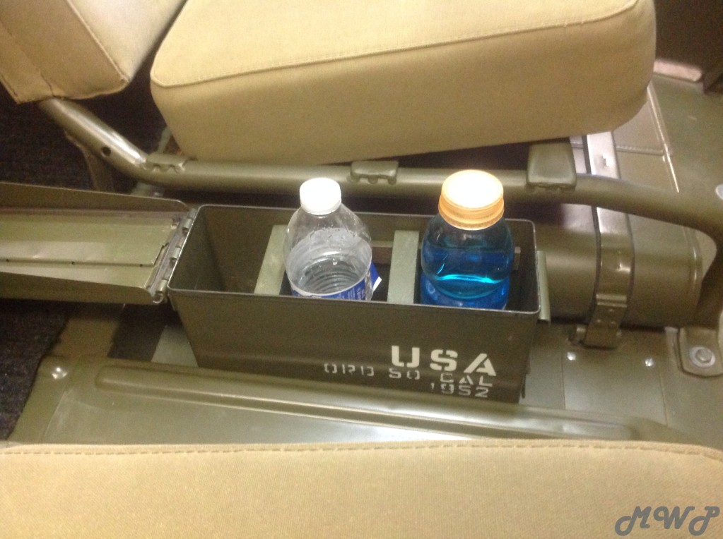

I mounted an ammo can to function as a wallet and cup holder.
