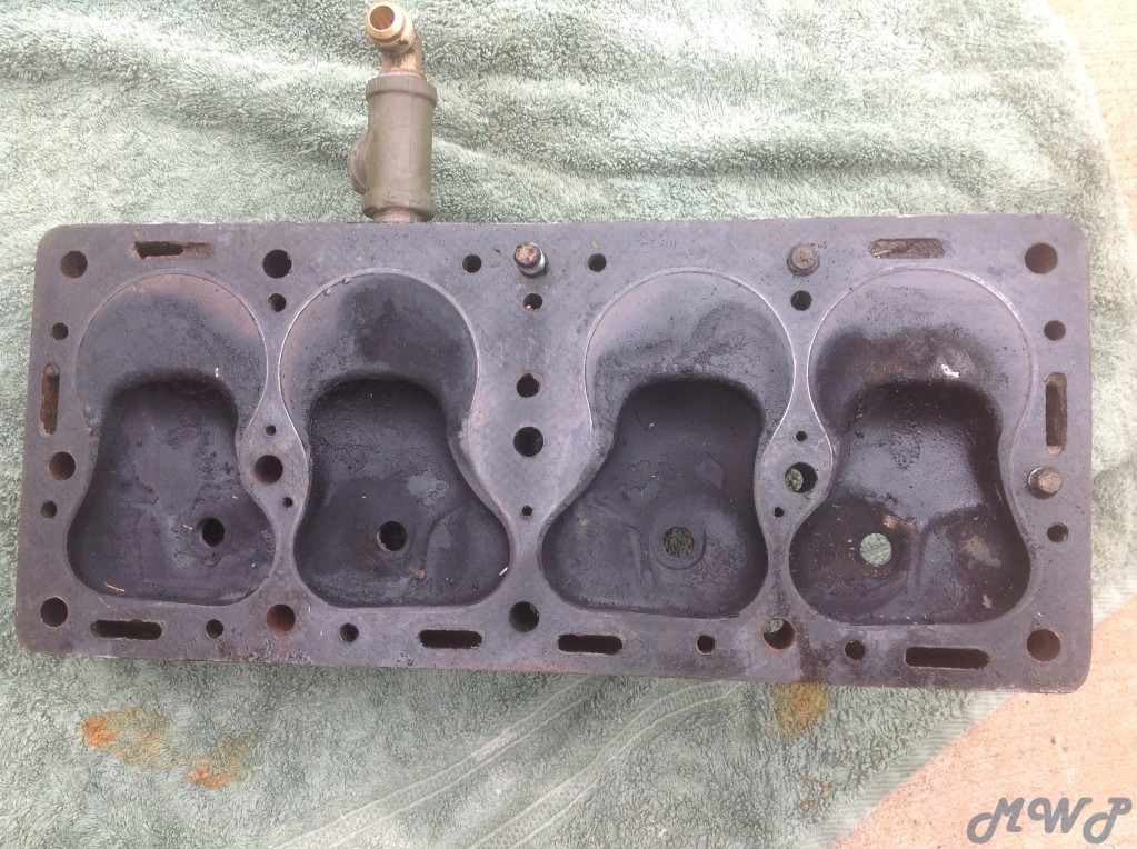

I can't currently measure these heads, but I thought I'd post them so you can try to visually compare them to yours.� The first one is a GPW head.� The second is a 2A head.� It may be angles or illusions, but it looks like there is more "meat" between the chamber and the stud hole on these heads when comparing them to the spot your screw driver is pointing at.
« Last Edit: December 27, 2017, 07:59:22 PM by athawk11 »
Re: Head gasket: Fel-pro a dud? Anything better?
« Reply #9 on: December 27, 2017, 11:03:28 PM »
Tim, Thanks for the pix.

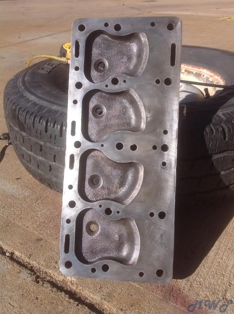

Attached is a pic of what an industrial head looks like. The shape around the valves is very similar except for depth (as far as I can measure) to a Go Devil head I have on hand (it's no good...cracked). The gasket fit is less than optimum on the Go Devil too. I guess I'm being the Don Quixote for L134 gaskets.
I will be realistic that the market for Go Devil parts is a super small so what's out there is all there is, and after all, my engine combo is a "Jeep salad" so to speak. I'll just try my best to make this stuff work.

I thought I'd share a surprising finding regarding the industrial head vs. the standard Go Devil head.
I cc'd each head, and I found that the Industrial head combustion chamber cc'd to 87.5 cc's.
The Go Devil cc'd at 91 cc's.
This was for #4 on both heads. I did the measurement twice on each to be sure.
Calculating the compression ratio assuming a 0.070" thick head gasket, zero deck pistons and ignoring the volume taken by the valves sticking up above the deck of the block, this calculates to:
6.68 to 1 with the Industrial head, and
6.48 to 1 with the Go Devil head.
So, despite the Industrial head having a 0.065" dish around the complete circumference of the cylinder (the Go Devil has no dish around the cylinder bore), I can see that the "bowl" of the Industrial head ramps at a much shallower angle to the spark plug zone compared to the Go Devil ramp in the "bowl".
