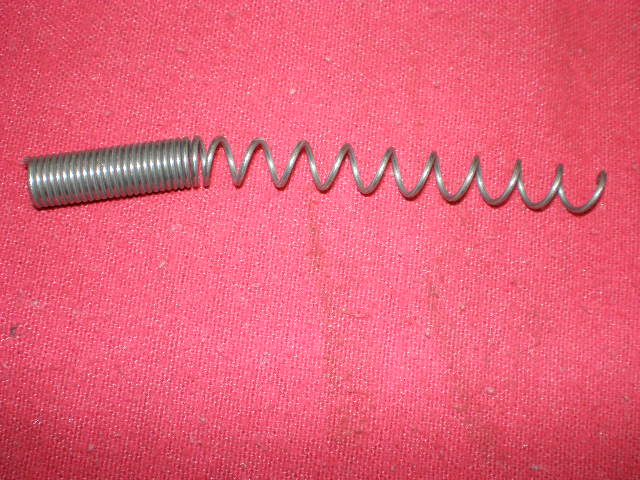

« Reply #14 on: May 21, 2017, 09:49:14 AM »
Here is a pic of the coils in a 1950 passenger seat. THose of the driver's seat didn't survive.
I'm planning to get them copied.  If that is feasable, would anyone be interested?
