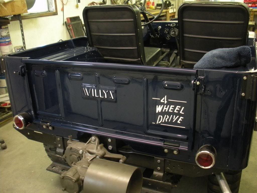

Wow the black on red looks nice. Guess I will try this method.
Hey gg how did you get the stencil on the tailgate to look so good without bleed?

I'm curious what GarageGnome says but I'll throw in my $0.02.
I tried a stencil, taped down, on a scrap hood I had. I used light coats of Rustoleum spray and it was a disaster. If you look at an original tailgate stencil they are kind of fuzzy but not nearly this bad.
My next attempt was with a "peel and stick" paint mask stencil. The results were far better (although way too crisp for a genuine "original" look).
Here's my shaky hand painted letters too. Up close you can see the flaws but like everything else on this Jeep it's passable if you stand at least 20' away.� ;D

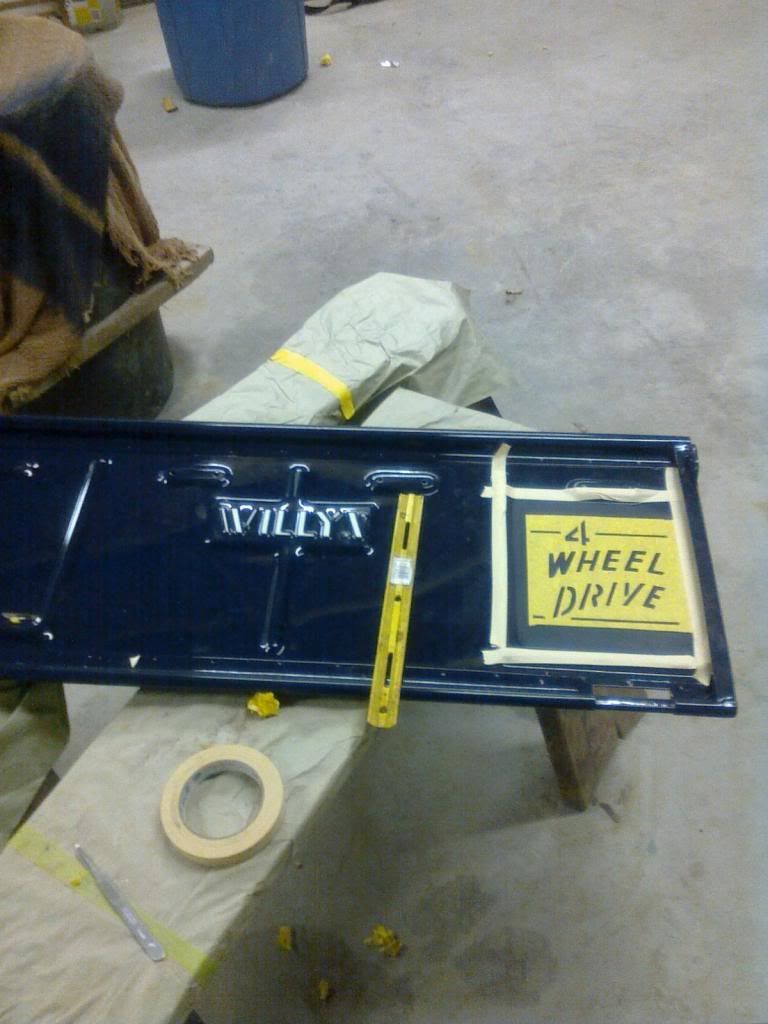

I tried to imagine how they would have done it at the factory..IF they did it at the factory. They would not have spent hours masking...
Now i know professional sign painters can probably free-hand these things in a jiffy..
but I made a template, sort of, and used a flat wide foam brush and just went back and forth a couple times...not perfect, and all three are different, but it looks authentic..
I used the card template on the tailgate...I put double sided scotch tape everywhere I could to hold the template tight and reduce bleed..it still needed a little cleaning which isn't difficult if you do it before the paint really sets...I used some hard cotton swabs that were meant for gun cleaning..they had a pointed cotton end and worked well...
By the time you do the last one you will be pretty good at it....
It made those paint masks that Tim mentioned look pretty good..

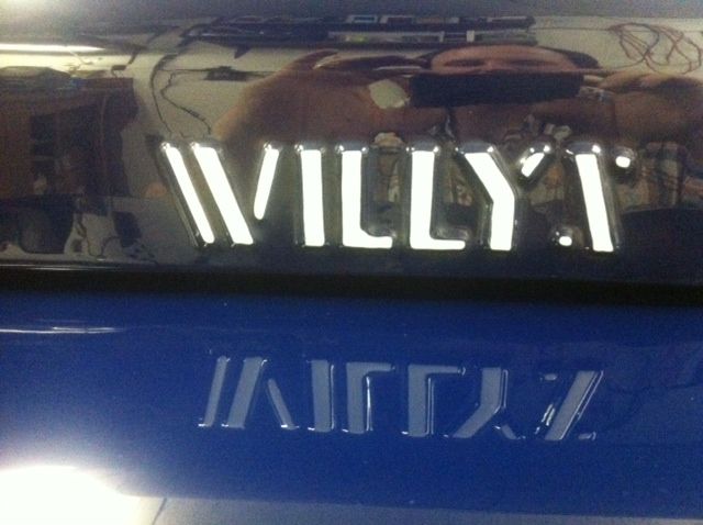

If you are not confident enough that you have a steady enough hand, look for "Frisk" film it's used for making stencils/masking for airbrushing. You still have to cut the letters yourself, but once it's on you can even use a paintroller or spraycan. The film, if applied correctly, wont let paint leak under it so you should always get straight letters. You could put it on the raised letters using a heatgun first and then cut the frisk away. It's light tack so you can easily remove it. Trick is removing it at the right time, just before the paint is dry to the touch and still flexible so you dont pull paint from the letter edge when you remove the film. It depends heavily on the type of paint you used, there's no real guideline to give other then experience.
You can also use it to make your own texts or anything, just as long as you cut straight and use sharp X-acto blades. I just finished this on the CJ3a. I used frisk film for the large areas and painted in the rest by hand:
I did'nt want to sand down the surface and ruin the patina, so the edges did come out a little bit rough. But on new or smooth paint it should not be a problem with the Frisk film and you should get razorsharp edges if you want to.
Now i'm not an artist, i do do modelscale building and paint 1/6 anime figures, but never tried to paint a drawing on a flat surface before. But she turned out pretty well i think.
