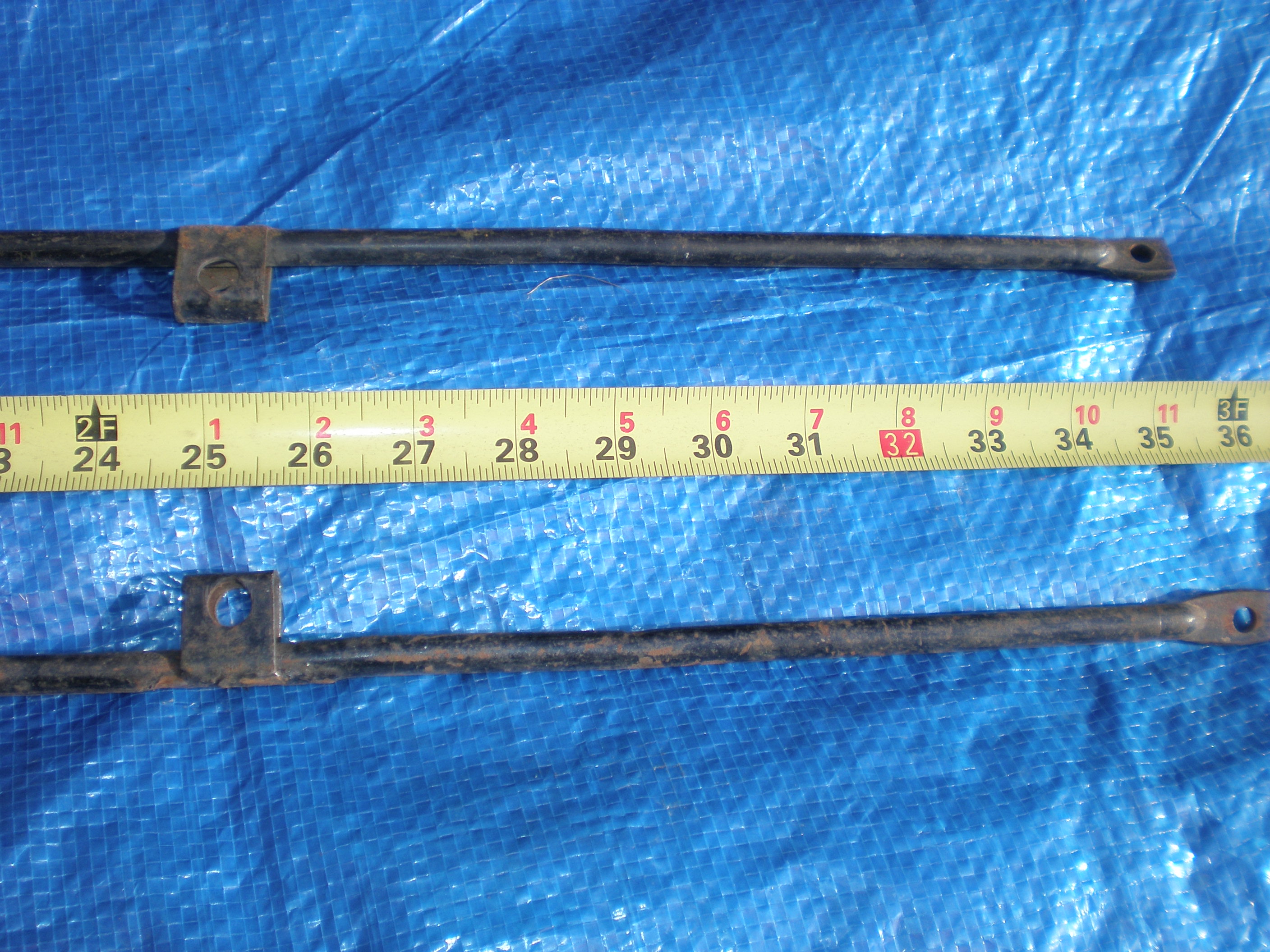

Here are the dimensions of some original rods....

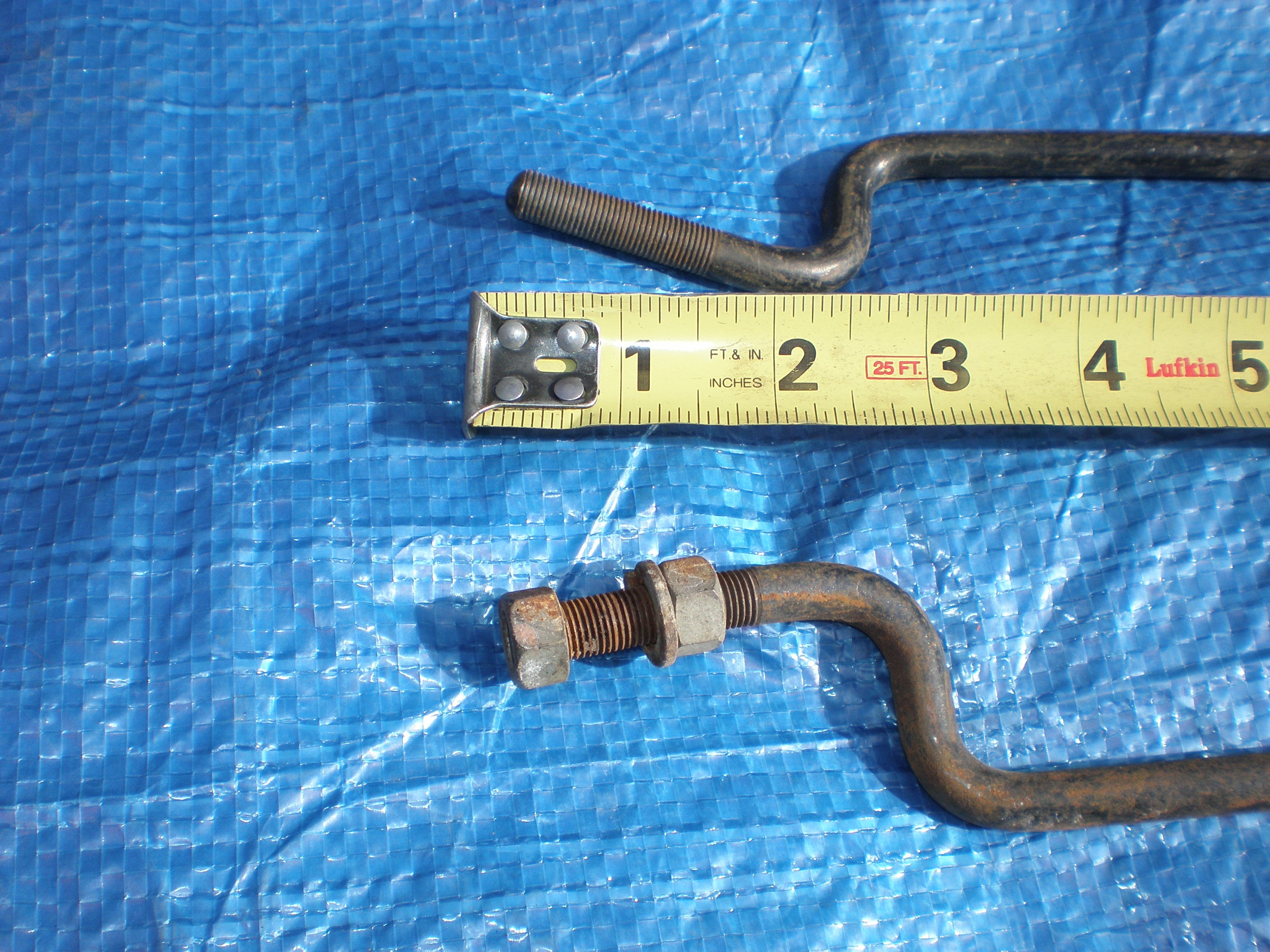

[size=12]I talked to Walcks yesterday and was told the Top Frame was reverse engineered from a know source and he has not received any negative feedback.  He is still selling from the first batch so we are guessing it has something to do with my repo tub. What a shock!!!
3 different rods set up the location the top of the windshield must be relative to the back of the tub.
Here are pictures of my measurements for the rods that set up the location of the top of the windshield relative to the soft top frame. I have the tape measure starting where I had adjusted the locking nuts to.[/size]
[size=12]These next two pictures are to compare with Bob's.[/size]

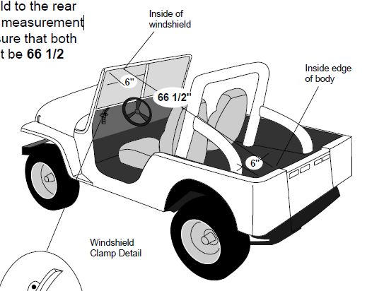

What is this dimension on your Jeep?

Bob, I'll post a picture tomorrow.  I did a quick measurement and came up with 66 1/2" inside to inside.

[size=12]Re measured and ended up with 66 5/8".  This was done with the front windshield pivot mounts located an inch below their original location and the top frame rods in place.
