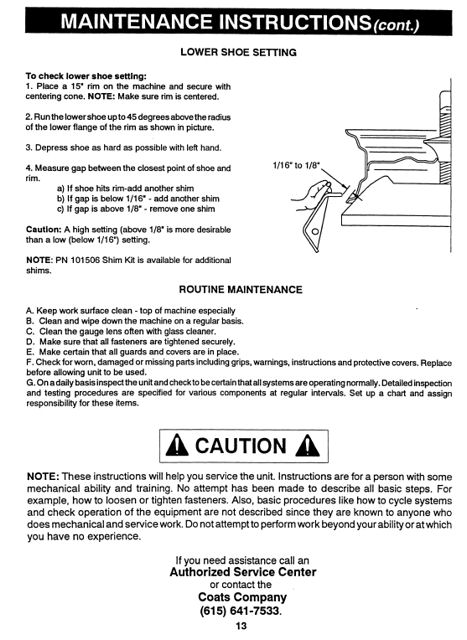

It's easy to accidentally bend a rim using the very common, good old days, Coats 4040 machine. This is because the lower shoe moves during every operation, not just when breaking the lower bead. If it's not adjusted properly the shoe catches on the rim and this machine has enough power to easily bend the wheel. I think the wheel could even get bent if the tire was old and not pliable and required a lot of force to break the bead.

Bob, you never stop teaching me a new old thing that I did not know before.    That is very useful information.  However, since it is impossible to talk to these tire guys, I doubt they would ever listen to me about adjusting and calibrating their machines before they work on my tires.  They act like they are doing me a favor just by agreeing to work on the tires.  So that leaves doing it by hand myself if I want to have any say in how careful or gentle it is done.  Now here is the $64,000 question.  If I use the two manual hand held tire iron method, how rough on the rim is the move where you stick the tire iron under the tire bead and bend the iron back until the bead pops over the rim.   Will that act alone bend a rim.
