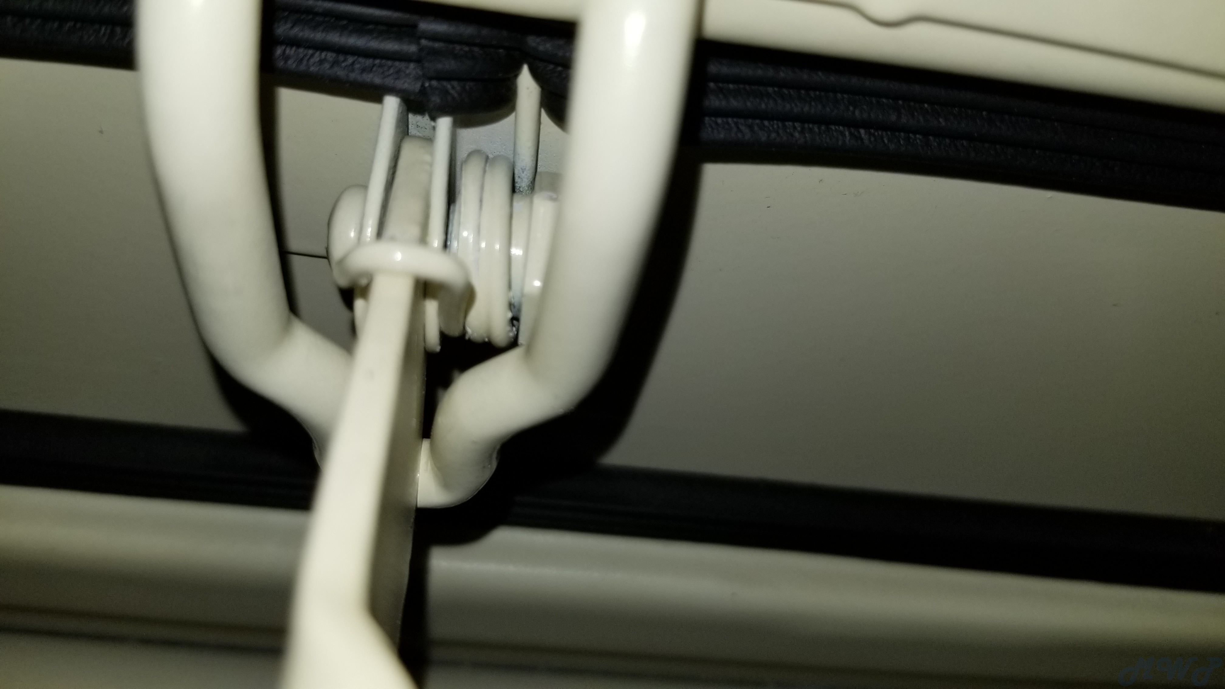

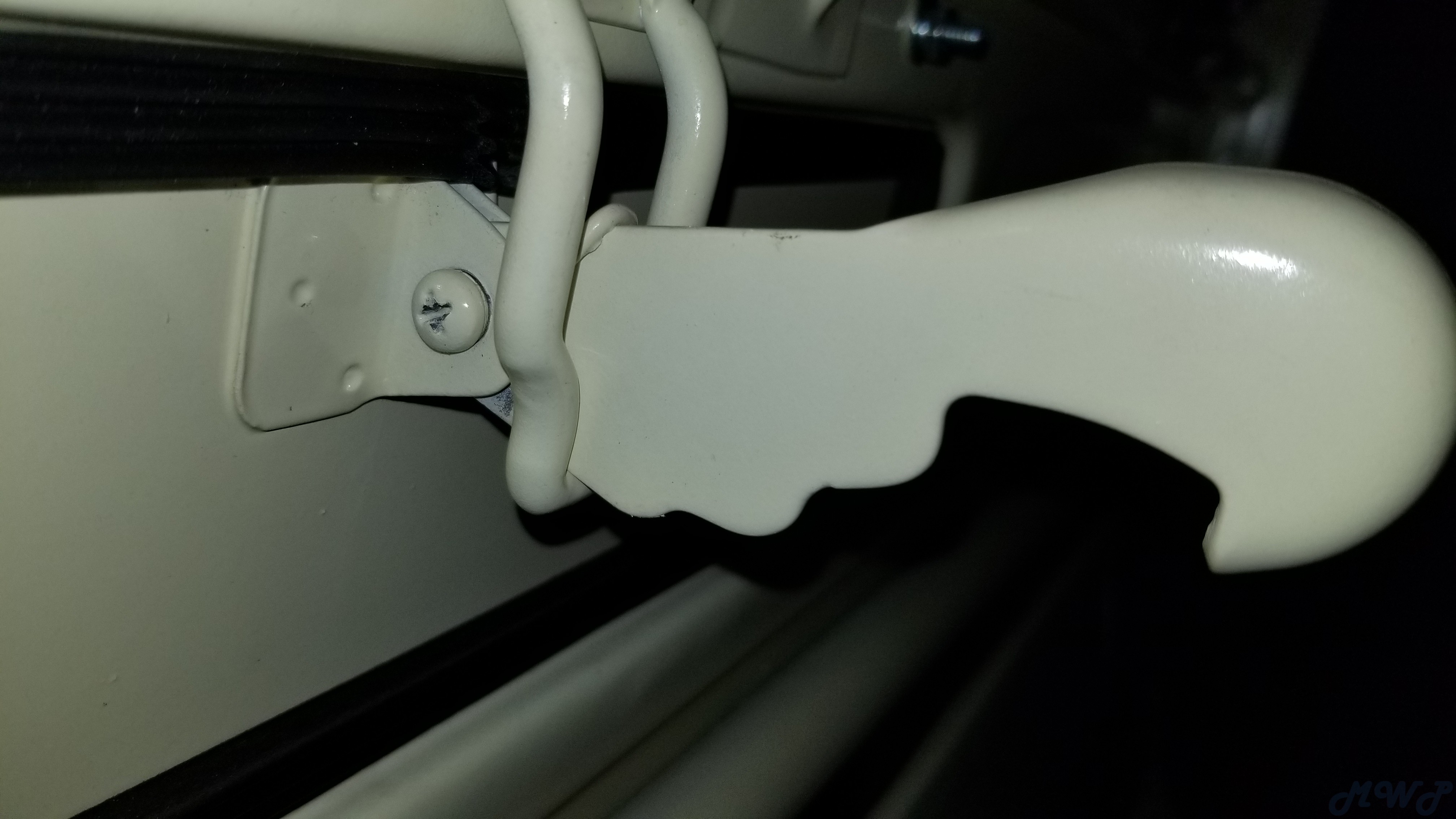

Here are a few photos to add to Stony's drawings...
