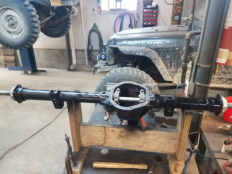

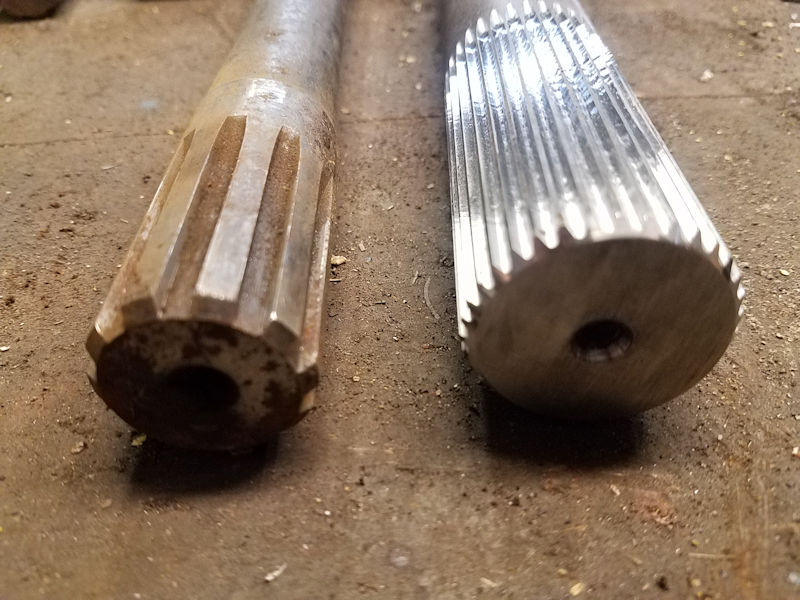

Another update. I really didn't like the idea of running 10 spline axles while rock crawling. They just don't seem strong enough. Finally got around to to upgrading to 35 spline shafts. Quite a difference....
I also went with 53" WMS to match the front Dana 30 "narrow track" axle and used a high pinion center section to get the driveshaft up further out of harms way.
« Reply #288 on: April 03, 2020, 07:13:11 PM »
35 spline you say. WOW !  What’s the diameter ? So will the high pinion clear everything when fully stuffed ?
« Reply #289 on: April 03, 2020, 08:29:02 PM »
The 35 spline axle shafts have 1.5" diameter. The high pinion fits just fine in the stock location.

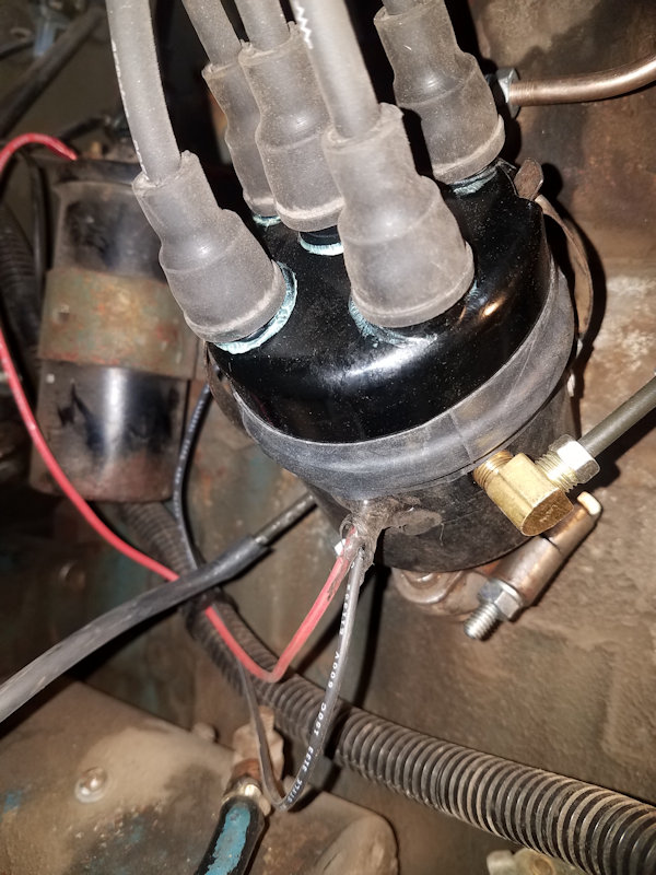

I've been thinking about how low the distributor is on the F-134 engine in relation water splashing due to stream crossings. I decided to make the distributor a bit more splash proof. I picked up a used IAD 4008 (thanks 3-48s), replaced the bushings, installed a Pertronix Ignitor II, resistor plug wires, M-38 style distributor venting and a rubber seal around the distributor cap to body seam. I selected the IAD 4008 because it has the largest spacing between the plug wires of the common Willys distributors. The Pertronix Ignitor II has current limiting, unlike the regular Ignitor, so there is less chance of damage if the key is inadvertently left on. Resistor plug wires are required with the Pertronix units and this also significantly decreased the noise on my CB radio. An inner tube provides the seal between the cap and distributor body. Haven't been near any water yet so I don't know if it actually helps.

The inner tube idea is great!  Is that some type water repellant residue under the wire boots?
« Reply #292 on: April 09, 2020, 06:41:42 PM »
Yes, it is ignition dielectric grease.
