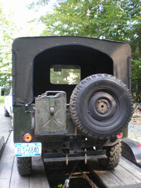

This project has really stalled for the summer :( The only thing I've managed to do is the tailgate. Welded in a new lower edge between the hinges where they are always rusted out and then put it on my CJ-3A for the weekend. I don't like driving around with the spare tire hanging on the side.

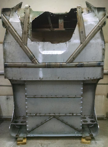

I finally found a couple days to work on this project again! It is time to turn the tub upside down to finish welding the stuff on the bottom of my simplified CJ body.

« Reply #50 on: December 07, 2014, 10:23:17 PM »
Don't those tubs look great once you've replaced all the holes with steel?

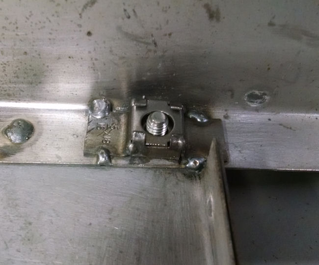

« Reply #51 on: December 15, 2014, 11:30:29 AM »
Bob,
Some thing is wrong today with my ability to access to the CJ-3B B.B.
Here's the dimensions you need.
Center of rear tank strap capture nut is 5/8" inboard of the wheelhouse and 5/8" back from the edge of the floor rise.
Center of the front tank strap capture nut is 10-1/2" inboard of the quarter panel and about 19-5/8" from the floor riser.
By the way that body is looking very nice. I'd really like to have an identical 3A tub.
« Last Edit: December 15, 2014, 11:34:25 AM by oldtime »
« Reply #52 on: December 15, 2014, 11:45:08 AM »
Ken,
Thanks so much for the dimensions!!! I'm planning to get those captured nuts welded in place tonight.
« Reply #53 on: December 15, 2014, 11:58:05 AM »
As you know the thin gauge tank strap is 1" wide.

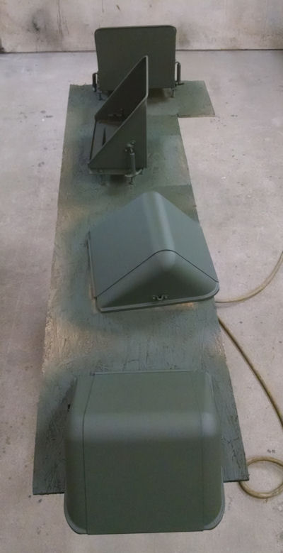

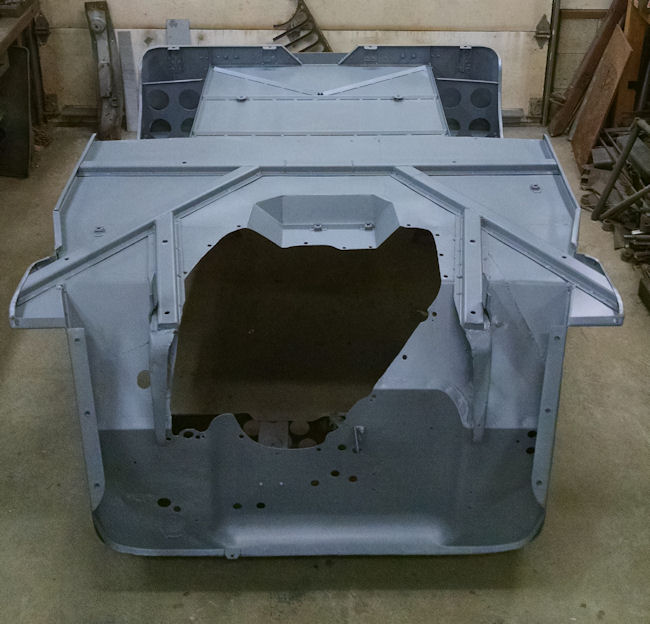

Got the underside of the tub epoxy-primed.
Also primed and painted the radio battery boxes for my CJ-V35/U
