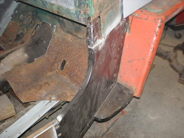

I have repro side cowl panels and custom side panels from a previous project that stalled. I will be using these panels on this project and hopefully I will be able to finish it this time. Just had to cut them off the previous failed project. The angle of the fender attachment flange on the repro panels isn't correct so that makes it more difficult to line things up.

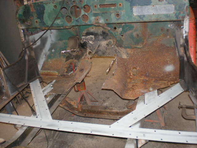

Since there is basically no floor in this Jeep I will be building one from scratch. It will be a simplified version of the original. I'm also going to use M-38 removable floor panels, I like that idea. Anyone have an extra M-38 lower floor pan cover?

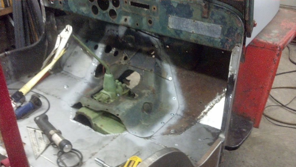

Slow going. I picked up an M-38 lower floor cover. Then I clamped the 3 cover assembly onto what was left of the CJ-3B floor and sprayed around it to mark the location. I cut out most of what remained of the hump and up into the firewall. Now the M-38 floor panels are temporarily screwed down and an empty transmission and transfer case are in place so I can build the remainder of the hump.

Where did the side panels come from? (1/4 front and rear)

I had the side panels from a previous project that stalled. The front sides are just run of the mill repros. The front angle is not correct so the fenders don't fit properly, adding another set of problems. The rear sides are custom made from Brian Hainer.
