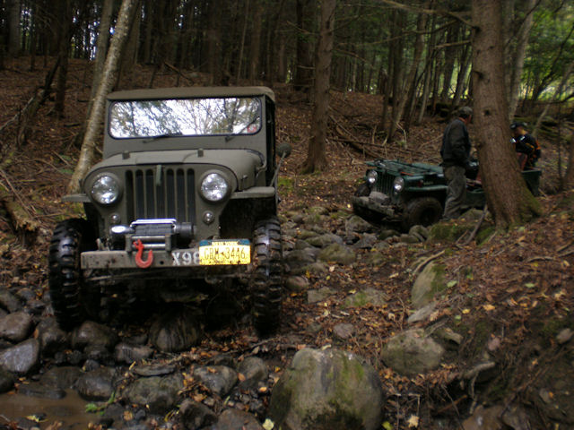

I went on a cool Willys Run today in Central NY state. I set my tires at 12psi and I'm happy to say they performed very well! May try 10psi next time.

That X98 looks to be in its element.  Nice.

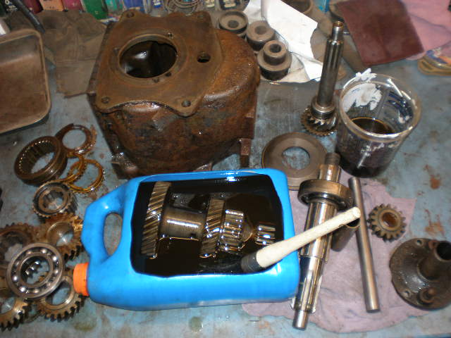

So, in June at the Willys Picnic I purchased a T90C for X98. I'm planning to put it together over the winter and have it ready for spring wheelin. I like to build transmissions with serviceable used parts because of the quality issues with some of the reproduction stuff. Unfortunately I'm out of good used parts. Anyone put a T90 together in the past year with new parts that actually work good? If so where did you get them? Looks like I'm going to need at least a 2nd gear and a small parts kit.
