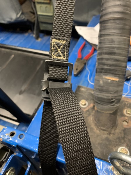

Thanks Doug, and Rus for the comments.  In the fifth pic where my hand is holding the flap to show the backside of the lock and also the slot for the lock arm to pass thru, if my memory serves me right, I JB Welded a huge thick fender washer on the inside for more strength to resist the lock from being pulled out.  I didn't look when making pics, so I'll have to check that out and verify for you.  The sides of the can are kinda thin, so I couldn't "weld" a piece in there..

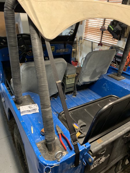

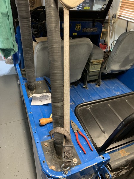

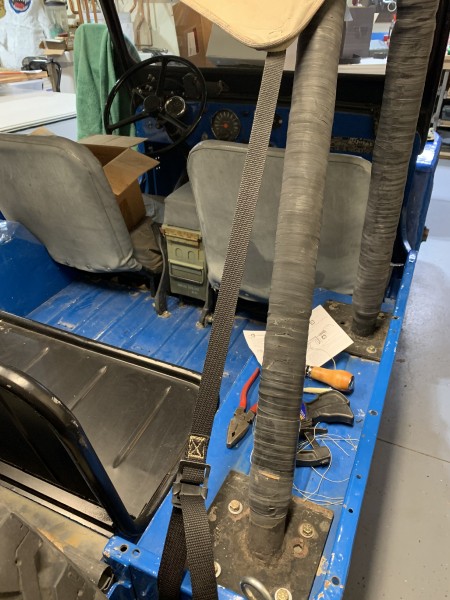

This past weekend, I spent a few hours out in the garage with the Jeep.  Didn't get a lot accomplished, but this was a project I needed to do for years.
The bikini top straps from New Life weathered the Idaho elements rather well, but finally began to break down
Enough finally broke off so I couldn't reach the footman loop any more, so to get a few more years out of it, I added the eye bolts to each side.  This year, one side finally gave up for good.

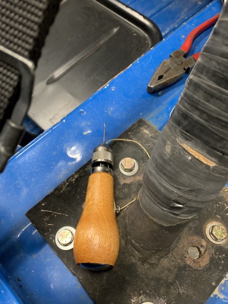

I bought and used this speedy stitcher awl in hopes that it would do the job.
It actually worked great.  I did have to buy the smaller needle than the ones that came with it.  The smaller needle came in a two pack and a good thing too - on the last strap, the first needle broke.  I only poked my fingers a couple times and none of them were bad.  I was probably out there a total of 3 or 4 hours.
I made the new straps a bit longer than the originals.  I want to find a way raise the bikini top a couple inches to get a little more head room.  It rests against the top of my head and if it's loose at all and starts bounce up and down - that gets annoying real fast!
I will be very thankful I did this come the summer.

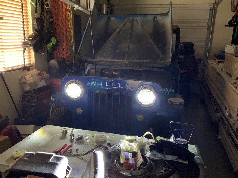

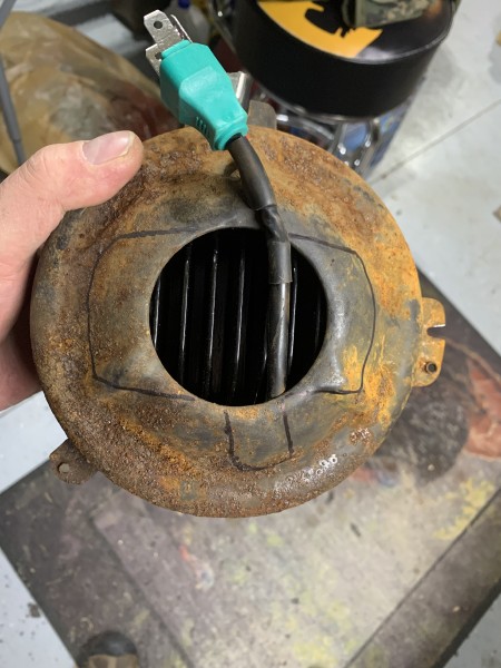

I've been working on this project for awhile - and it's not done yet, but I thought I'd post up some pics.

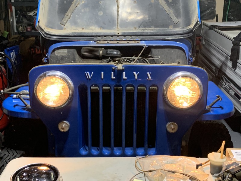

My wife REALLY likes driving the ole 3B, so I want to make it as safe as I can.  One of these days, it will be upgraded brakes, but for now, lights.

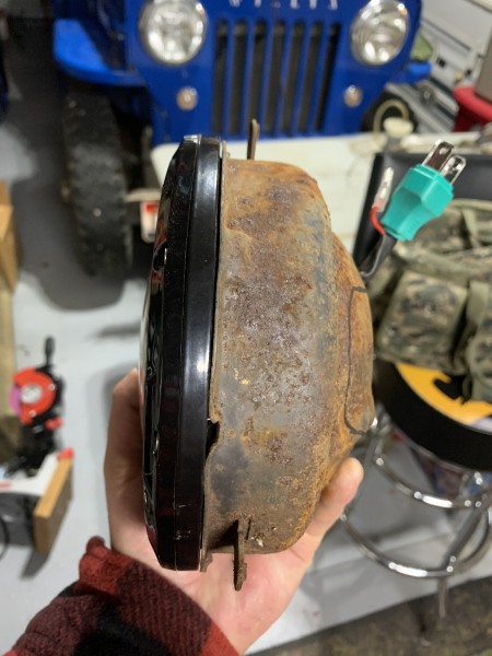

Original lights:

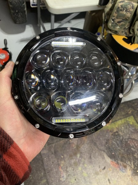

I bought these LED lights to replace the original:

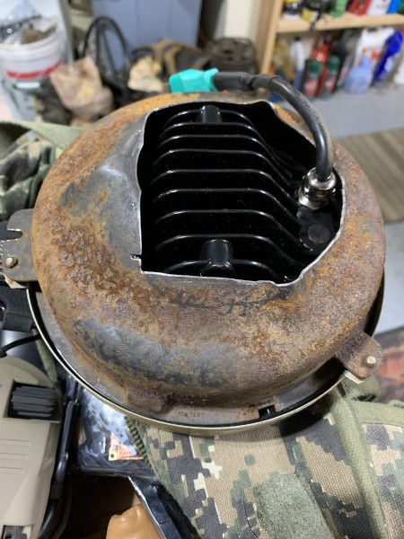

Awhile back, I bought some rough headlight buckets because I didn't want to modify my originals.  These LED lights were a REAL close fit.  I probably didn't have to cut for them to fit, but I didn't like the way it kind of trapped the wire and if those fins are to dissipate heat, then I figured they should be a little more exposed.  Here is the rough outline of what I was going to cut:
Here you can see that the LED light fits without cutting anything:

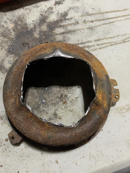

And here's what I ended up cutting out:
Here is after I smoothed out the edges:

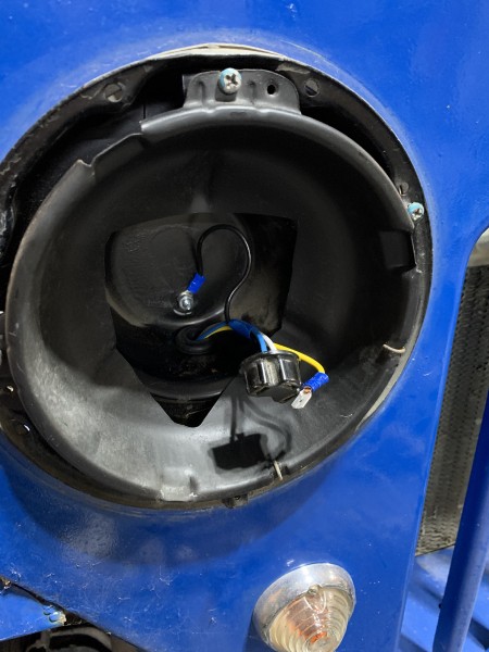

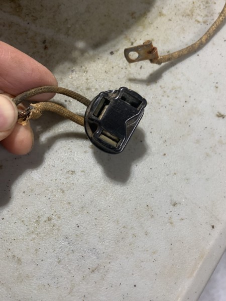

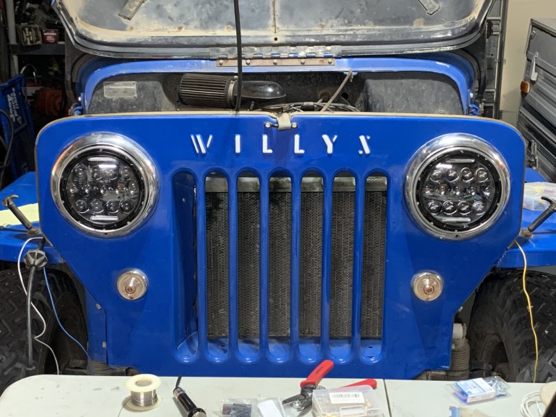

Next up was the headlight connector.  Luckily, the contacts were really easy to extract to clean up and solder new wires on:
Here we have it painted up nicely and the new harness in place:

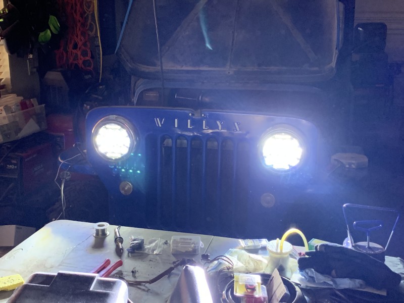

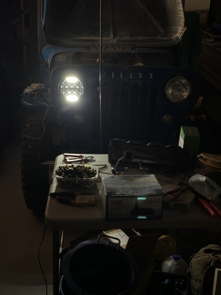

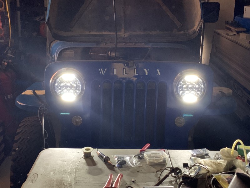

And a quick test of the daytime running lights:
Other side installed:
Daytime running lights test:
Low beam test:
High beam test:
I still have to wire it all together.  I'm trying to clean up my wiring harness as I go as well.  Had a small problem on the trail last year and don't want a repeat.  I'll be using waterproof relays to power the lights.  I'll post more when I get more done.
