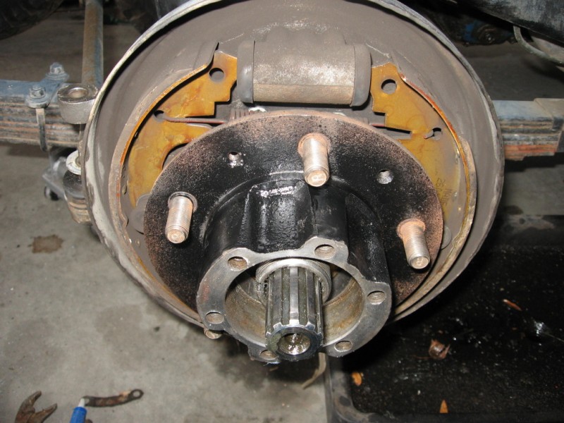

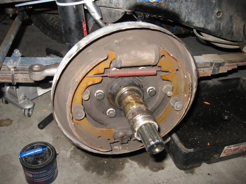

Here is some rear axle work.  I pulled them apart to check the bearings and seals.
A buddy of mine had a hub puller that he let me borrow
Hub removed

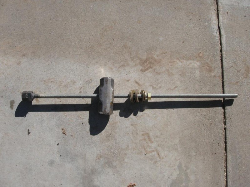

Now:  time to remove the axle shaft.  I ran around to several parts places to rent an axle removal tool.  I found one that was totally useless, maybe an 8-oz slide hammer, it did nothing.
Frustrated, I formulated my own plan.  The thing I love about having a welder is the ability to fabricate when necessary.  The nuts were the tricky part, I ended up taking an axle nut to a specialty place for comparison and bought two.  Welded them to a section of all thread, used a sledge hammer head, and created my own slide hammer.  I thing by the second blow the axle came loose.  Haven't used this tool in years, but it's still around!
Here it is going back together
And, another project in the books

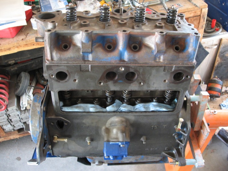

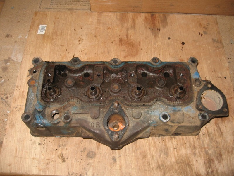

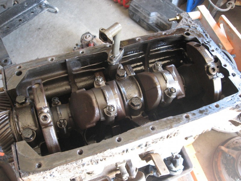

I knew it was time to do something about my engine when we were on a Jeep trip in the Boise National Forest and my friend Todd pulls up behind me during a break and gets out of his 3B laughing.  He was following me and said the road was just covered with blue smoke.
I had the spare F-head that came with the parts Jeep.  In order for there to be as little down time on the Jeep as possible, I would tear down the spare, get it machined and rebuild it.  Then the Jeep should only be down a day or two to do the swap.
Here is the spare before I started tear down.
Oil pan didn't look great
I had the block and head hot tanked and magna fluxed.
About the only break I caught during the whole rebuild is that there were no cracks in the block.
The engine had been rebuilt before, so they had to go .060 over on the cylinders and .020 under on the crank.
I used Joe's Motor Machine in Boise, for anyone in the area who might be interested.  He was in his 60s when I had this work done and he inherited the business from his Dad.  He said he mostly works on older stuff.  He recognized the engine as soon as he saw it and his shop just had this look that, yep, this is the right place!

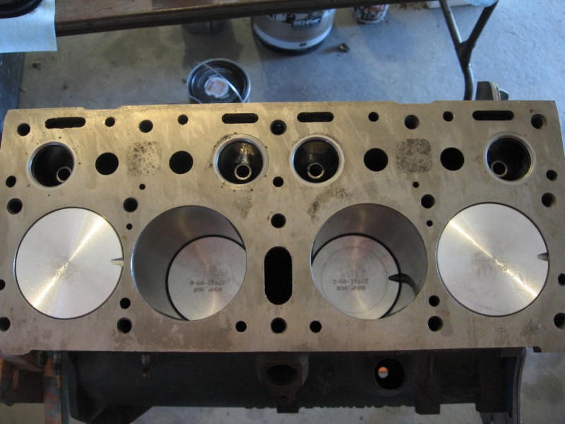

Here is the block fresh from the machine shop
And, reassembly begins
Cam is in
Fitting the crank
Getting a chance to play with some new toys to check end play
Installing the pistons
And... they're all installed
Distributor installed
Starting to look like an engine again!
Ready for paint
Painted
And finally, the old with the new:

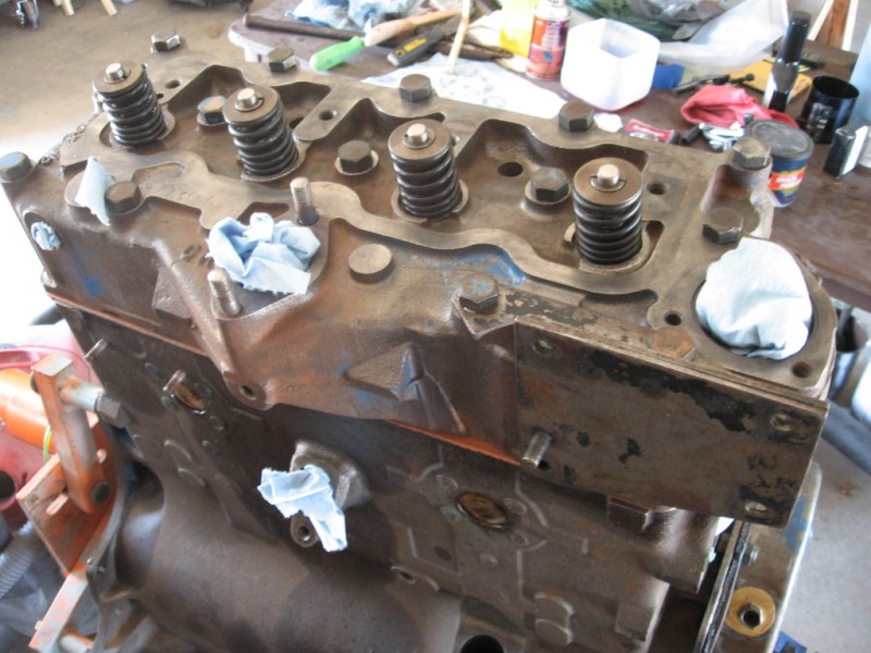

It took about 6 months to rebuild the engine.  Probably was at the machine shop 4-6 weeks alone.  Then, as I was building it up, I had a lot of questions, problems, and parts to buy.  Finally, it was time to swap it out.
Starting to remove the front clip
Used a come along to pull the engine
With the old engine out of the way, I took the opportunity to clean up the firewall, something that always bugged me.
I also took this opportunity to install a heater under the dash
OK, enough stalling!  Time to install the new engine
Also put a alternator on at this time
It was finally in and ready to test!   This was somewhere around the week of Thanksgiving, 2012.
I had some issues upon start up.  I cranked her some with the coil wire removed to get some oil pumping.  After I connected the coil wire back up and tried to start it, it just cranked and cranked and cranked.  Even to the point that the battery go a bit low.  I blame that on the choke, the choke cable is hard to move sometimes and I think that I didn't have the choke pulled all the way out.  Anyway, I boosted the battery with my truck, jumped back in the Jeep, pulled on the choke, and the cable came out further than it had the previous time. Hit the key and it almost started.  Hit it again and it was running.
However, there was a terrible rattle.  The only reason I didn't shut down the engine immediately was that I could tell it wasn't something major, and I was busy looking for the source.  Turns out that I had forgot to tighten the 4 fan bolts into the water pump.  That was an easy fix.
After some timing and idle adjustments, I was pretty much in awe at how quiet and smooth the engine ran.  The old engine was starting to sound like a diesel.

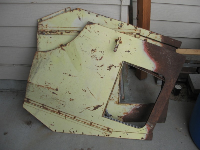

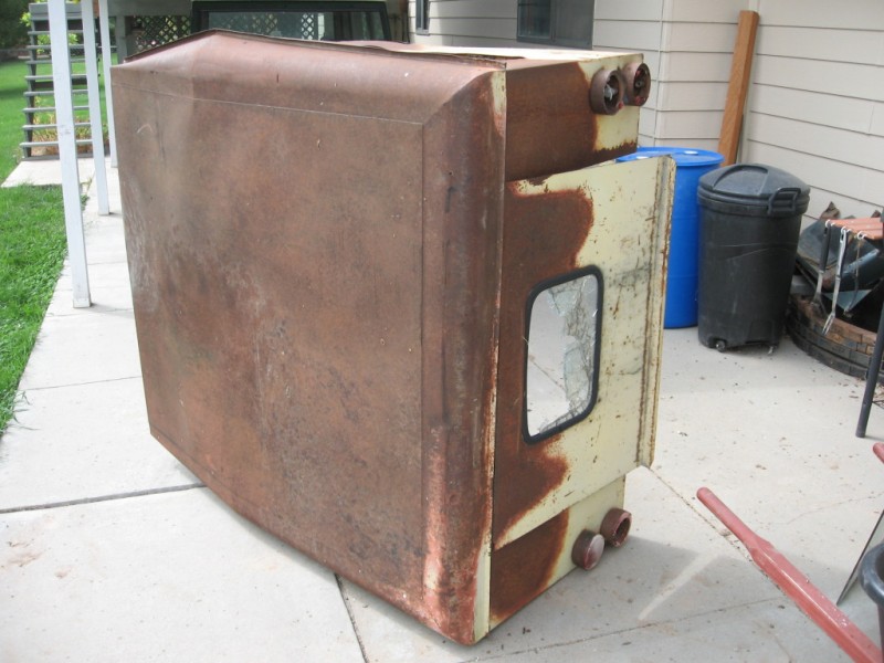

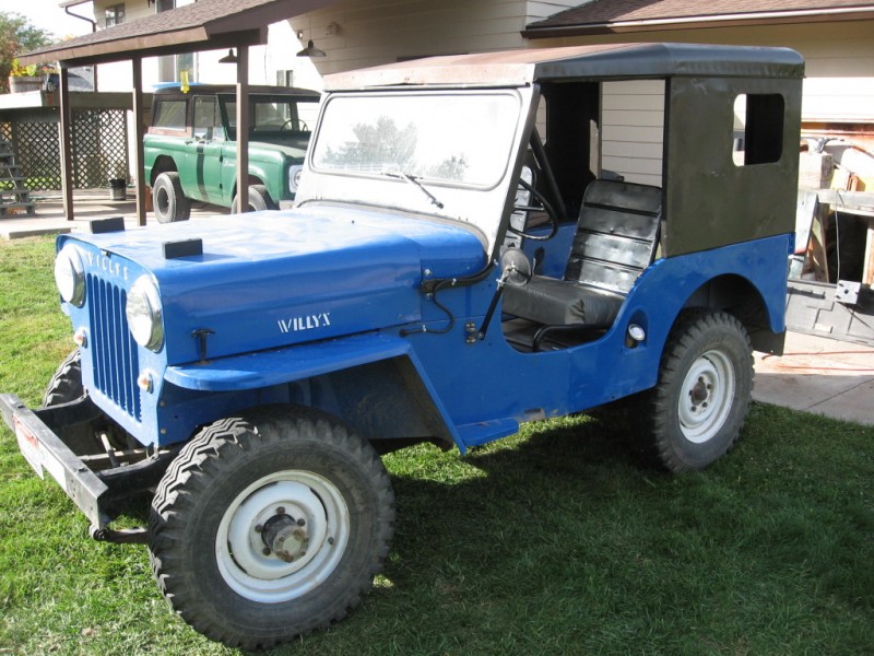

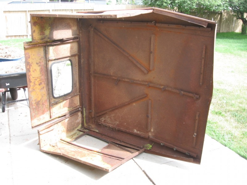

Something else that I had in the works at around the same time as the engine rebuild was a Koenig hard top.  You can see it in some of the pictures.  It was an on going project of several years.  I got the top for a steal locally, finally something that didn't cost an arm and a leg AND that I didn't have to drive for hours to pick up.  The catch was that it was for a low hood Jeep; I'm not sure if for a 2A or 3A.  I kind of figured a 3A because for some reason I believe that the tub dimensions of a 2A were slightly different.
It wasn't much to look at to begin with:

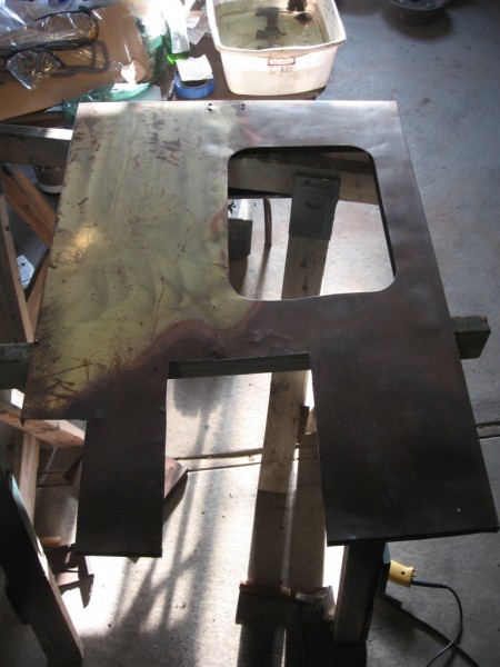

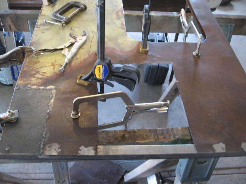

The passenger side was rusted through in sections.  I had to cut out and replace the bad parts.
Here I have a piece of square stock clamped on to try to keep everything from warping.  I was not entirely successful in that endeavor.
Here we got the new panels welded in and ground down.  And put on the Jeep for a quick test fit and to see how it looked
View from the back
And, painted.  I used Rustoleum Hammered Black.  This paint didn't hide nearly as many imperfections as the can led me to believe
The driver's side was similar, but not quite as bad.  Here are both sides sitting in place
The top needed no work other than paint.  However, I had to adjust my windshield to get the right measurement so the top would fit correctly.  I couldn't get the right measurement, no matter how I adjusted it.  Advice from the CJ3B Bulletin Board told me that I would have to bend the windshield frame arms slightly.  I kind of wish that I had documented that for posterity.  I removed the windshield frame and placed it on the ground.  With glass still in it, I parked a tire of the Jeep on it to hold it in place.  Then I used a 4' section of pipe, slid one end over the end of the windshield arm and tweaked.  I had no idea what I was doing, but I did know I was going to crack the windshield.
Whatever I did, I did it right the first time and when I reinstalled the windshield, with original glass still in 1 piece I might add, I was easily able to get the correct measurement from the top of the windshield frame to the back of the tub.
If you're ever going to do a project like this, do yourself a favor at this point, and enlarge the windows.  SOOOOOO many blind spots.  You can't see anything beside behind the doors and very little behind you.  If I was in traffic and had to change lanes, I'd flip on the turn signal for 30 seconds or so and then start to ease over and listen for a horn.  I HATED driving with the top on.
