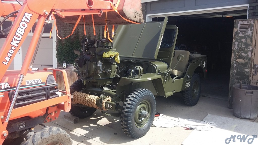

« Reply #8 on: November 19, 2019, 03:14:11 PM »
Tim, you didn't do it that way with the tractor by yourself did you?  I can't imagine not having full control of a hoist right next to the engine while trying to guide it out.  I can see why you would need to remove the grill doing it that way.  I'll bet Rachel was thrilled with the oil stains on the driveway! ;) >:(

« Reply #10 on: November 19, 2019, 04:32:01 PM »
Hi Tom,
Yes, I do it this way by myself.  I am pretty competent on the tractor.  I do have a soft touch, but do have to jump out a few times during the pull to reevaluate the situation.  I put them back in the same way.  I will say, I'm far more careful when messing with the Green 3A.  Don't want to scratch it, you know.
I did make a big mess.  I bumped my oil drain pan with my jack.  I was in too much of a hurry.  I was scrubbing concrete for almost as long as it took to pull the engine.

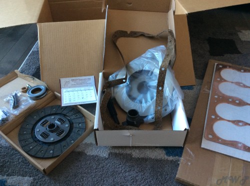

Ok. I ordered my parts from Walck’s 4 WD and i just got them.
So here is what i got;
Clutch kit 8 1/2 (clutch disk, pressure plate, throw out bearing with collar )
Spring carrier return clutch
Pilot bushing
Oil pan gasket
Rear main seal kit
Clutch alignment tool
So i should be able to do it.

« Reply #13 on: December 16, 2019, 07:56:53 PM »
 :(  NICE pan gasket! What'd they do, wad it up and stuff it in the box? I'd look that over closely, especially where it was folded. Any sign of cracking, I wouldn't use it. Tell them you want another, shaken, not stirred.  BW

« Reply #14 on: December 16, 2019, 09:00:45 PM »
Yea, but he got a free calendar! ;D
