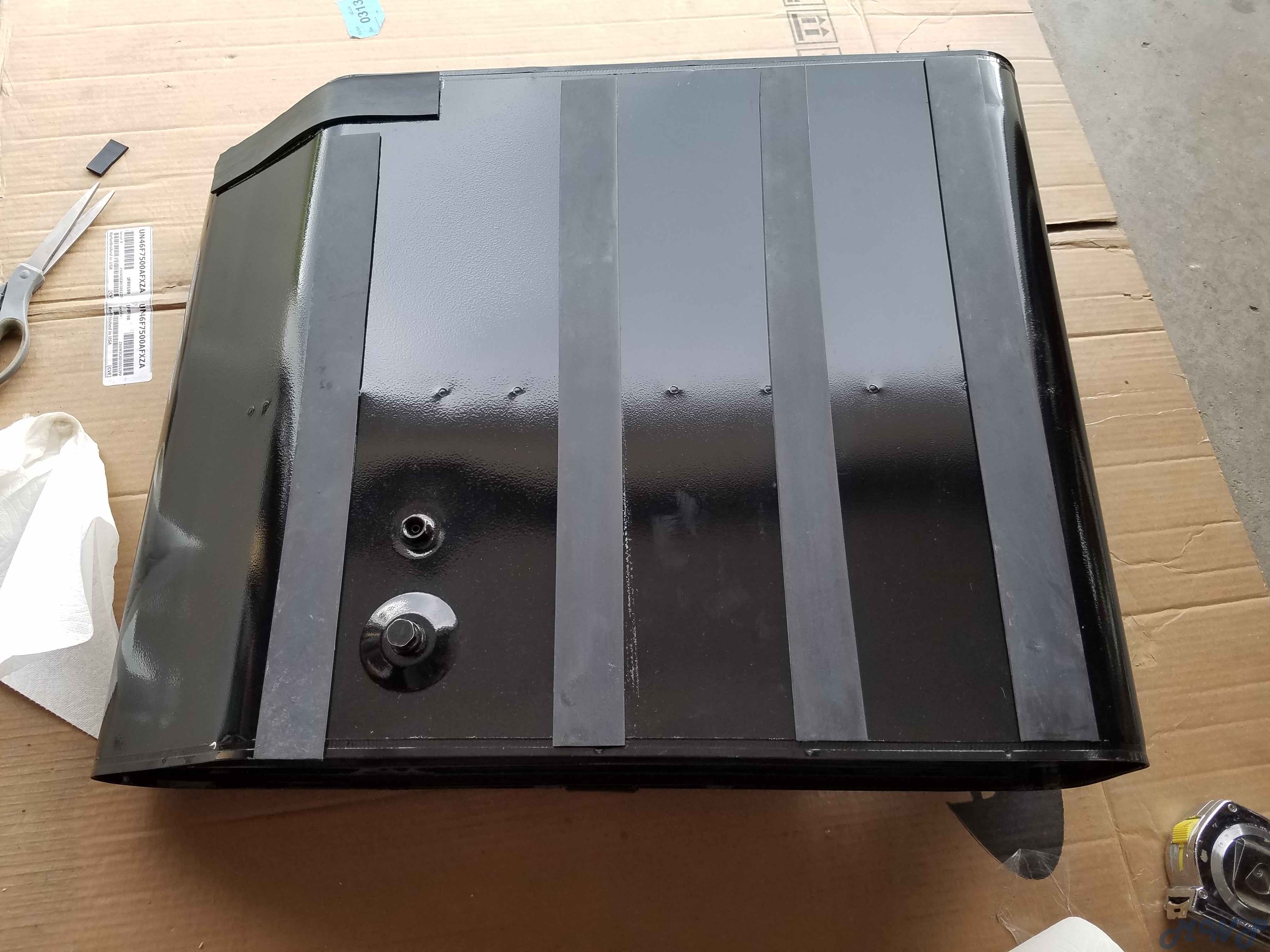

It seems like the more I work on my CJ3A the more I get confused on where some of the parts on it came from and that also has to do with my gas tank. I am looking to replace the tank due to the fact it doesn't have a fuel gage sending unit on it or any hole to install one. When I was pricing out a new tank I noticed that all the tanks have the fuel line attaching to the tank next to the frame rail. The tank that is on my 3A has the fuel line attached near the edge of the body, opposite side of where it should be. There is no other holes in the tub to indicate that the tank fittings go through the tub near the frame rail...
So anyone know what tank I might need or do I need to modify the tub. The tank also has straps going from back to front holding it in.

Where my fuel line connects.. near the body edge

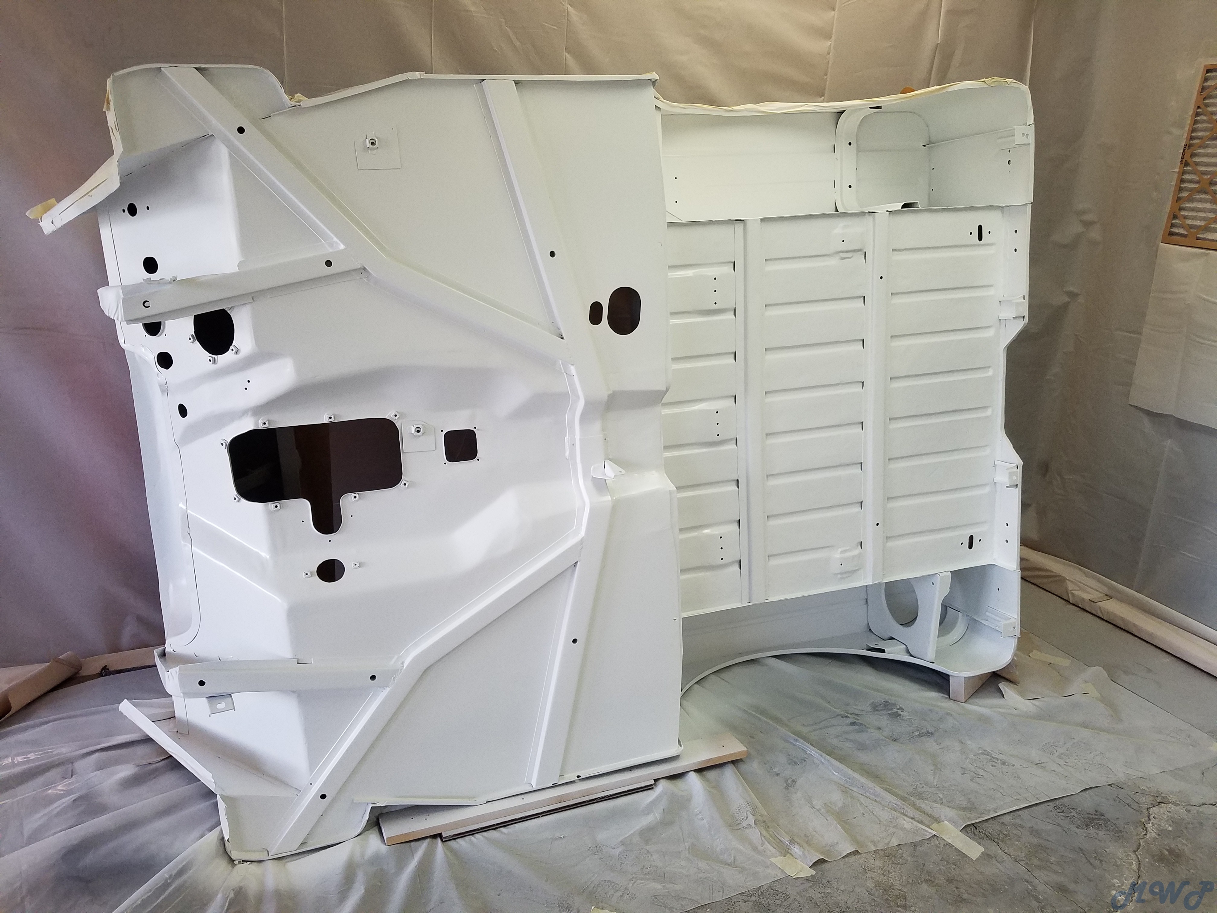

Your floors have probably been replaced if you see no holes in the driver side floor.  The tank in your photo is not original to your 3A.

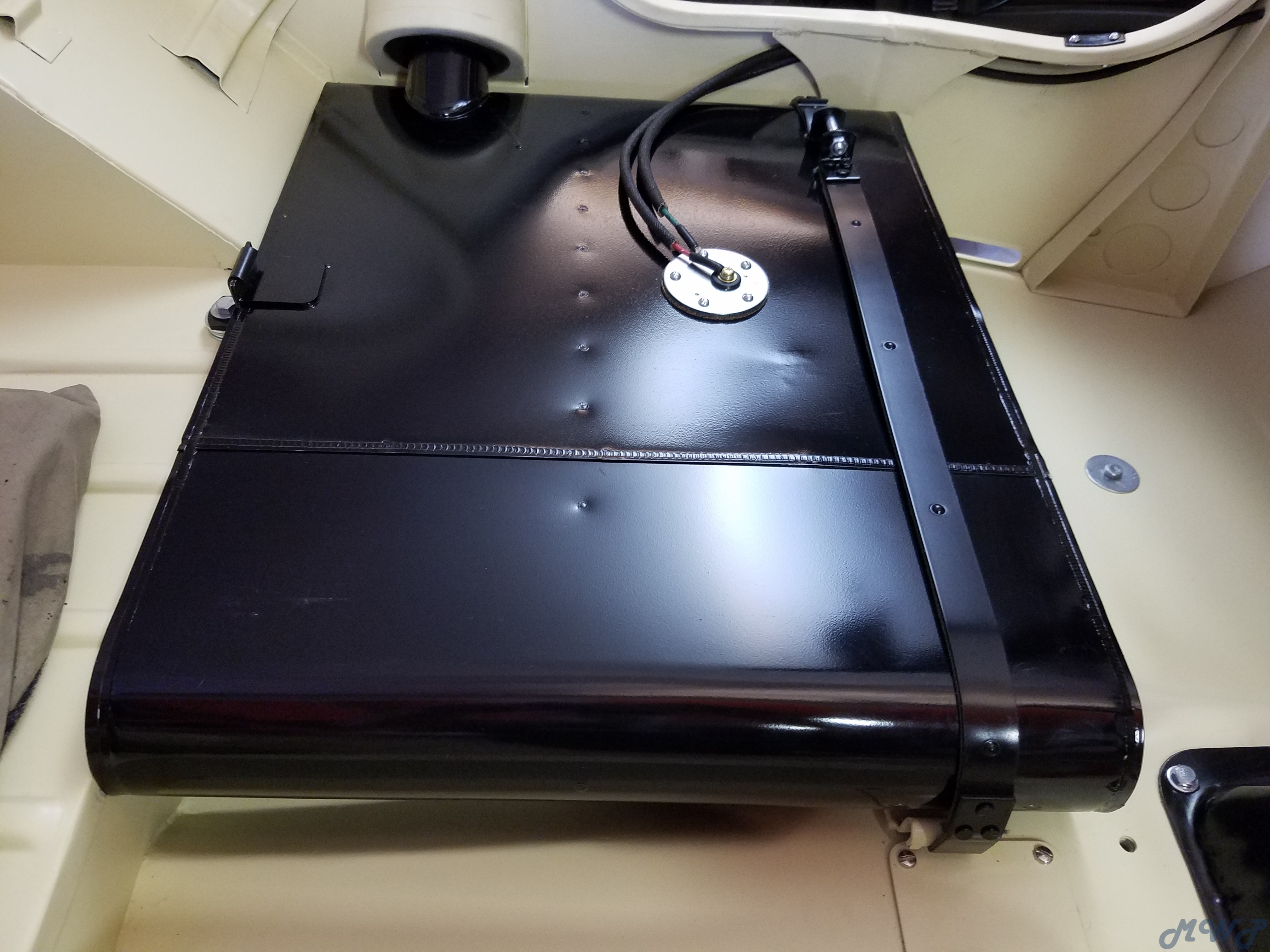

Here are a couple photos of the original style tank.  This is a reproduction purchased from Walck's.
They are pretty close to original, but the fuel connection and drain are not in the exact original position.  You can see the holes in my tub.  I had to elongate them to accommodate the new position of the fuel connection and drain.
