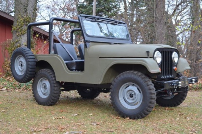

The shadows were playing games with my eyes on the initial images.  I clicked on the links to view additional images.
This looks like the same grill with most of the jeep disassembled (noting the M38 headlight guards are missing) I may be wrong.  It shows a better angle under the front:
Here's a side angle showing the hub covers (I think I see three bolts holding the cover on (multiple photos of the wheels with 4 lugs also):
I don't have any documentation on the DJ jeeps so I can't really comment on the claims made by the author.
