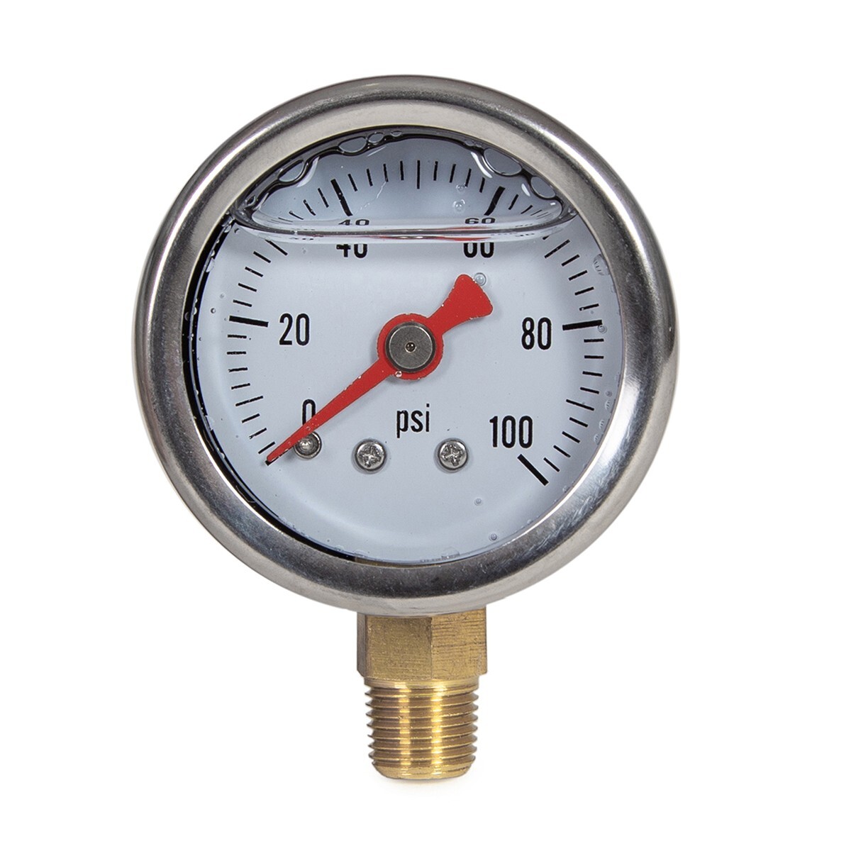

I have a hardline connection from my gauge to the oil galley.  It is a used gauge I bought.  I have good pressure 20-40 but at times the gauge drops to zero for 10-15 seconds and then back up for a few minutes before dropping to 0 again.  I've thought about getting a new gauge but wanted to check here for any ideas first. This is a newly rebuilt engine and I don't recall seeing this issue with the previous engine.

I would get a good, liquid-filled test gauge and connect it directly to the block.
$12. on e-bay

Thanks Chuck, I have a new gauge coming today.
