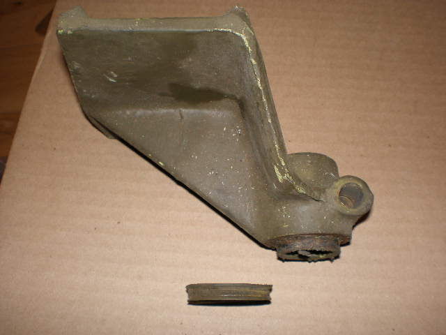

There was a change. I'm still not sure if my bracket "sleeve" is correct but there did appear to be that protrusion there - whether sleeved or originally cast. The parts diagram for the M38 also shows a spring washer (which I don't have) and the thicker boot/seal that I do have in my pic. Those are parts #9 and #10 in the M38 diagram. If I can find a suitable spring washer replacement I think it'll be OK.
I am still a big fan of Walck's, but the "Bell crank kit 7/8" CJ2A, CJ3A, CJ3B, CJ5, CJ6, DJ, FC 150, M38, M38A1 Part Number: 920556" is another part that should not be advertised as completely suitable for the M38.

Here is an M38 bellcrank bracket. It's difficult to see in the photo but the shoulder is part of the bracket and that's where the seal rides. The seal has a metal "spring" around it to provide more pressure on the sealing surfaces.

Interesting. My seal does not have that spring. Is that the "6. SPRING, TENSION, SEAL" in the M38 Fig. 24 above? Fig. 24 seems to show #6 above the #7 seal but maybe it was meant to wrap around it?
I'm confident I can make my set-up work and I'm pushing this now solely out of curiosity. See what happens when you guys allow this step-child 3A variant to hang with the 3A family?�

The M38 was designed to "ford".� �Assuming all the seals are correct and fresh, would this be more water tight?

I suppose the M38 would be more water tight with the added seal and spring. I know when I sloshed through deep water in my 3A last year I saw A LOT of water squeeze out of the bell crank when I regreased it.
