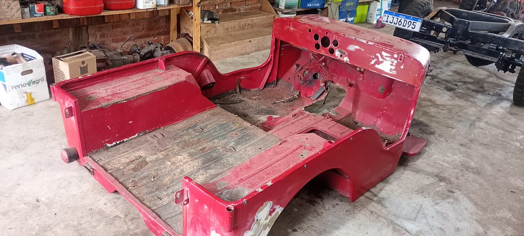

Last week, we decided that the best course of action would be to take the body off, since we had to repaint the engine, replace the gearbox with a T-90, and repair the rotten floorboards.
Since we already had removed some stuff, this was a pretty straight forward process, took us around 2 hours to do so.

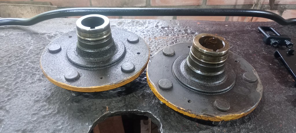

After doing so, dad decided to also take out the 11" drums out of the back, to be replaced with the correct 9" drums, and... well, all i gotta say, is that i cringe every time someone praises "old school" mechanics and belittles new ones... what i'm about to show you is the work of some professional, with a shop, that worked in this jeep in the past.
Removed rear hubs, note anything wrong?
Yeah, both sides installed with the keys in the wrong orientation...
Not pictured, is the fact that the rear backing plate/bearing retainer assembly, had been done in the wrong order.... they put the backing plate first, then the bearing retainer, and the shims last... both rear bearing are trashed, and the shafts had around 1/4" of end play each...

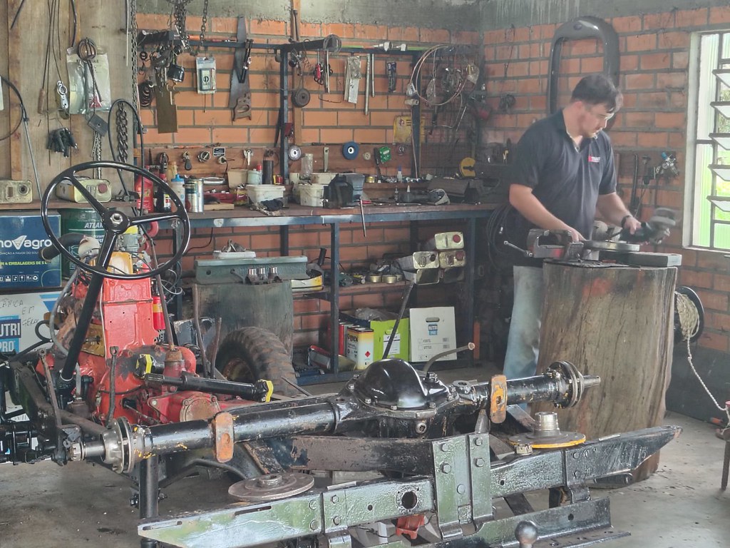

Dirt and grime on the drivetrain, we washed the whole frame with some heavy duty cleaners.
I ended up not taking many pictures of the rear axle rebuild, but it was a mess... like i mentioned on the last post, the hub keys were assembled backwards, but the insides were not much better. There was play in the side gear splines, between the side and spider gears, and between the ring and pinion (improperly set up). We took a lot of parts from the yellow axle that came as an extra with the Jeep.
We also made a case spreader to help in the process.
That's me in the background, cleaning up the backing plates. The rear brakes were a take off from one of our other Jeeps, so everything was new, just needing some new paint.

We placed and bolted down the axle to the springs, to align everything and weld the new spring hangers in place.
We then started on the front axle. We knew there was some play on the hubs/drive flanges, but surprisingly, the wear was on the axle splines rather than the hubs.
I completely disassembled both ends down to the spindle in one side, and got to the knuckle in the other. Removed the old grease and cleaned everything for reassembly.
(Don't ask me why I started taking pictures of things on the floor)
On the driver's side, we found a badly worn Rzeppa joint, but luckily, our local junkyard had 2 good outer shafts we used to piece together a good one. On the passenger's, there was a Tracta joint in good enough shape, that we're using as is (Or, I forgot to check the junkyard for a tracta outer... We'll go back next monday and see if we can find one with less worn splines)
So far, the front axle is way better than the disaster at the rear, there is no excessive wear or play, so on the diff itself, we'll just change the oil and seals. On the hubs, we'll have to replace the seals, and both bearings on the driver's side, along with the spindle bushings. On the passenger side, the bushing was missing and the spindle worn out, but we had a spare at home to replace it.
I still have to finish disassembling and cleaning the other knuckle, but things are going smoothly so far.
