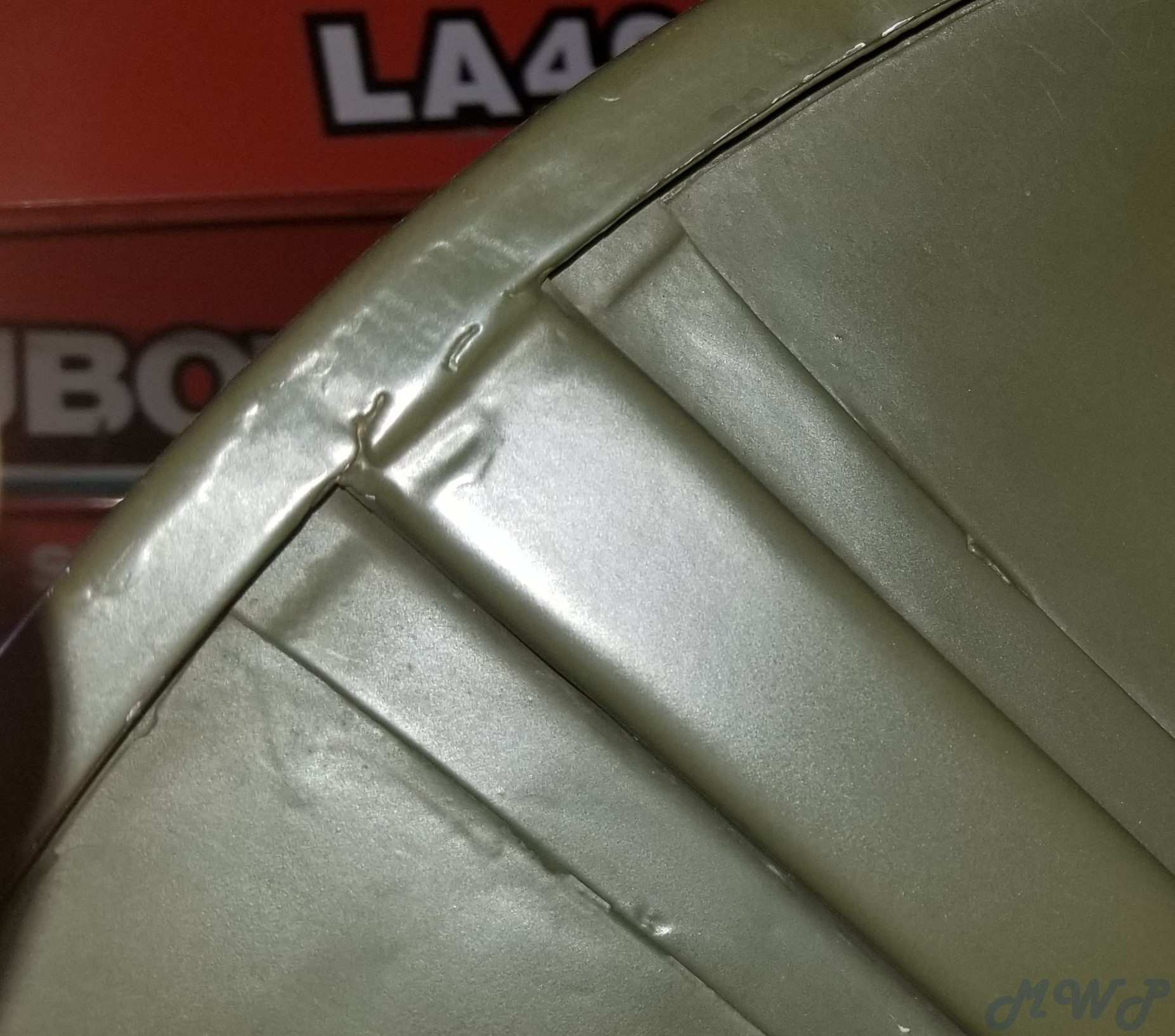

The brace that sits inside the door needs rebuilding. Can someone post a picture of the brace, specifically where it meets the edge of the door aperture so I can see how it should look.

Hi Percy,
There is really not much to it...

That's great thanks, I just wanted to make sure it looked right and that helps a lot.
