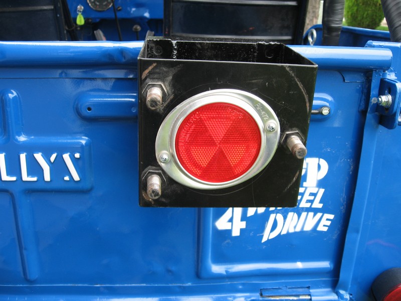

I came very close to using a tractor light.  Lawrence Wade used a similar light on his for years as a back up and I was leaning that direction (incl. LED versions).
But I found this on the auction site and the price was too good to pass (see attached below).

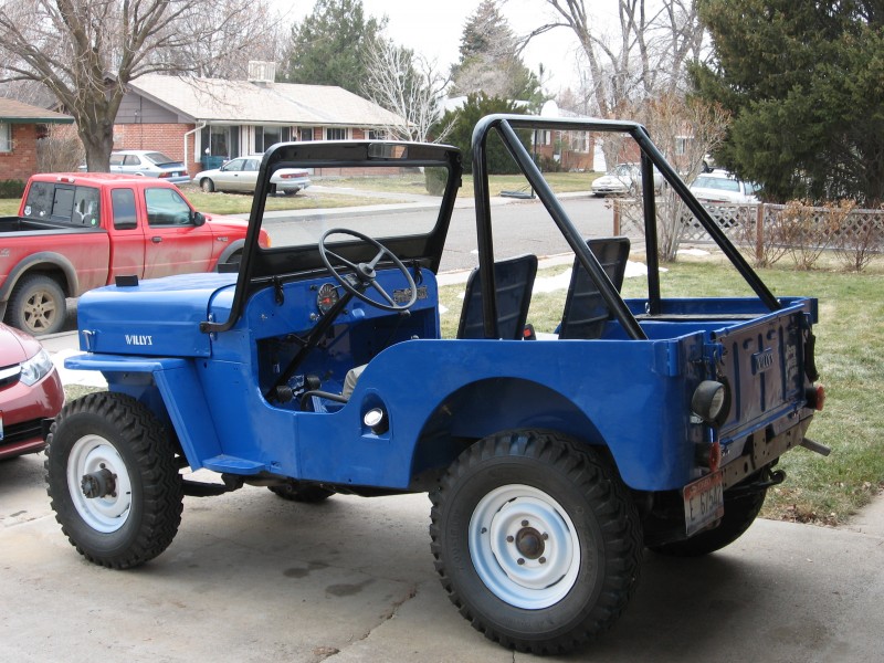

While I love the look of an old Flattie with no rollbar, I decided to trade looks for at least the illusion of safety and installed a roll bar.
Soon after this, we moved into Boise.  This move provided quicker and easier access into the Boise National Forest for me.  I ventured out farther and farther, and each time I was out, there was always something that I'd decide needed to be changed on the Jeep.  Little projects soon started to happen.
I bought and installed a drawbar.  No real need for it, but decided no Willys was complete without one LOL

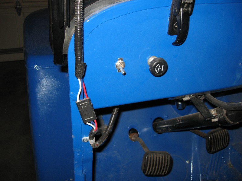

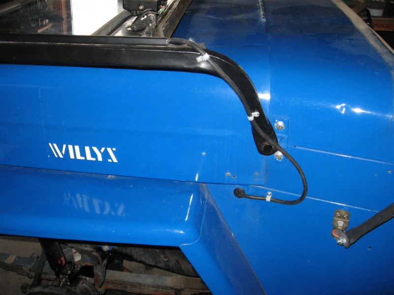

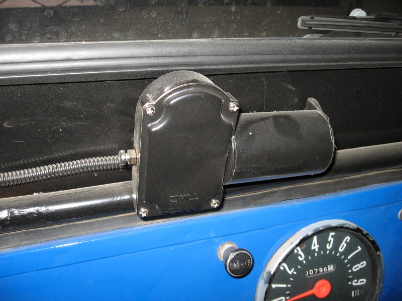

I sprang for a good marine wiper motor for it
And went through a series of different disconnects for it so I could lay down the windshield.  From not great:
To slightly better:
To the final design
That doesn't need to be disconnected at all.  You can also see that I installed the shakiest mirror of all time.

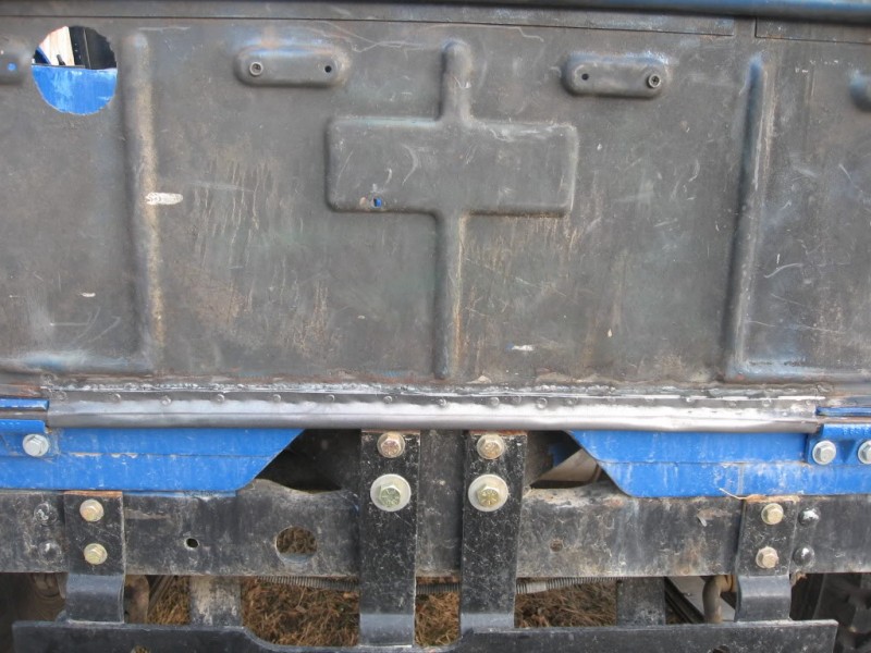

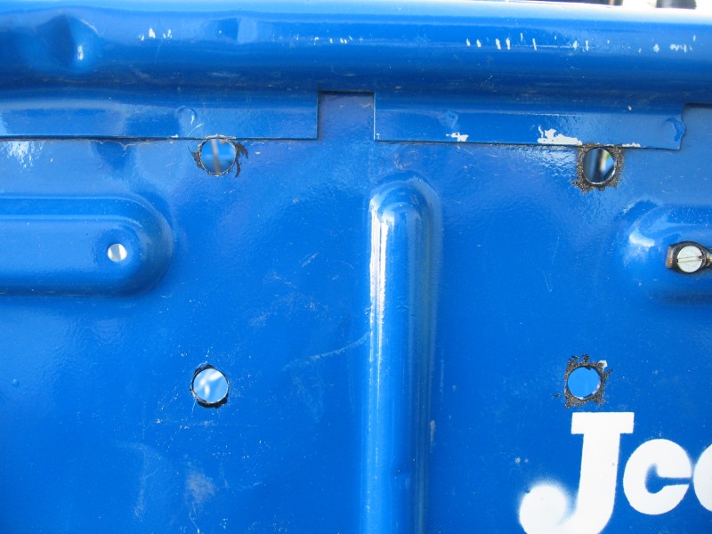

Somewhere around the spring of 2011, I saw Goose's sweet 3B had a spare tire mount on the tailgate, and I thought it looked so much better than the side mount.  So, I started calculatin' and came up with a crazy plan that I should have known wasn't going to work.
I welded a piece of angle iron onto the spare tire mount. That rests on the top of the tailgate and I thought may take some of the weight off of the bolts going through the tailgate.
It was kind of difficult for me to drill holes in this after all of the body work I had done, but I got through it.
Removed the chains and bolted the tailgate shut
I needed to add spacers, I just used wood, hoping it would not tear up the tailgate too bad.
I cut a piece of oak for the inside, to hopefully help spread out the stress/weight
The finished mount
And a couple shots of it all done

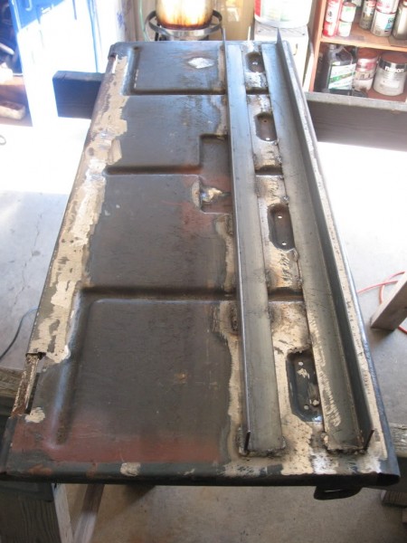

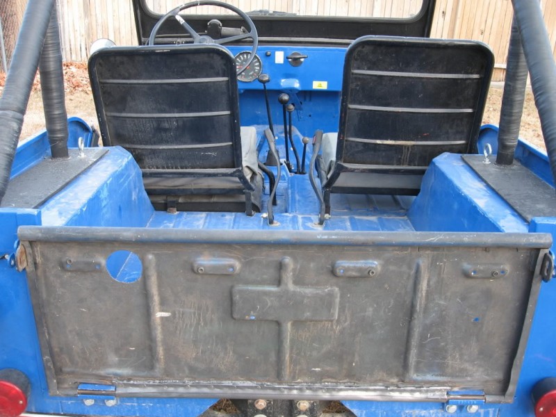

I still had the beat up original tailgate.  It was pretty rough.  Here was my first look at it as I started working on it.
I cut the bad section out of the bottom
I hammered out a replacement out of 18 gauge steel I had laying around.  It looks like complete garbage, but is solid.  I tacked it on.
A test fit revealed it was not perfect, but would work since it would be bolted shut.
Here I have the rest of the holes closed up
I welded some angle on the inside.  I wasn't screwing around with a small piece of oak this time....
Here's another shot of it and I have the holes drilled for the tire mount and anti-vibration dampener

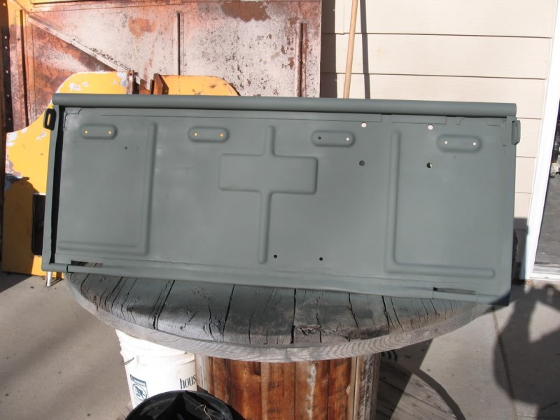

Etching primer on
And a test fit
I decided to rattle can it flat black rather than try get out the paint gun and try to mix up more paint to match.  I thought the black was a nice contrast and most of it would be covered up with a spare tire and eventually a Jerry can.

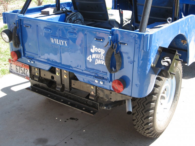

And, the tire mounted
I finished this sometime in 2011, I believe.  As of today, November 19, 2020, this tailgate is holding up well and is still in use.

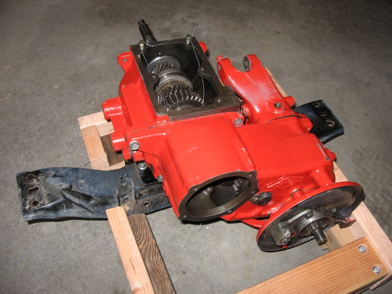

So, I did get slightly out of order here.  The tailgate project was 2011.  The T-90/D-18 rebuild was during the winter of 2009, I believe.  I finally got tired of popping out of second when I was motoring down Rocky Canyon Rd back into Boise.  I used some winter downtime to remove and rebuild both the transmission and transfer case.  I had very detailed photo threads made, as a compliment to Rick Stiver's guides.  I also had his T-90 rebuild video on VHS.  I lent that to a guy and never saw it again.  I literally have over 220 photos from the rebuild, but I'm not going to go into great detail.  I heard there are rebuild videos out there on youtube now.  If you're interested, my D-18 writeup was published on the CJ3A Page tech tips section https://www.cj3apage.com/index/Tech_Tips/DougHD-18TransfertCase.htm
Anyway, on to some photos!
Here are both pulled from the Jeep
You can see I had the old style transfer case

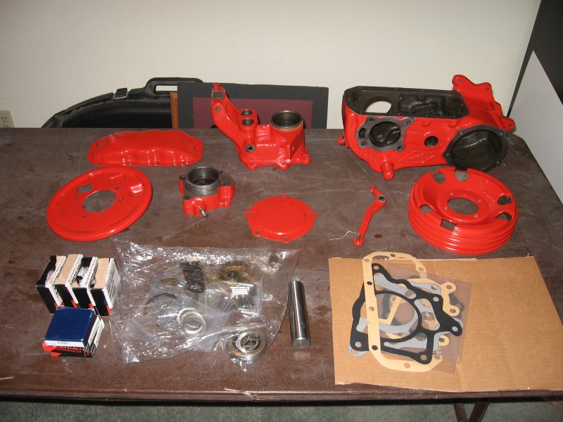

Here they are, separated and on the bench
The T-90 spilled it's guts
Case cleaned and painted
T-90 reassembled
D-18 getting ready for the same treatment
D-18 disassembled, cleaned, painted, and awaiting reassembly

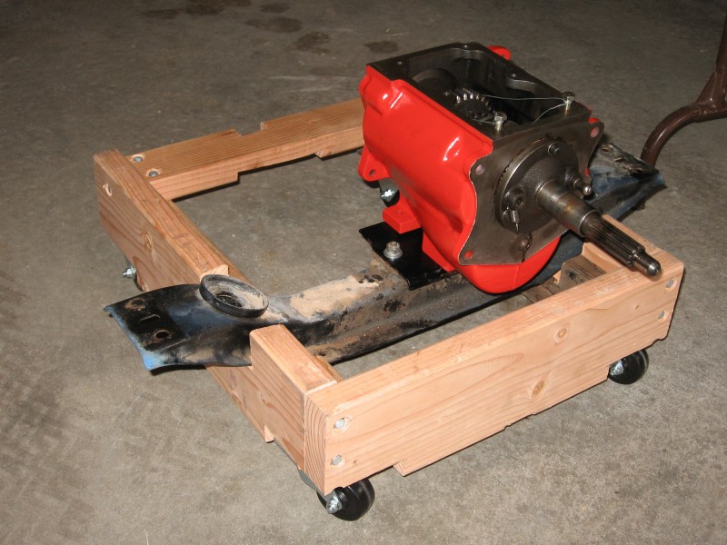

Here is a stupid little dolly I made to wheel this stuff around.  I'd be able to wheel it under the Jeep and still get a jack underneath.
T-90/D-18 mated back up.  You can also see I swapped the old style parking brake to the one that is supposed to be on a 3B
Install shifter temporarily to make sure everything works as it's supposed to
Here we are heading outside to install
Both worked like a champ.  No issues besides some leaking.

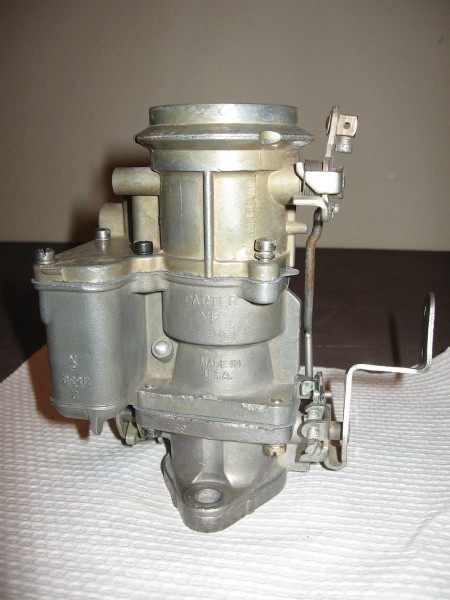

I rebuilt a spare carb that I had laying around using a Carter zip kit.
I've got millions of pictures of this project as well, but will just provide a few below.
Original:
Just before I started to tear it down
Here are some of the little parts you end up working with
And all cleaned up and put back together.
I didn't really notice any big changes in performance or how well the engine ran, so the old one probably wasn't too bad.  One day I think I'll send the spare off to be professionally rebuilt - get the bushings checked/replaced.

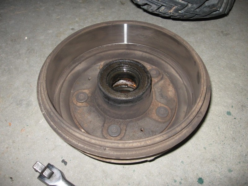

By this point in the rebuild, I'm into late winter, 2012.  The major things I hadn't touched yet:  engine and axles.
We would tackle the axles first.  I wanted to get into them at least as far as the wheel bearings and make sure everything was OK.

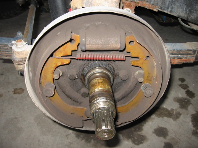

Just getting started.  Locking hub removed:
I went and bought the spindle nut socket so I could do this right.  However, I soon found that someone had been in here before, and they had not bought a spindle nut socket.
That thing looked like some sort of wicked circular saw blade
I was expecting to see a U-joint in here, not a bunch of ball bearings!  This was when I learned about Bendix vs Spicer front axles.  There's even another kind called Rzeppa.
