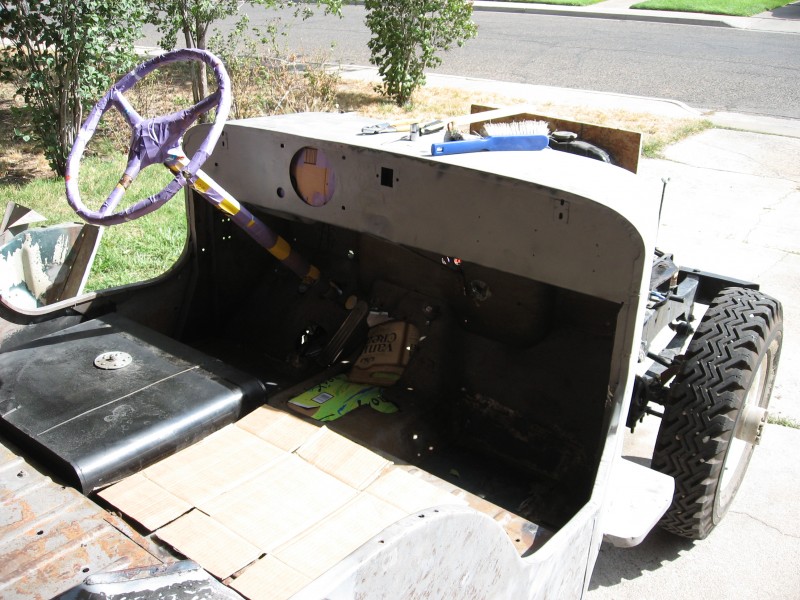

I think the pictures are starting to get slightly ahead of the story.  The body work I did in the previous post was done in August, 2007.  I had known for 4-5 months already that I was heading back to Iraq in September for another 4 months.  My goal was to drive the Jeep down the block and back before I left.  The race was on!

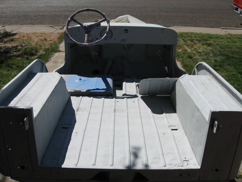

I painted the underside of the tub with POR-15 as shown above because the plan was once the tub was on the frame, it was not coming back off for a long time.  The day finally arrived.  My buddy came over and we set the tub onto the frame.
What a day that was!  It was starting to look like those other CJ3Bs that I had spent so many hours looking at on the CJ3B Page!  It did start and run, but did not yet drive.

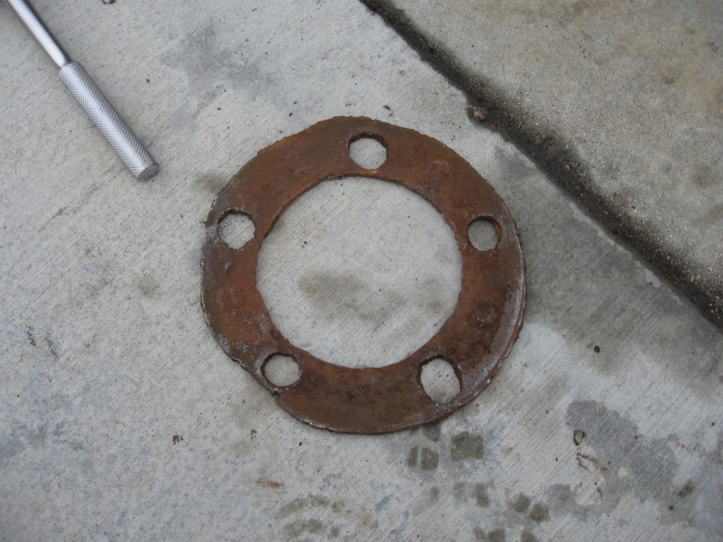

I ended up swapping out the original axles for the axles from the donor Jeep.  The original axles that came with my Jeep had 11" brakes installed, but probably not correctly. between the backing plate and the drum were these spacers:
This caused the lug nuts to not thread on far enough, and it didn't seem safe to me.  Rather than fool around with it, I decided to swap out the axles and go with original equipment for now.  The 11" brake hardware was set aside and saved.  Here is a picture of a Frankenstein that I had sitting behind the house with all the spare parts.  Not a great pic, but if you look close, you can see the lug nuts do not thread all the way on.

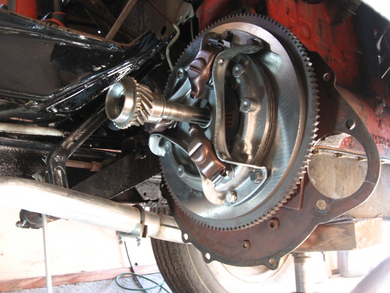

I finished my second tour in Iraq and returned in January 2008.  I didn't waste much time getting back to work.  First up:  figure out the clutch issue.
I dropped the transmission/transfer case and pulled the bell housing
I bought a new clutch and pressure plate and made sure the pressure plate was properly adjusted.  What a bone headed move not doing that in the first place!  I also took the opportunity to have the flywheel resurfaced.
Upon reassembly, it worked like a champ!!

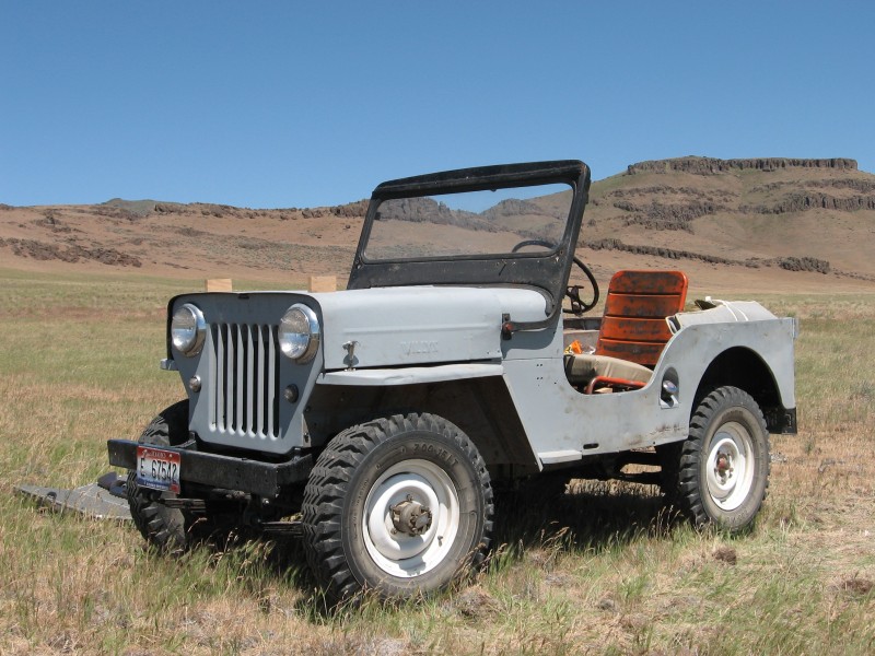

I had two sets of tires, and neither was road worthy.  I did some comparisons on how they both fit and looked.
And then I went and bought a new set of shoes for the old girl
They're still on the Jeep 12 years later.  They've worked well, but I'm going to swap to a radial one of these days, and hopefully go with 16" rims.

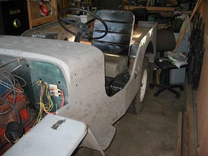

Well, on to paint prep.  As much as I hated to, I began to tear the Jeep back apart.  Of the body, only the tub would stay on the frame.
If you look closely on the radiator shroud, you can see the remnants of the battery terminal welding itself to the shroud from the story at the beginning of this post.
My makeshift paint booth.  Little light, less ventilation, what could possibly go wrong?

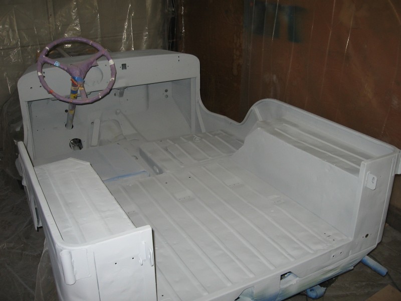

Here we are, just about ready for etching primer
Re: My 1963 CJ3B Build Thread
« Reply #22 on: November 15, 2020, 04:53:56 PM »

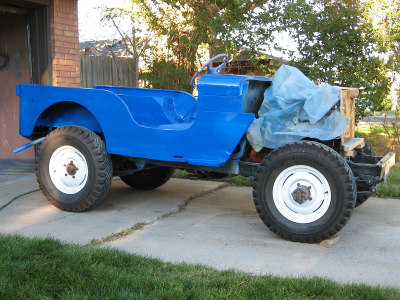

OK!  First up:  Etch Primer:
« Reply #23 on: November 15, 2020, 05:00:24 PM »

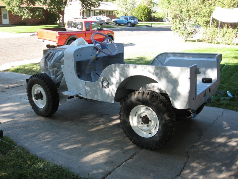

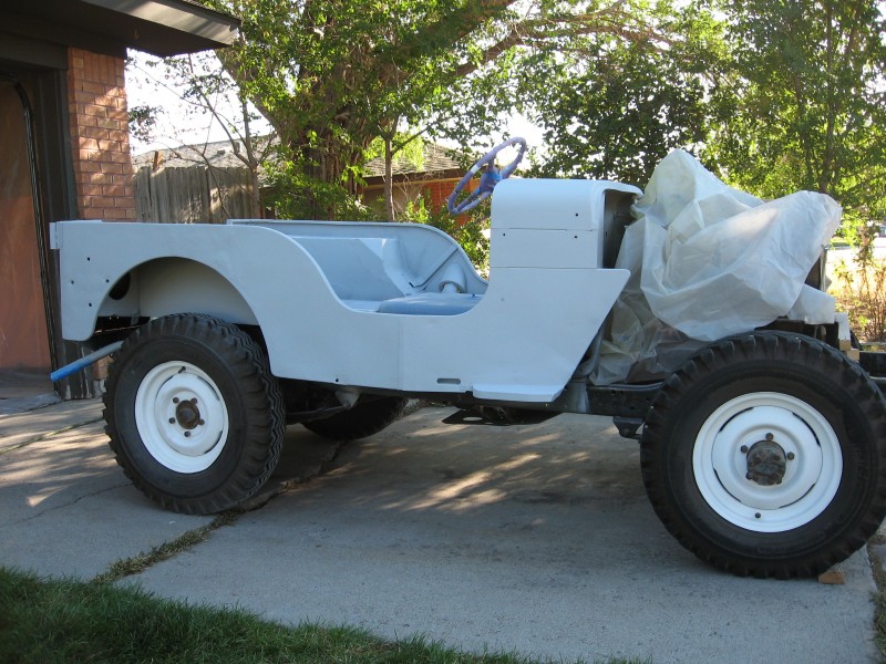

Then on to Fill Primer.  From what I understood, fill primer was supposed to fill in some imperfections.  Evidently, my definition of an imperfection is VASTLY different than that of a professional.  That stuff didn't hide anything  :D
Each step, after I'd spray the tub, I'd let it dry and then move it out of the garage and spray the rest of the parts.
And even though it still wasn't it's final color, it was nice to see it all one color

It was finally time to spray color.  I went with blue because there was one on the CJ3B Page Owners section that I really liked.  The blue that I ended up with is several shades lighter than I really wanted.  It's now been 12 years since I sprayed this Jeep and I've been considering doing it again, either some sort of dark forest green or a desert tan, not sure yet.  According to the original paint/trim code tag, which miraculously was still on the firewall, paint code was "228" which appears to be "Parade Blue."  That color is MUCH darker than what I sprayed.  Also had a trim code of "200"
I still remember how I marveled when that blue paint came out of the sprayer and started laying on that light gray primer.  Finally!
« Reply #25 on: November 15, 2020, 05:51:59 PM »
I could barely contain my excitement while I let all the parts dry.  It was finally time to put it all back together and see what it looked like!
Well, it was done!

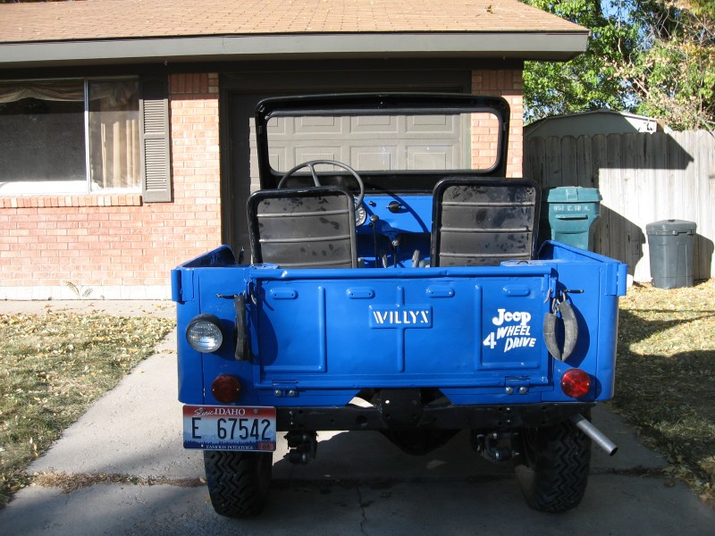

I see you went with the small backup light.....
« Reply #27 on: November 16, 2020, 10:45:13 AM »
That's looking good!
Thanks Rus!  I was sure excited to get it to this point.
Yeah, picked that light up at the local feed store.  I'm sure its for a tractor, but I figured:  close enough!!  The thought was I could turn it on if I ever had to back up at night, I'd be able to see.  It does work in the handful of times I've used it in 12 years, but I'm thinking of swapping most all lights over to LED, so I'm going to be looking for something a little different for backup lights!

« Reply #29 on: November 16, 2020, 12:24:25 PM »
I came very close to using a tractor light.  Lawrence Wade used a similar light on his for years as a back up and I was leaning that direction (incl. LED versions).
But I found this on the auction site and the price was too good to pass (see attached below).
