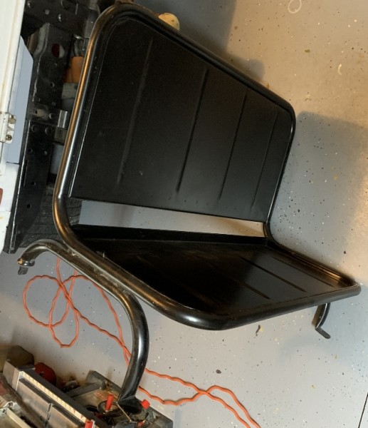

A year or two ago I picked up an aftermarket rear seat locally for my 3B.  Not sure where it originated.  I bought the rear seat spring clips from Walck's.
The other day, I went to install it.  My first observation is that I thought the spring clips would hold the seat in place a little tighter.  It stays in place, but the slightest upward pressure and the seat pops out of the clips.  Seems like it will pop right out if no one is sitting in it and I'm bouncing over some dirt roads.  Is that to be expected or is something else wrong?

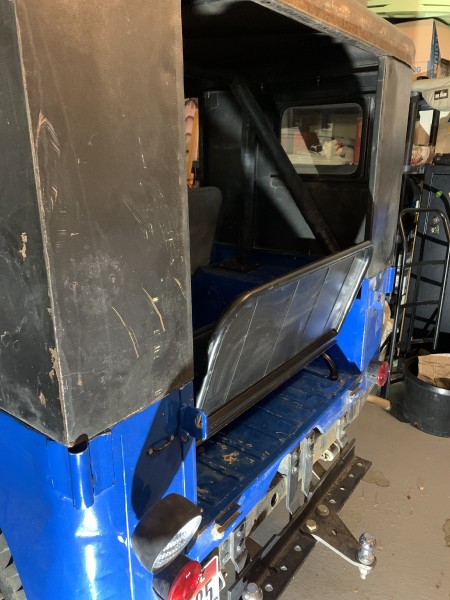

Additionally, I find that the seat sits too far back. It won't fit in place unless the tailgate is down/removed.  Not a huge deal to cut the welds holding the seat frame to the mounting brackets, move it forward, and re-weld, but I wanted to ask the question before I went ahead and did that.  Is this normal with the current aftermarket seats?  The tub is all original off a 53 CJ3B.  Thanks!

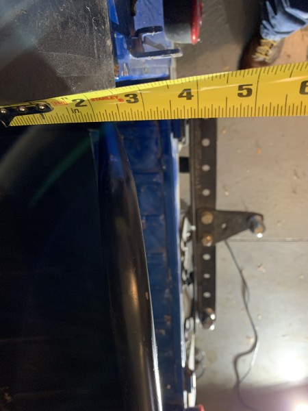

In that article, there's actually some good images (follow the links - they take you to some more good images for comparison).  One shows where the transition from bottom frame bends up to the backrest frame.  You can see there about where it is welded.  My frame measures (crudely from a yard stick) from the outside edge of the front leg back about 8"-8.25" where the bend begins.  I can  get better measurements but will take a while.

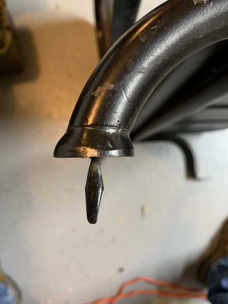

Here's an image I took a while back for a jeep owner who had those rear leg "pegs" missing.  You may be able to build up the material but as is, it seems a bit fragile.

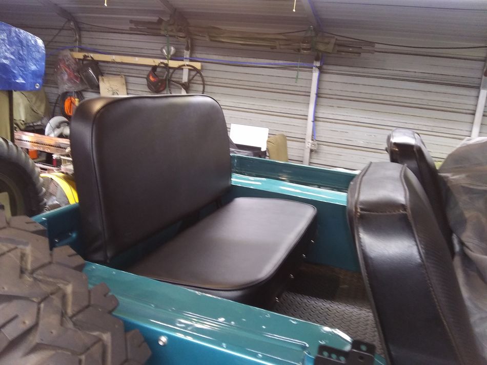

I found this photo on the CJ3B page http://www.cj3b.info/RearSeat.html that shows that the leg should be more vertical that your reproduction. Would raise the seat back and stop it from hitting the tailgate.
This is interesting as I need a rear seat for my '64 project and had thought about one of the reproduction seat frames. I think I will look for an original one now.

IMO ... as Chuck said "more vertical"... and it "looks longer" too to me, which would push the back forward.  Chuck's pic example appears to follow Russ's measurement on "frame to mount placement", further forward on the frame, (how I would make it fit inside) with some significant welds there possibly from "re-attachment"(?), as well as unless an optical illusion from the angle of the pic, the seat back seems "more towards 90 degrees" to the bottom seat than the new frame below.  I wonder if Doug's frame was for SWs with room behind them?  Also look at the front feet where with this one the flat pieces face upward while in Doug's pic they face downward???  Downward seems like it would help prevent the "bounce out" issue.  This will be interesting to find out the "results".

Awesome!  Great information guys.  So glad I got a great "deal" on this seat  ;D ;D ;D  Now I know why he got rid of it!
The pegs on this reproduction seat seem puny compared what you guys are showing me.  Now to decide whether to try to build them up or spend the $$ on the new ones.
Agreed that the rear legs seem way short on this one compared to the ones in the pictures and that the seat appears to be attached too far back to the legs.
By the time I'm done with this, I will have more work into this one than if I had just fabricated a frame like I had planned!  ;D ;D ;D

This update is worth mentioning (plus I wanted this new information to show on our forum in case someone is in need).  There is a member on the CJ2A Forum, from South Africa, making these pegs.  It's machined and assembled/ welded.  Looks very stout and rugged.  Read about it here:
