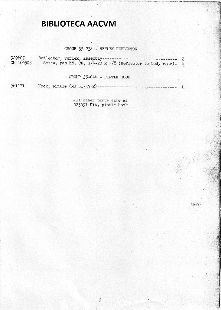

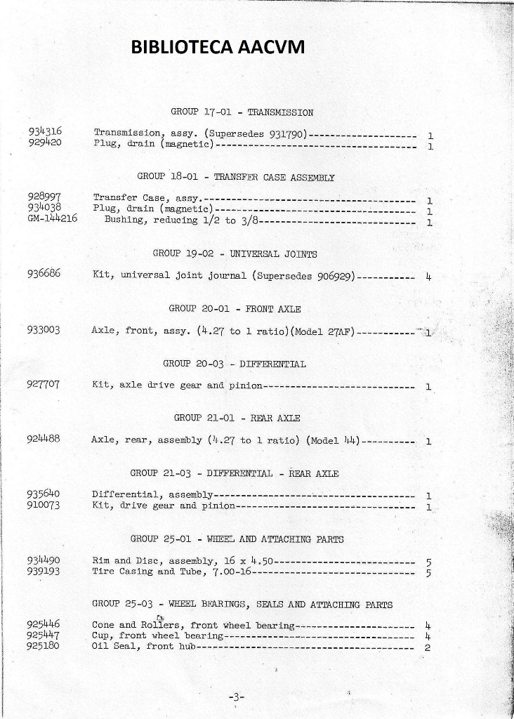

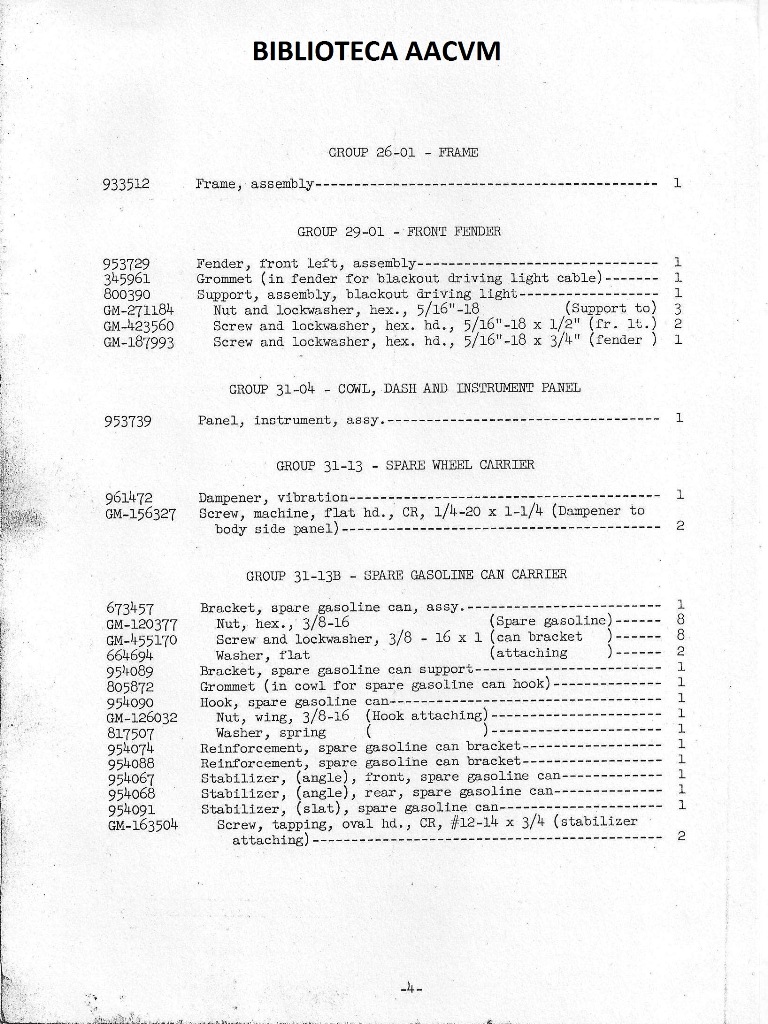

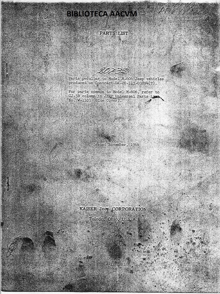

Over the years that I have been connected to the M606 jeeps, I still do not understand what they confuse with any other militarized cj3b outside the factory or by a customer.
 It is very simple to know if it was militarized at the factory since it is simpler than everyone believes.
I hope this info a little light to this topic.
Peculiar parts List
If your high hood cj3b jeep was not manufactured between 1963 and 1967 and does not have these peculiar parts, it was never and will not be an M606!!

According to my records, until DOD 10-1966 the spare tire arrived installed on the right side as well as a jerry can holder.
After DOD 10-1966 it would have arrived with the spare tire and jerry can holder in the reinforced tailgate like M38 jeep.
