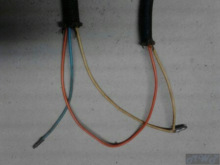

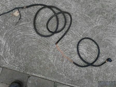

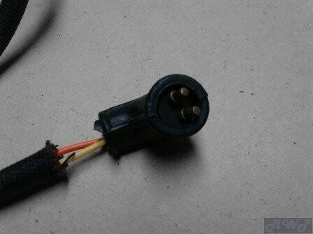

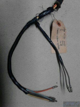

Here's the complete OEM rear harness assembly:
Here is the front of the harness:
Here is the area near the left rear taillight:
Here is the tail light connector end:
Here are the frame clips:

« Reply #19 on: October 04, 2019, 09:01:22 AM »
Hi Ken! Thanbk you very much!
What is the lenght of the loom??  ::)
