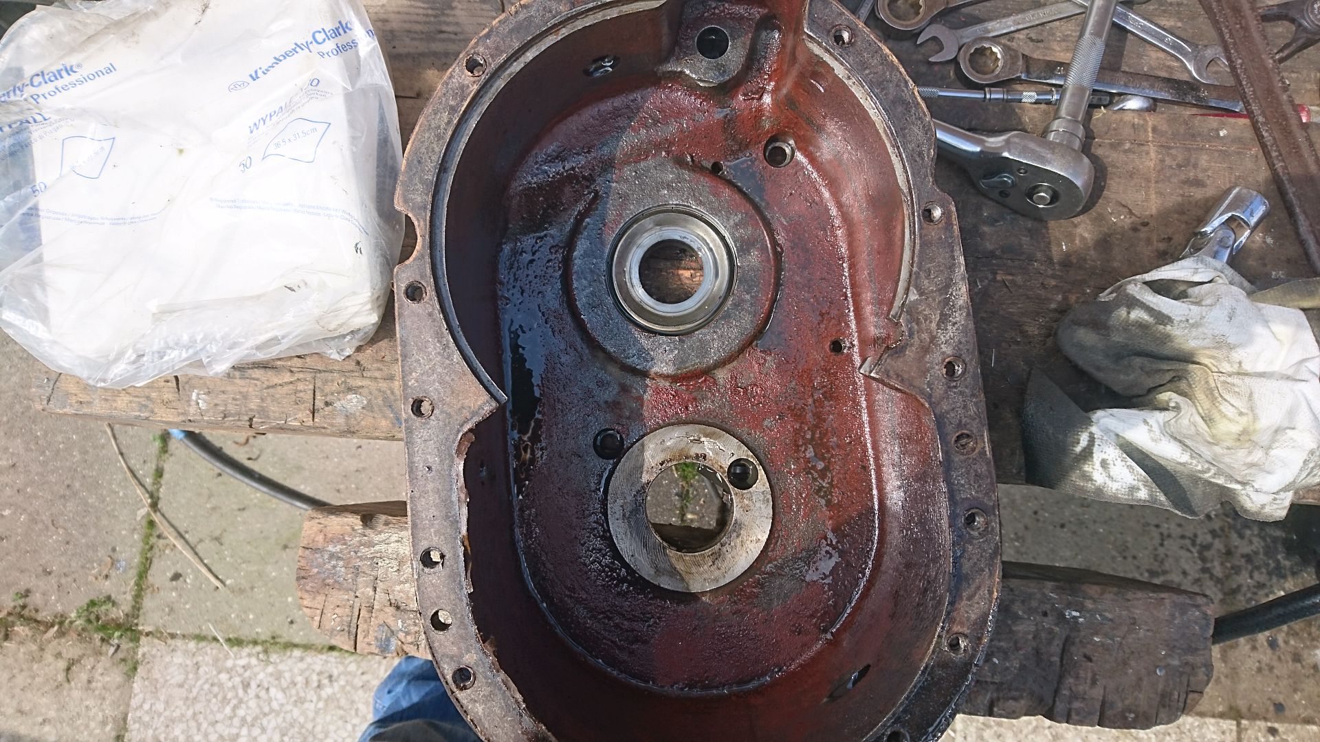

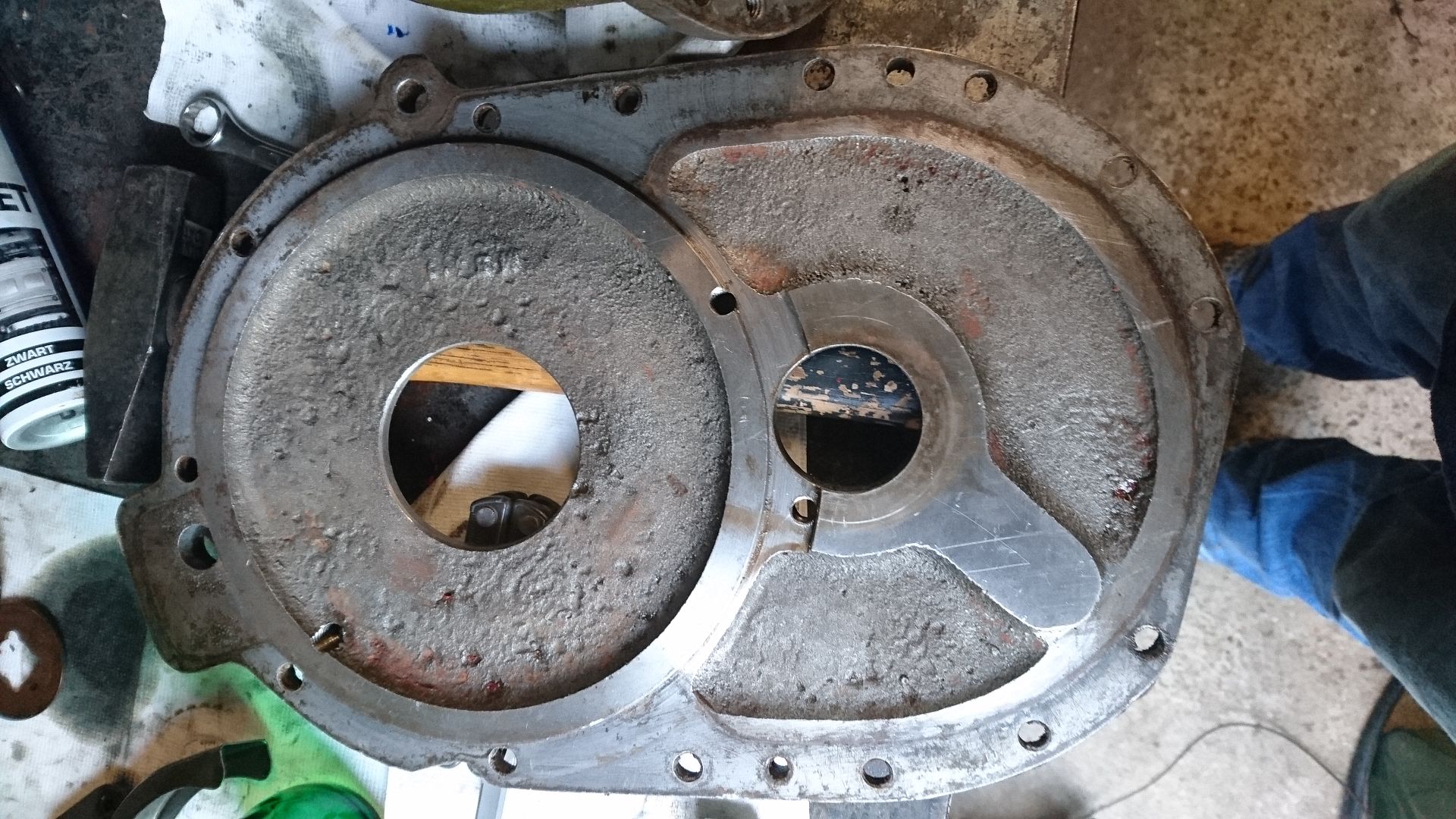

Finnaly some inside footage of the magical mystery box on my CJ3a
Here it is in all it's glory, the worlds fist Jeep rockcrawler Atlas box is what i call it
the goose with golden egg 8-)

No it is: Engine, T90, mysterybox, Transfercase
So it's able to be engaged in 2x4 or 4x4 hi-lo does not matter because the T18 that engages 4x4 hi or low is after it.
Here is the complete assembly:

I really like that. Does it have any identification markings on it?

There is a small number 3 stamped in the case and that is it. No manufacturer name or anything else.
