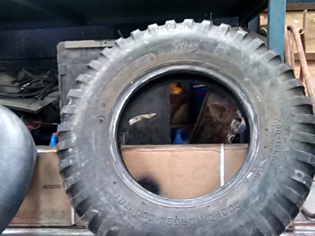

This past Saturday I drove over to PA for the Annual Redball Jim Thorpe Militaria & MV Parts Swap Meet. It is the first show of the year for me and gets the enthusiasm back up after the winter. I also stop by Walck's in Bowmanstown for a visit with Carl and Dan. I picked up a "new" NDCC tire for X98's spare at the show. Looks like it has never been on the ground, the rubber is soft, and is probably at least 20 years newer than my current spare tire.

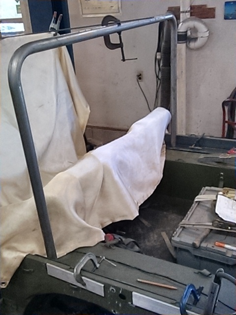

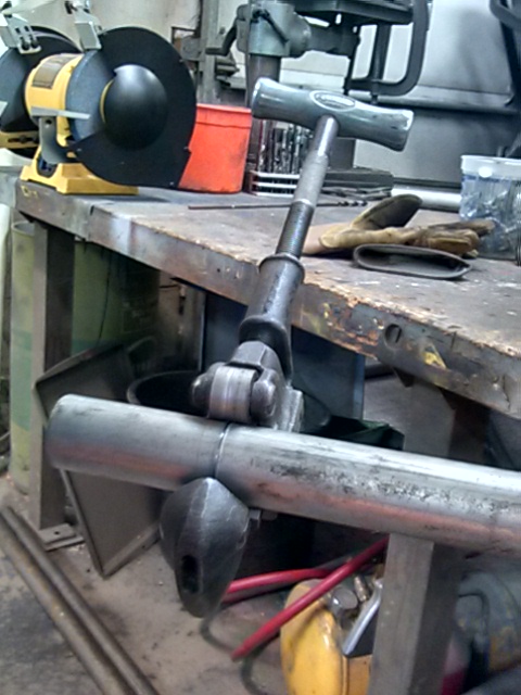

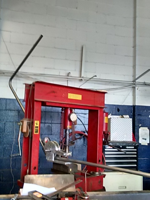

Progress. Got one "top bow" bent up today. Still need to bend another top bow and a front hoop. The tube bender really makes nice bends, thanks for loaning it to me Jeff!!!

« Reply #214 on: March 11, 2016, 08:46:02 PM »
Slowly making headway. Made up another "top bow" today. Replaced the leaking water pump. So many projects, so little time.

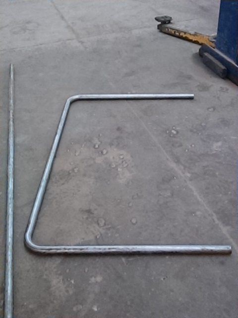

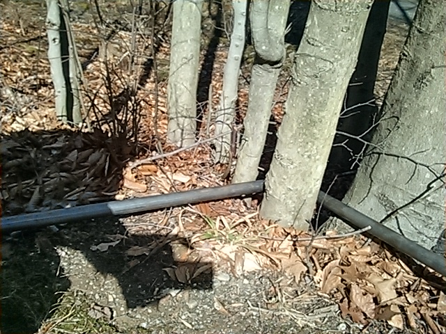

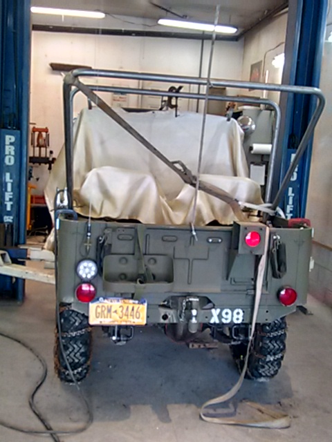

More work on the roll cage today. Made up some angle iron supports for the top of the rear wheelhousings. Trimmed the front top bow to length.
Did a little adjustment on one of the bends with my custom tube bender.
Starting to tack weld things together.
A bit of adjustment on the rear bow.

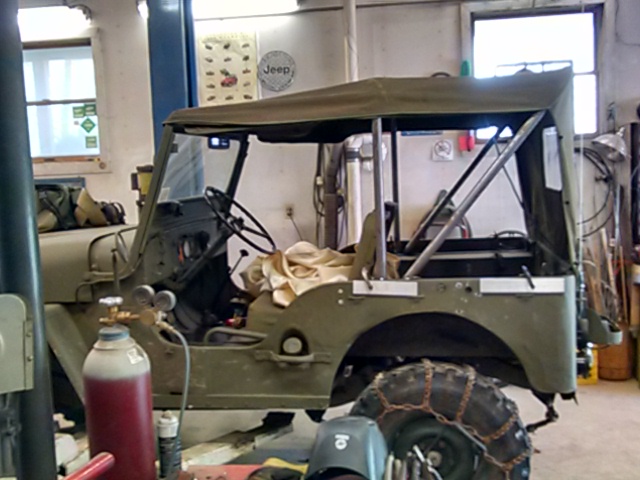

Test fit of the top on the bows. There are still a lot of missing pieces in the cage.

Looks good Bob. So going M606 style, eh?

Custom tube bender! WICKED DECENT!!
The canvas is actually an M-38 enclosure. I wanted something that is (relatively) easy to install and remove. That eliminates original CJ tops!
Very inexpensive too  ;D
« Reply #220 on: March 12, 2016, 09:25:11 PM »
Looking good!  I like how you refer to them as "bows" since that is the idea. How wide are they at the top?
« Reply #221 on: March 13, 2016, 08:11:26 AM »
They are 57" wide at the top and taper in to fit inside the tub rails at the base.

Bob, I'm not sure how they attach to the tub.  I have to assume they are easy-off and easy-on.  Do you have a pic of attachment?  Why not just do an M-38 bracket?
« Reply #224 on: March 15, 2016, 08:41:20 AM »
This is primarily a roll cage to protect the occupants so it is not removable. A secondary feature is that it supports the canvas enclosure without the need for regular top bows. It uses conventional CJ roll bar style angle plates bolted to the top of the wheel house and the body side panels. It's not even close to being done yet, still have to make up a bunch of components and weld them together.
