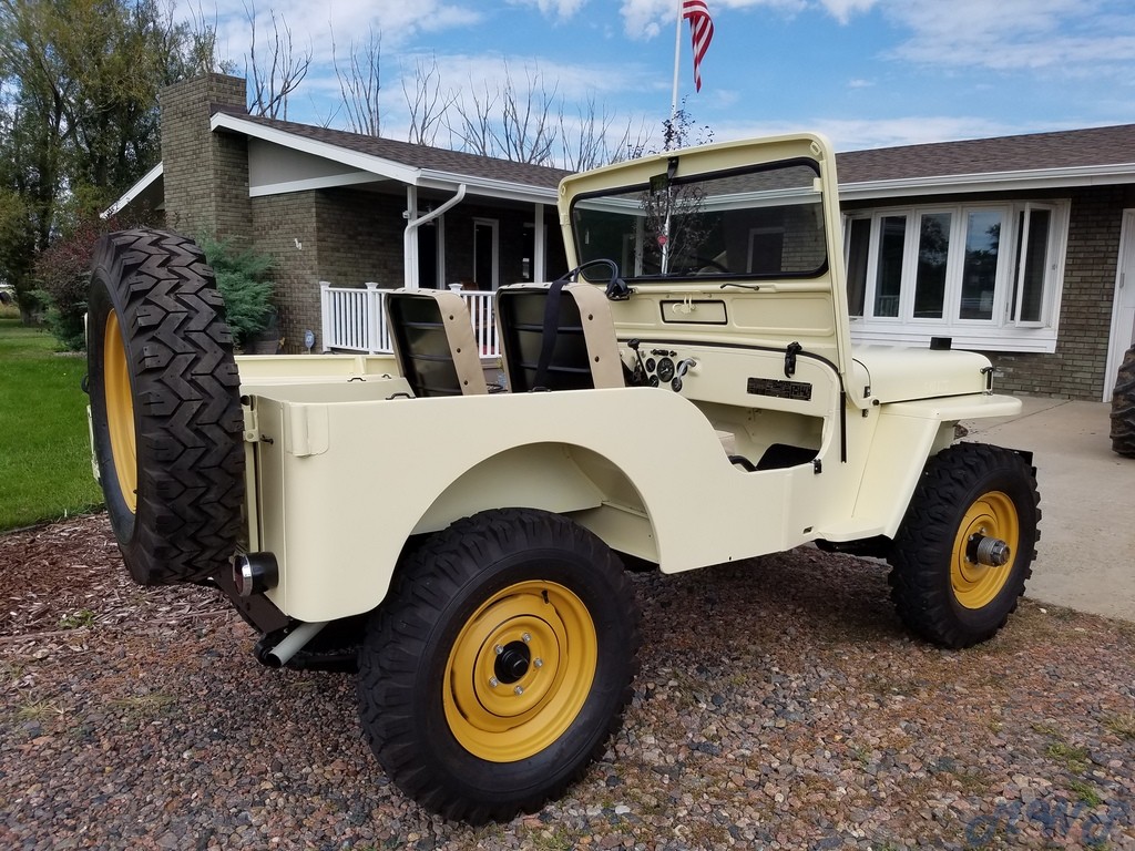

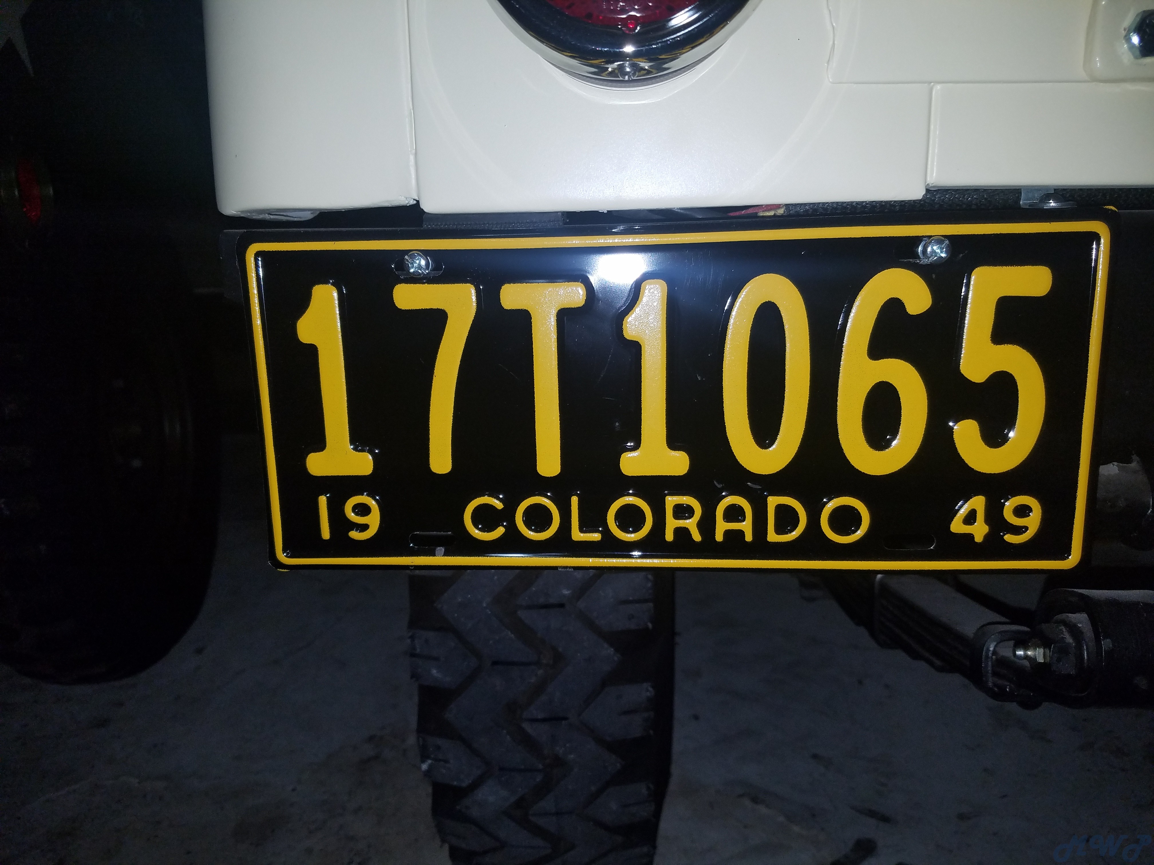

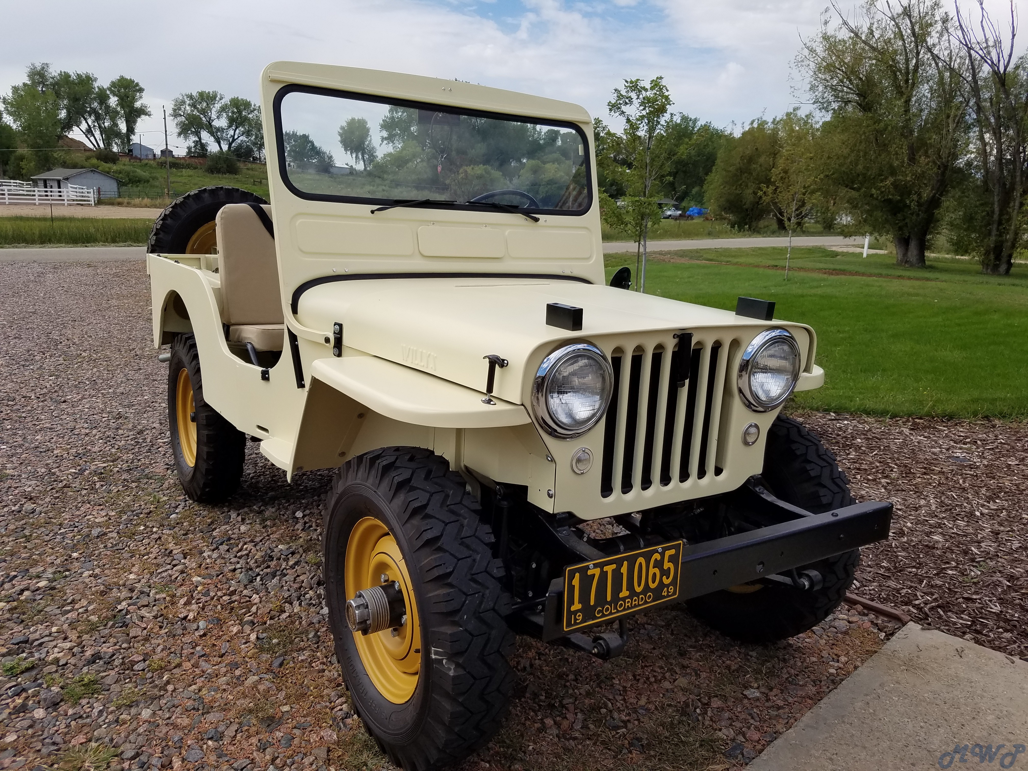

Some more glamour shots�
 The original period correct license plates ended up matching the wheels.
