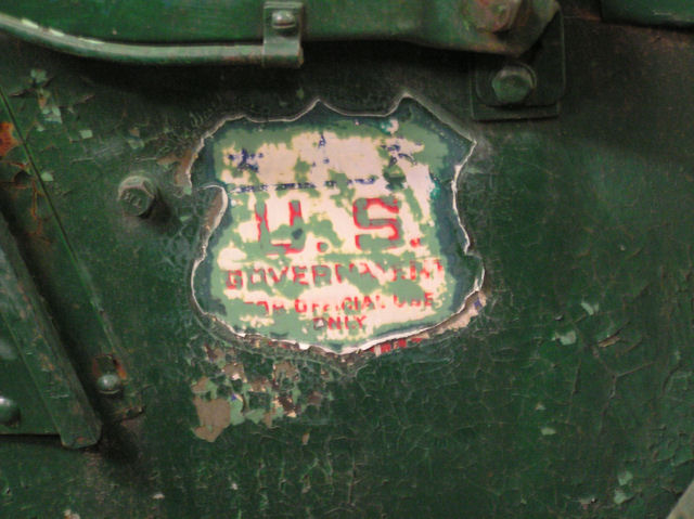

Thanks to Bob W's website, I now know what the logo looks like.
And with help from the 2A page guys, I know how to letter it up.
And it looks like I picked the right green based on these pics:
http://www.flickr.com/photos/53074154@N00/8587099037/in/photostream/
http://www.film.queensu.ca/cj3b/fire/Oregon.html
« Last Edit: January 12, 2014, 09:01:52 AM by garage_gnome »
Re: Building a forest service jeep
« Reply #113 on: January 12, 2014, 09:54:56 AM »
Mine also had that writing below the sticker
Department of Agriculture
� �� �� �� Forest Service
