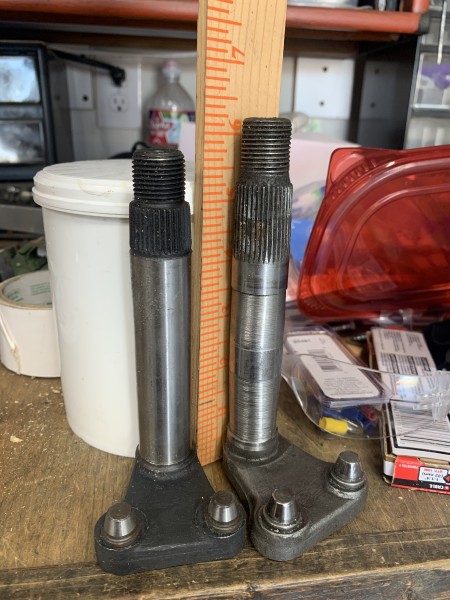

I ran into the same thing (aftermarket parts that don't fit) when rebuilding my steering box.  I ended up finding a NOS steering sector shaft which was the same at the original worn one.  IDK what the old sector fits, maybe CJ2A or 3A?  It is the correct diameter but a little short.
If someone would like it you can have it for free.  I just need $5 for shipping.  Here is a photo.  The new one ON THE LEFT is a bit too short for my M38.

 I'm sorry, you have me a bit confused _ which is "new", which is "old"? The one on the left in the picture is obviously newer than the one on the right, so should be the "new" one. Which one do you want to get rid of? If it's the one on the left, I'll take it. Just tell me where to send the $5.
BW
.PM SENT.   :)
BW
.PM SENT.   :)
$5 sent. BW
