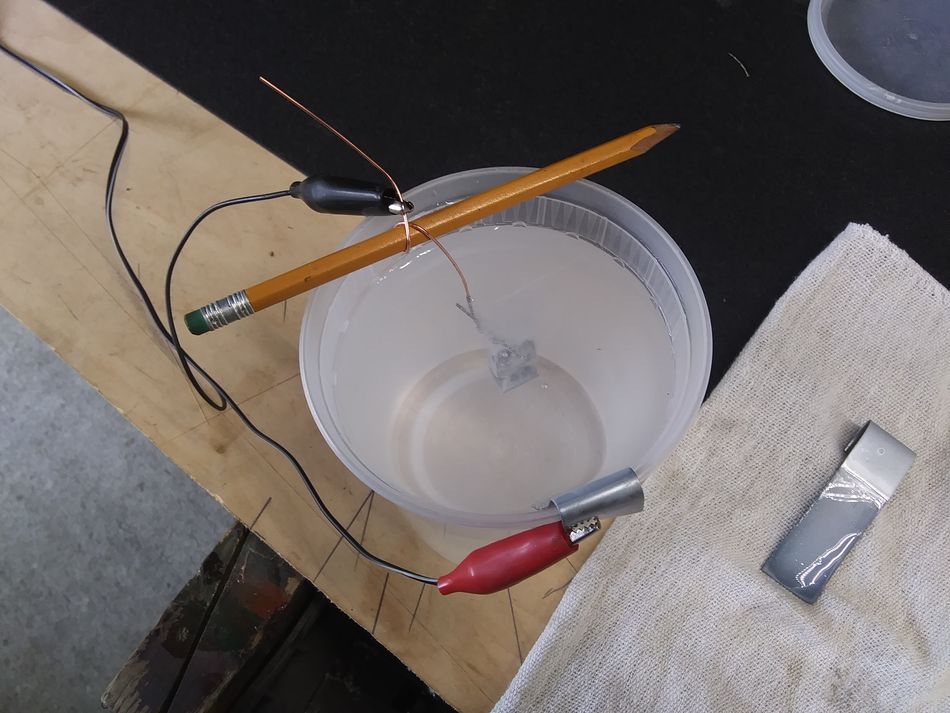

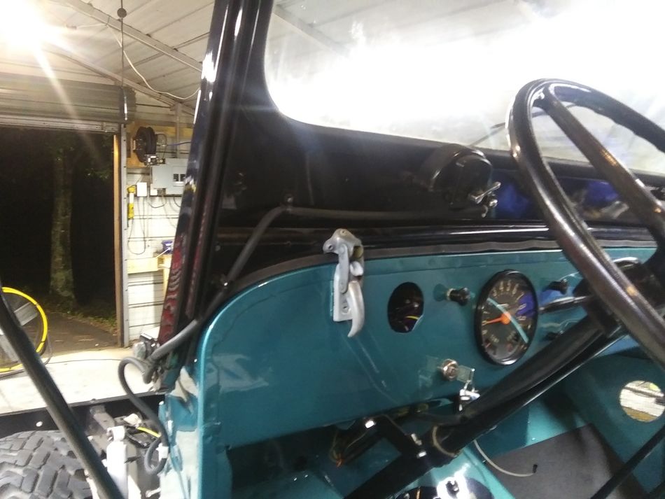

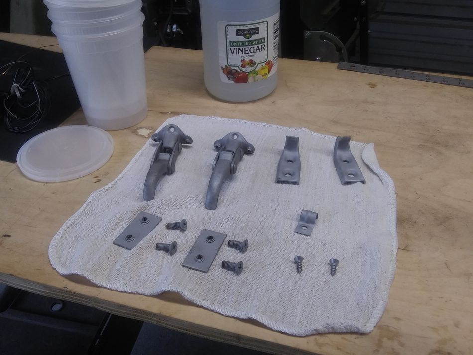

on my 64 3B, the clamps were zinc plated, along with several other items. I used a home-brew zinc plating process and it turned out pretty good. Here are all the parts that I plated:
cleaned, acid etched and ready to zinc plate
the plating process
the finished product:
