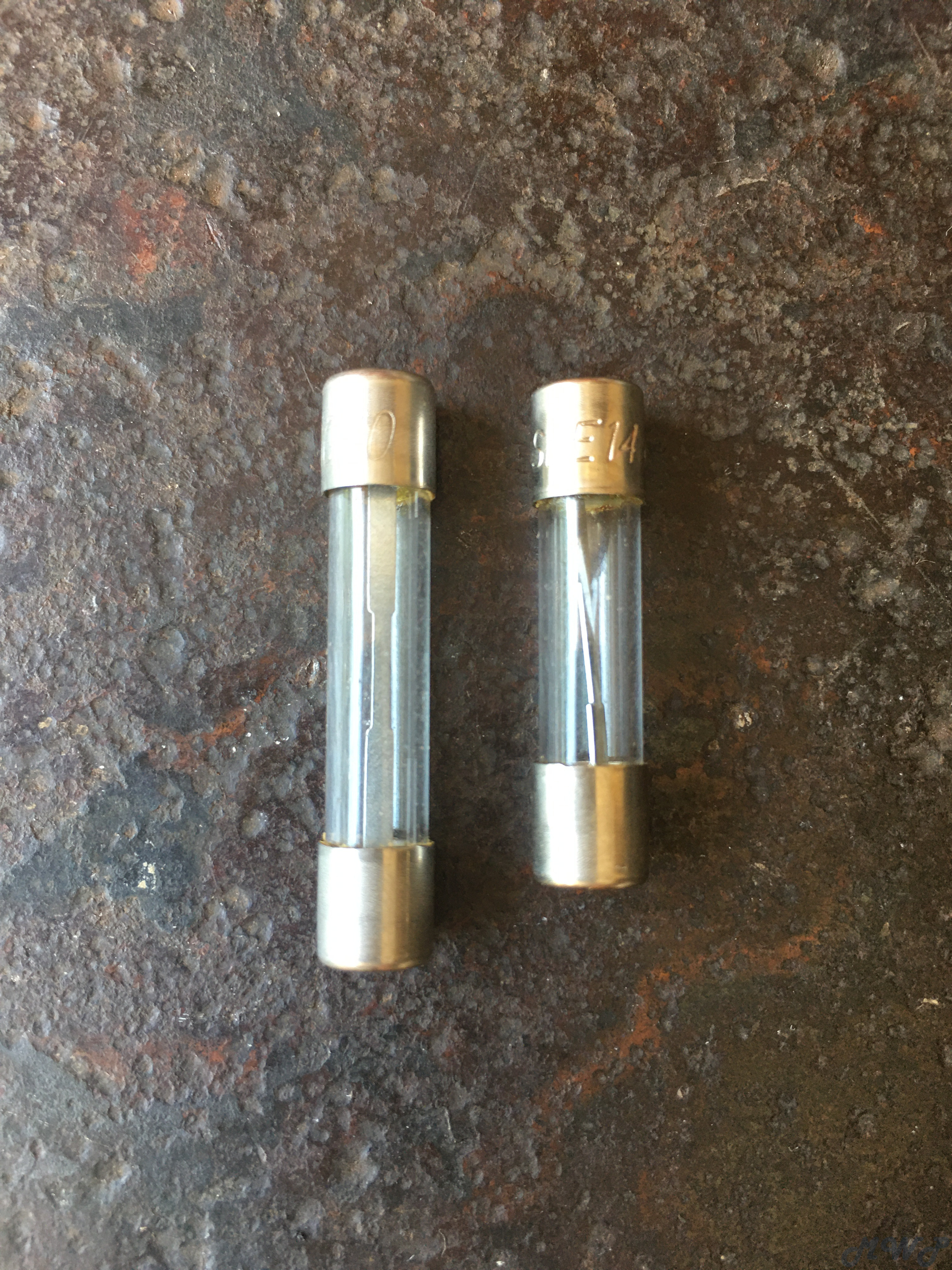

As previously mentioned the technically correct SFE 14 may not fit your application without a proper fuse holder.
In the pic below you can see the physical length difference between an AGC 10 and the SFE 14.
If your set up to use blade fuses then I’ll bet one of the SFE guys would allow you to use a 15 amp blade fuse if you get him snookered at the Vegas convention.

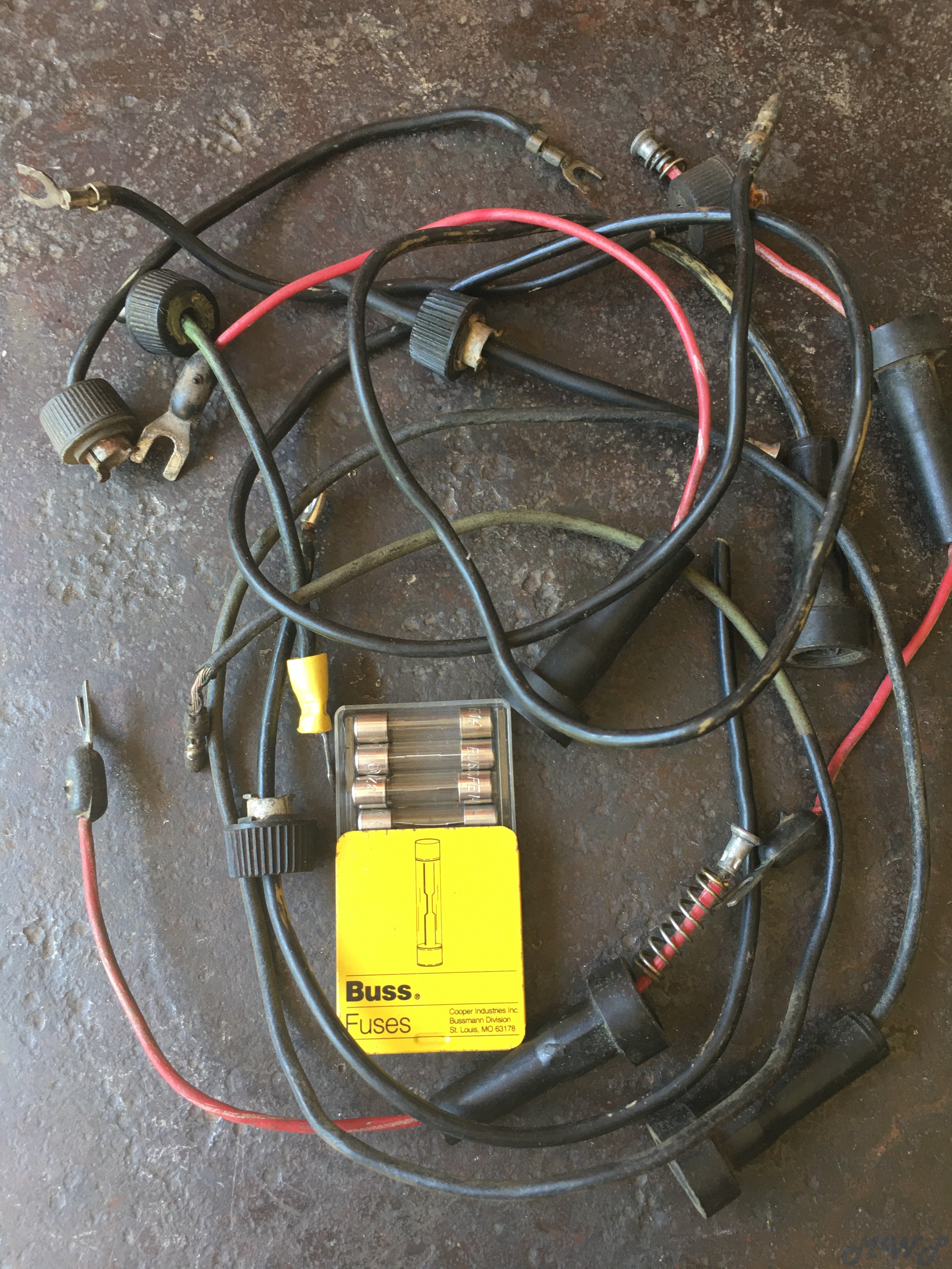

The only two fused electrical components on any of the correctly wired early cj’s is for the signal switch and the heater controls. These both connect via automotive fuse holder to the ignition switch “acc” terminal.
Here you see some original fuse holders along with a quantity of Buss brand fuses.
