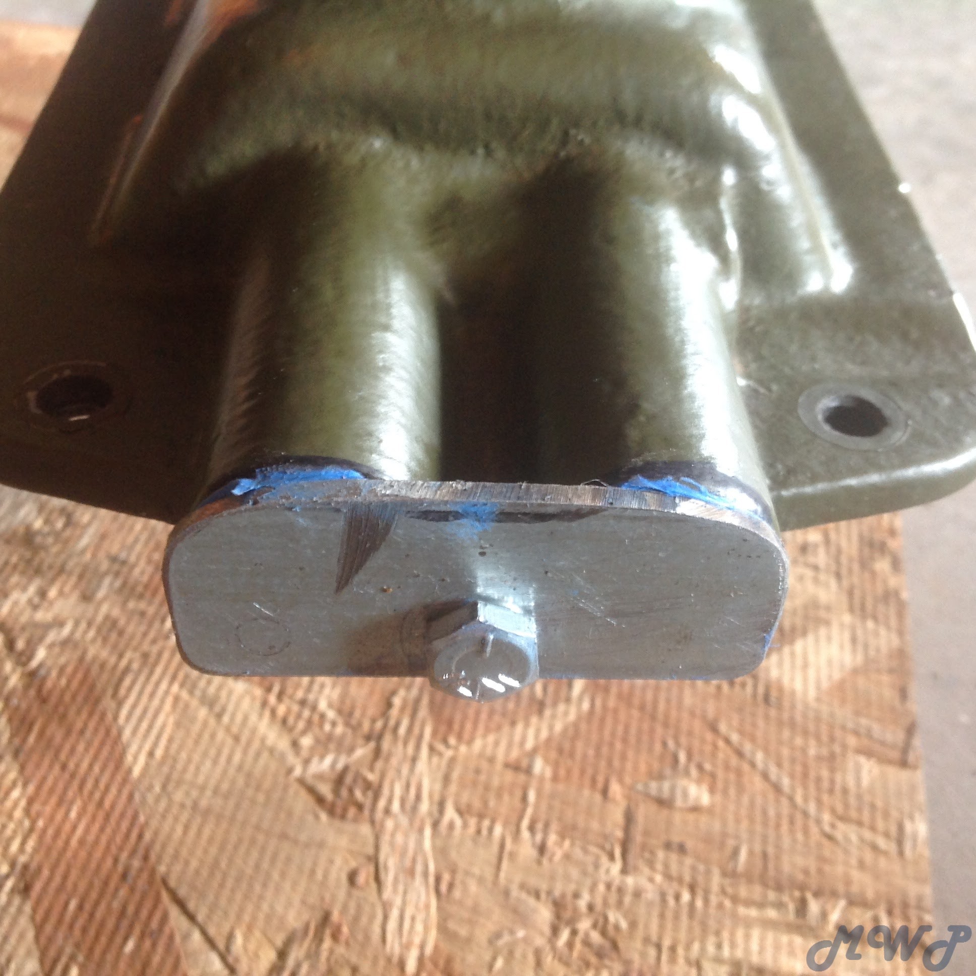

3.      Take my approach seen below�.

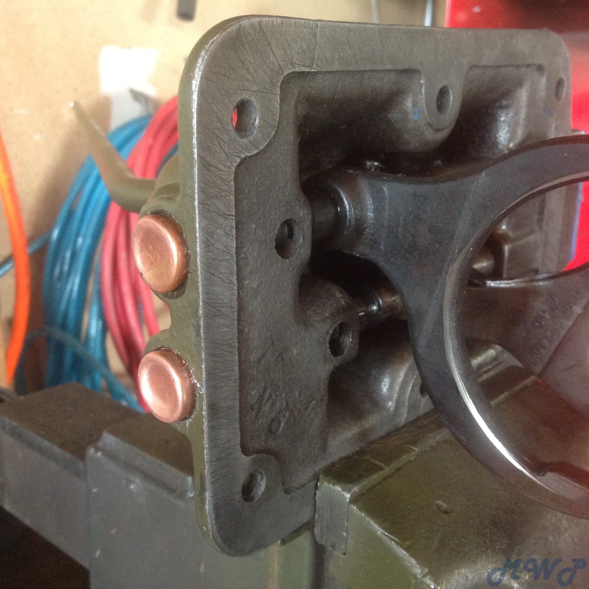

This is a little mini-project I did a few years back when I installed a sealed bearing on the front of the T-90.� I wanted to seal both the front and rear.� For the front, I went down to my local hardware store and purchased 2- ��� (maybe 1/2") copper pipe caps.� I trimmed their length a bit.� I cleaned the port, added some sealant and drove them in with a hammer.
For the rear, I made a small plate.� I drilled and tapped a �� mounting hole at the rear of the tower, in between the shift rails. I smoothed the T-90 surface with a grinder. I also had to grind down one of the rails that protruded beyond the tower edge while in the rear position.� I can�t remember which, but it will be obvious if you try this.� I added some sealant and screwed the rear cap to the tower.� Some recommend that you should put a groove in the rails or case so oil can flow back, but I didn�t do this.� My ports were probably sloppy like yours.� The oil has enough room to flow back inward.� The result�no leaks from my shift tower, even after a few years have passed.� It�s an easy project.�
